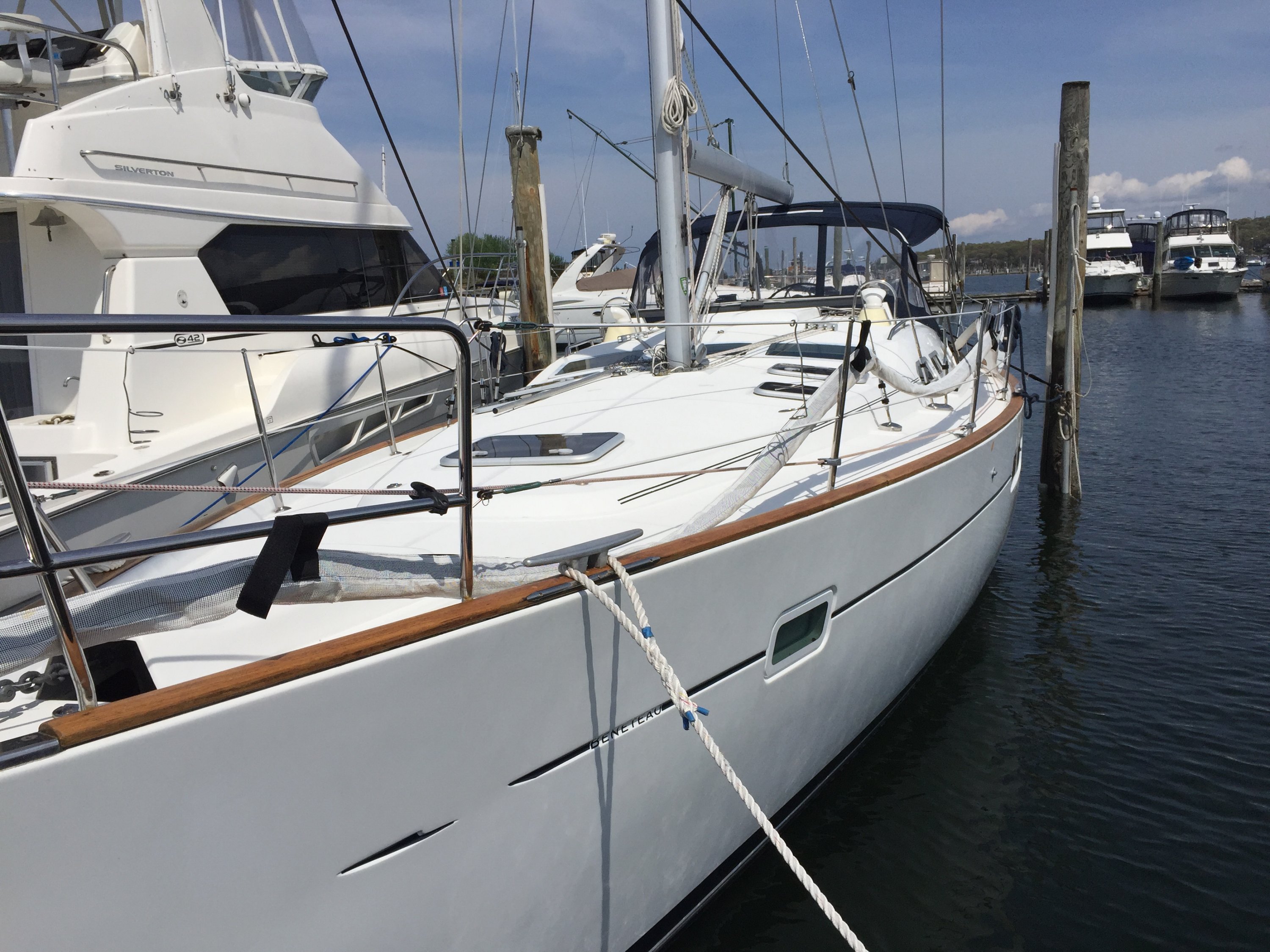

My wife used Peitte Sea Gold this season..... stripped all the old garbage and so far so good. She put 5 coats on I believe
