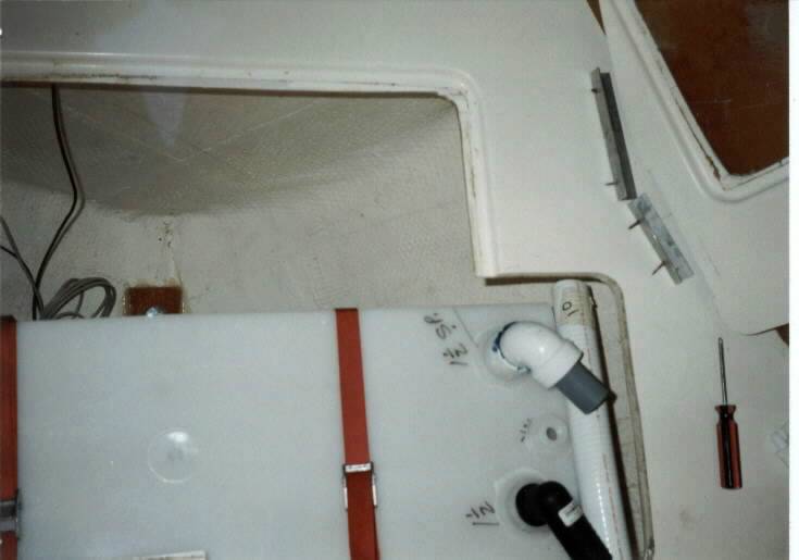

I put a 22 gal Ronco in the v-berth locker with less than four inch clearance. And you are right, to get the capacity in our two water tanks we currently have about an inch of clearance. Thanks to connections all coming off the ends.

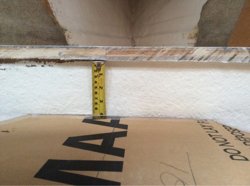

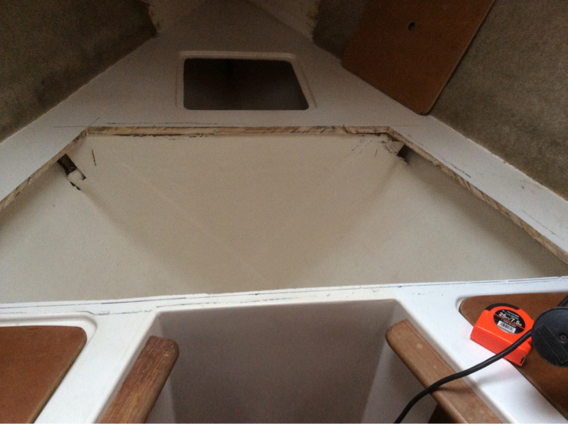

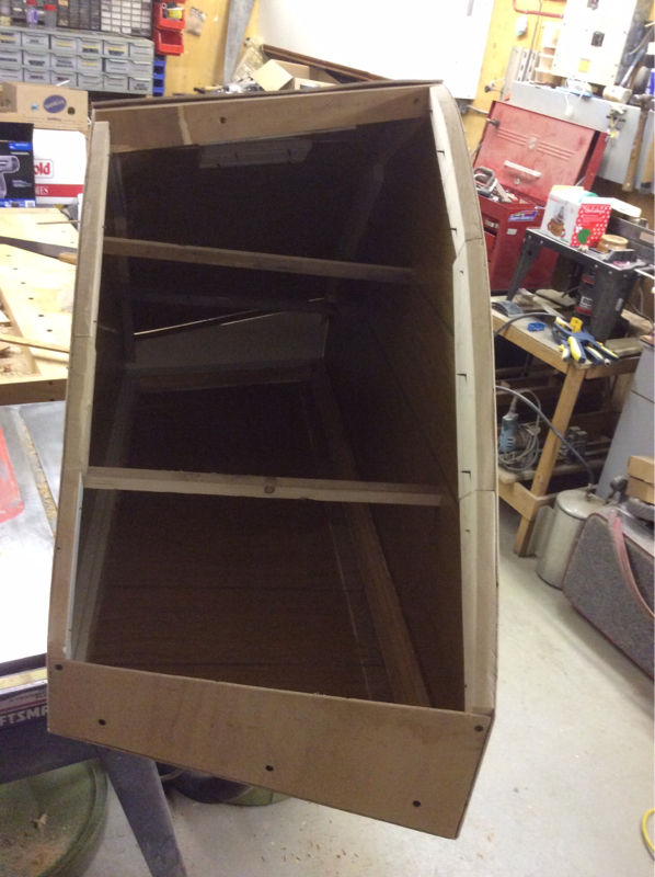

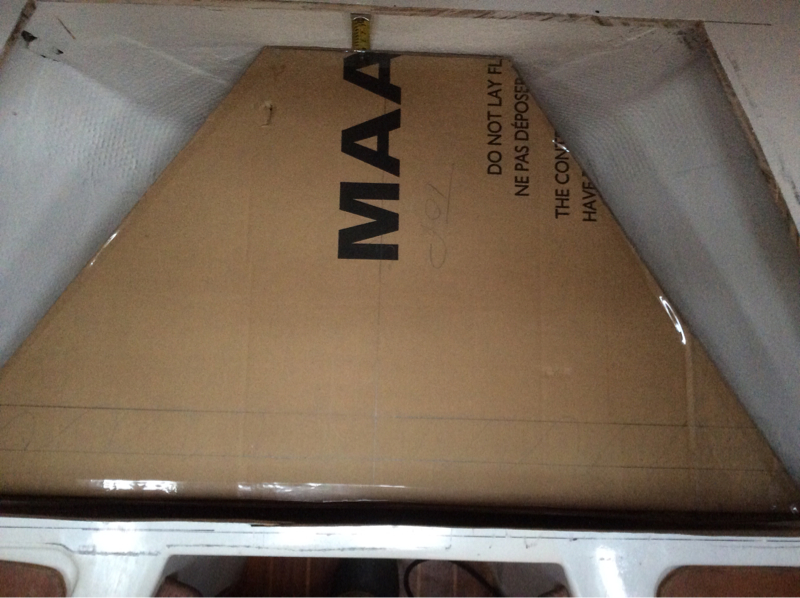

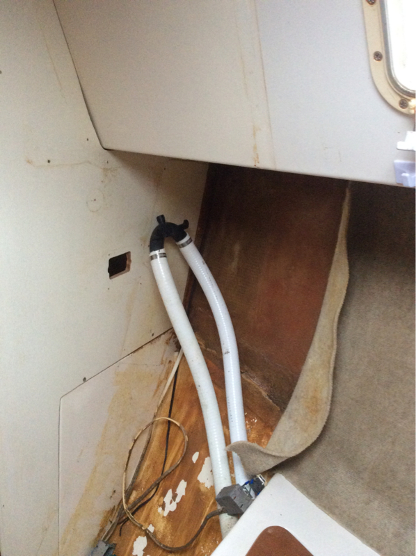

I cut the top off the storage compartment in the v-berth. I have 4" from the top of my mock up tank to the bottom of the v-berth top that I cut out. Peggy Hall figures I will need 5 inches clearance to attach the necessary fittings to the tank. Looking at the picture you provided it is hard to judge the clearance you achieved. Do you remember what the clearance is?
Photo 1 Bulkhead removed - v- berth / hanging locker to get tank in to v-berth
Photo 2 Top cut off storage area
Photo 3 Tank mockup in place
Photo 4 Clearance of 4 inches

It's important that you have enough clearance above the fittings to make sure that downward pressure on the berth, settee or whatever is above the tank won't put downward pressure on any fittings. That can crack a female tank fitting.

Yes. Thanks for the advice. Fortunately the "deck" of the v-berth in fairly stiff and there doesn't seem to be much deflection. Before I order a new tank I want to make sure everything will work.

Yes, I mentioned that in my original post. I have four inches between top of tank and underside of v-berth. You can see in the picture that the elbows don't sit very high. And you are correct, there is no deflection.

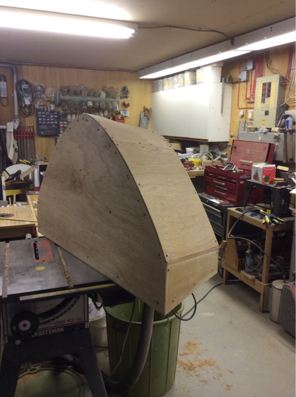

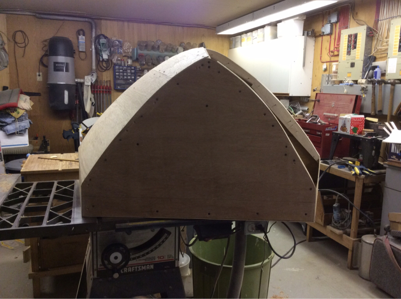

Hi All
I'd like to update you on my tank project. I have decided to build a custom fiberglass holding tank. I built a plug using thin plywood. I want to fiberglass the plug then cut the top off and add more fiberglass to the inside to a thickness of about 0.5 inches, coat the inside to make a smooth surface and then put the top back on.
The surface of the plug is not smooth so can I cover the plug with polyethylene sheet ( 6 mil plastic) to act as a release?

1,099
I would doubt that you can get a smooth surface with poly vapour barrier - you will have folds and they will not lie flat. Why not just make your thin plywood plug the 'core' of a glass sandwich tank? There are many different approaches; with a bit of sweat equity they will all get you a holding tank. I assume you have read this article in Good Old Boat?

Peggie, Jim, JCII & Ed
Thanks you for your advise and comments.
Peggie, I agree that a plastic tank would be the easier choice. I have studied the Ronco and Raritan catalogues and built several tanks using cardboard but the best fit and the biggest tank I could get was with the Ronco B445 but it barely gives me 4 inches clearance for the fittings.

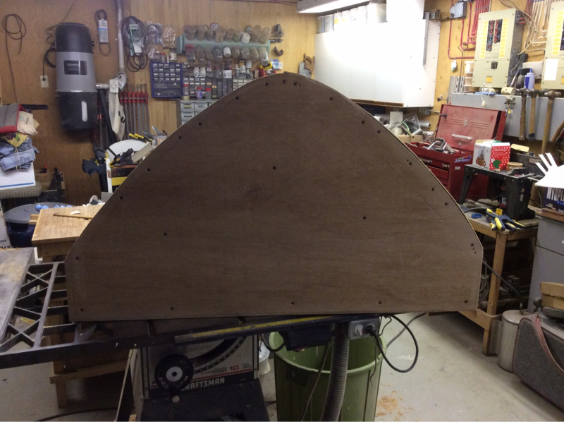

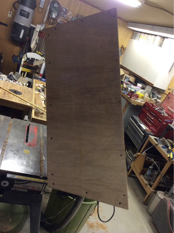

Jim, I have added pictures of the plug that I have built, it fits the shape of the hull. While I like the idea of using the plug as part of the tank the cleats that hold the plug together pose a problem( see pictures). I did read the article in Good Old Boat about using drywall as the plug but you can see from the pictures that the curves would be very challenging. I think I can get a reasonably smooth finish to the inside of the tank as I will have to add another 1/4 inch of fibreglass to the inside to ensure no problems with leakage and get a smooth finish for easy cleaning.
JCII, my plan is to build the tank in my shop an then install it in the boat as if it was a plastic tank. You are right about the price of a plastic tank and I would pay it if I could get the right one.
If I am heading into trouble with my approach please let me know as I do respect your experience and appreciate your advise.
Photo 1 Plug upside down
2 Aft
3 Forward
4 Inside
5 Top
1,099
Nice plug. (Nice shop too...) What about touching up the plug with autobody filler, then just rolling a couple of coats of cheap polyester resin on the the plug, and several coats of wax? I assume you are going to cut the tank in half after it is constructed, remove the plug and then glass it all back together? (or better yet, make a female mold and start producing tanks for sale to the rest of us! :)

Jim
Auto-body filler and polyester is not a bad idea to seal the plug. I think I'll try it. As for making the mold and producing tanks let's see how this one turns out first. I'm glad the camera. doesn't pick up the mess of my shop but thanks for the compliment. I'll keep you posted on the progress of the plug.
