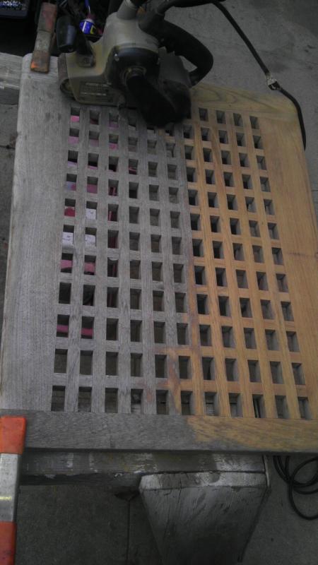

I'm not sure what you mean by wash boards, but I varnished the teak cockpit floor grate by spraying it on. I tried brushing it at first but getting in each of the holes was a pain so I thinned it out and sprayed it, much easier.

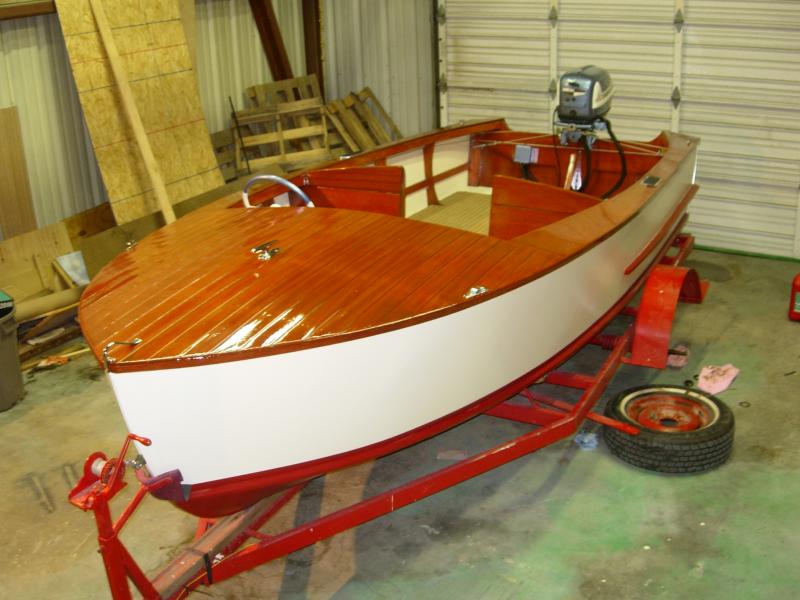

That respectful formality out of the way, I will tell you from having totally varnished several wood boats, unless you are spraying and need thinner or reducer to get the goop out of a gun there is no logical benefit in thinning subsequent coats unless you have masochistic tendencies and really just enjoy spending days upon days and weeks upon weeks refinishing brightwork.
Thinned varnish runs easily, does not brush as well, does not apply in sufficient thickness to get any build, the list goes on... It does wipe on when sufficiently thinned, and as a wiping finish thinned varnish works very well for craft projects! But that method will take a long time to get a decent build on an exterior boat part.
There are books out there on finishing and none have my name on them. It is uderstandable that you would not just dive off blindly and follow my advice, so let these images of two boats and other various parts I have restored stand in as my expert witnesss.. :D
Thinner is not necessary for build coats, unless you want to prolong your work....
As an aside, don't fall into that trap of thinking you need to sand between every coat either. When in a build schedule, there is enough solvent left in previous coat that a top coat will soften it and create a chemical bond. The purpose of sanding during a refinishing job is to smooth your finish out and remove high spots. Don't sand for a mechanical bond unless you have had a long period of time elapse between coats.
Trying to help speed the job up for you guys. Trying to make it easy, because if the job becomes an easy one, as it is, folks will not be as hesitant about maintaining brightwork....

Hey Phil - Nice photos. You do good work. Unfortunately, we are not allowed to spray in the marina. Even in the boatyard we can't spray unless our area is tented and the we are bonded; too much danger of overspray onto other boats.

Just in case I somehow inferred it, I have never sprayed varnish. Everything you see of my work above is brush. Just FYI
