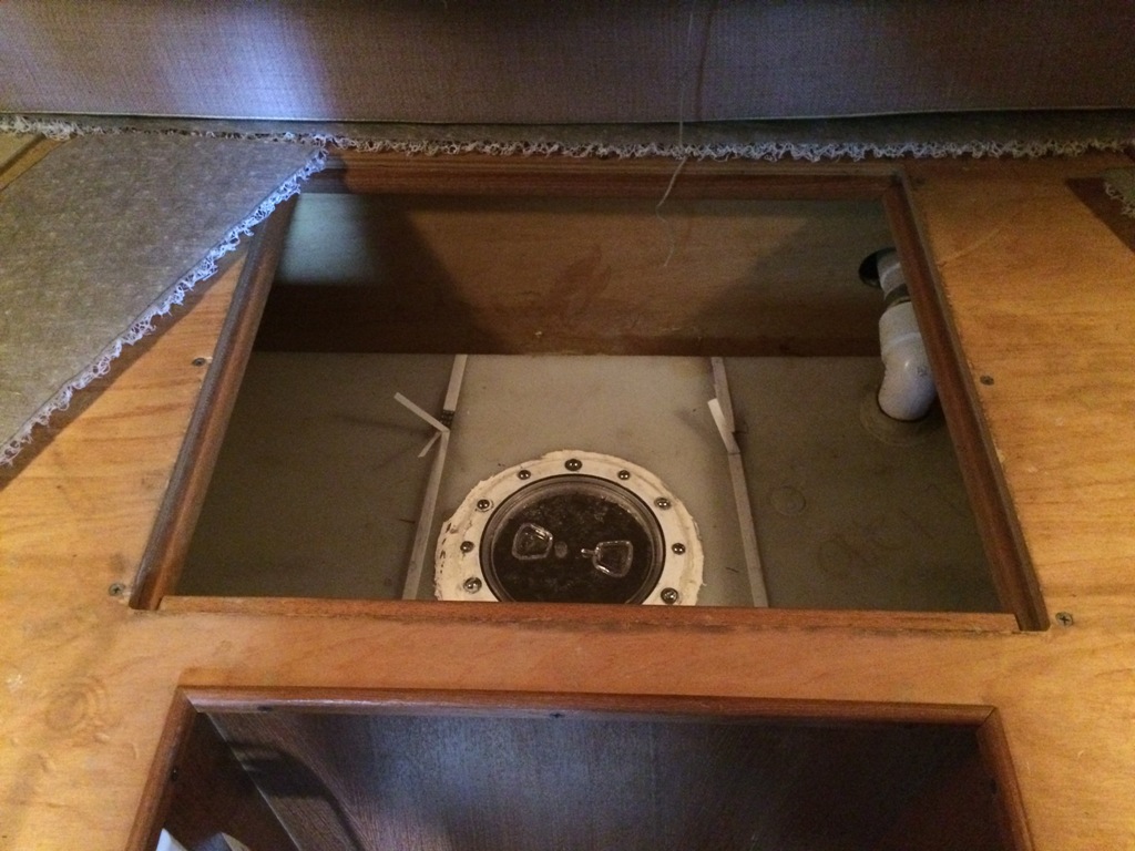

I suspect someone did that with our water tank. In our case there was no doubler inside. I highly recommend installing one to stiffen up the top of the tank around the flange.
Here is a pic before I took it apart to stop the leak between the flange and the tank.
