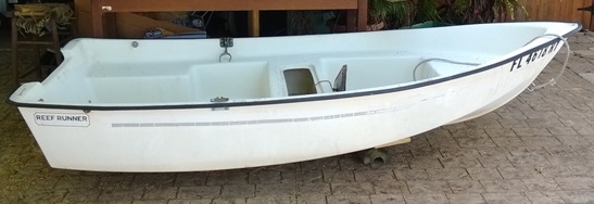

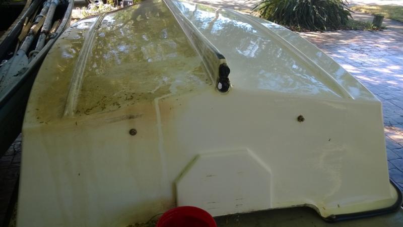

Picked up a pretty dirty (stained), but in great shape, dinghy last weekend.
Yesterday I finished removing the 32 year old striping and glue and gave her a scrub with "wood bleach".
Mixed a heaping table spoon in a quart of hot (tap) water and applied with green 3m pad, scrubbing the real bad spots a little and doing one side at a time, 2 applications and about 10 minutes of "soak" per application.
No sweat and both sides took about an hour working casually. Rinsed thoroughly afterwards.
In the pic, a little trail of clean where the mix slopped over the skeg.

nice looking dinghy you have there form the looks of the motor mount area it has not been used much under power....what kind if dinghy is it and how big if i may ask......you can come clean my deck anytime ;) you are ready

No problem as long as you buy the beer Woody!
It's a "Reef Runner", 1980 version and 9'. The guy I bought it from had bought it from his neighbor that had sold these out of his shop.
I'll bottom paint and polish the topsides and then take it for a ride.

i got beer in the cooler as i type.....i like that boat ...sorta paralles the pippin or puffin not sure of the name..... that Rodger Long uses.......

Really like the boat, how does it tow? Did it come with oarlocks?

Thanks Steve and Joe.
Haven't had in the water yet. Wanted to clean it up and bottom paint before I do and this work thing has gotten in the way of good productive boat fun.
The oarlocks are WC fold down bronze, also included a set of 6' oars and an old 3.3 Merc.
