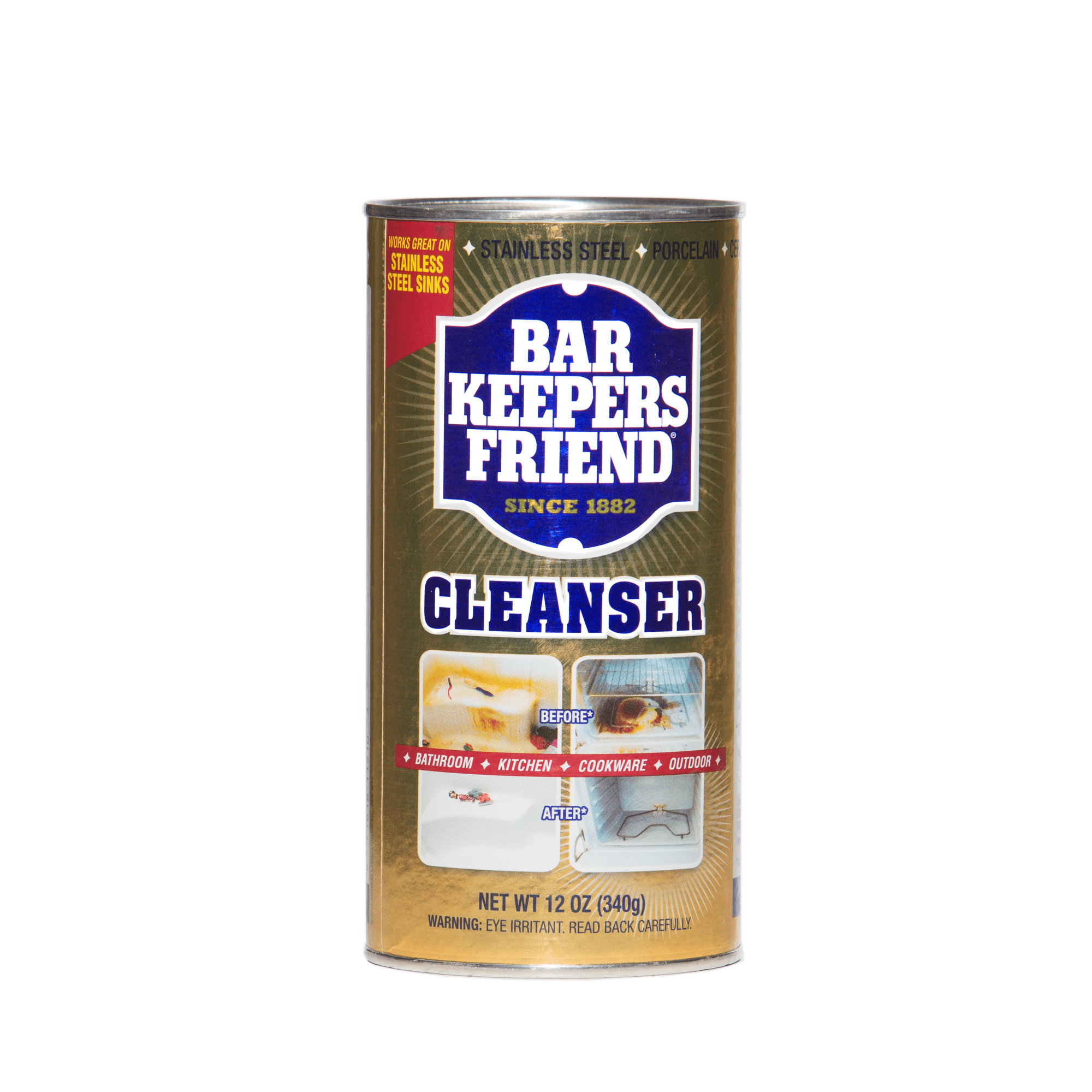

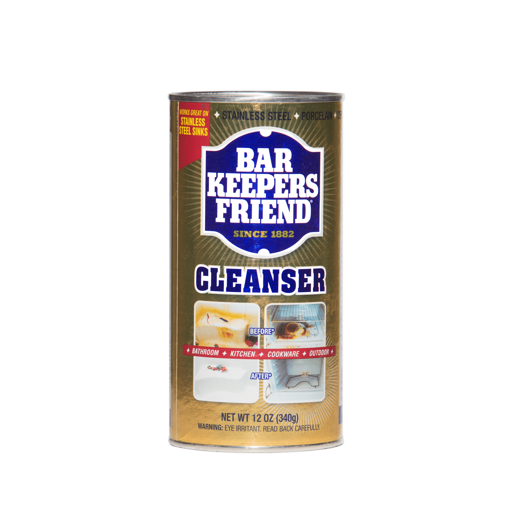

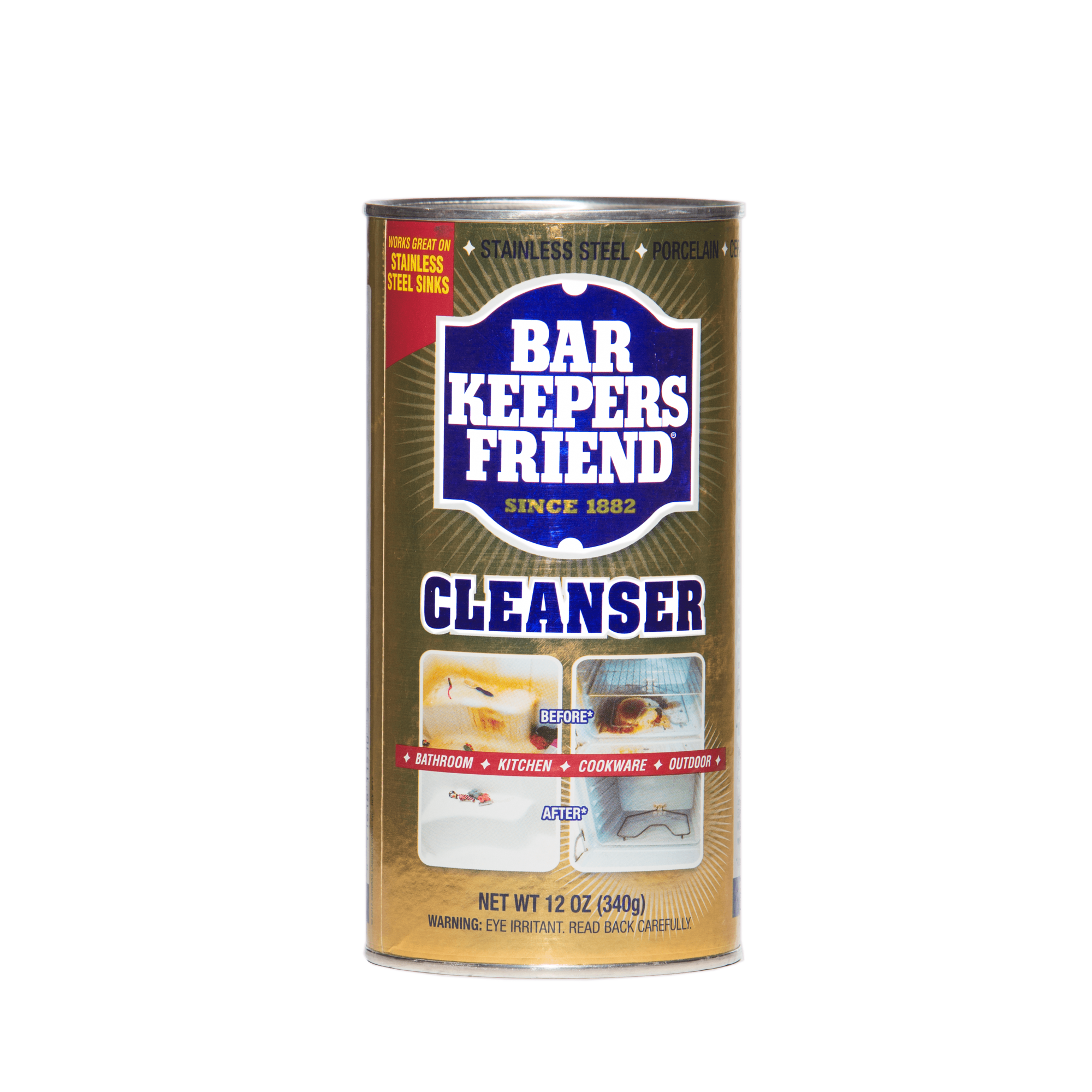

bar keepers friend works great about $3 at most supper markets and significantly less then marrykate on off hull cleaner

Bar Keepers Friend, Home
or OXALIC ACID 99.6% 2 Lb. Deck, Crystals, Metal Cleaning- Rust Removal from Amazon
But it is very abrasive.
I use it on my deck non-skid, and it cleans tough stains and whitens the decks.
But I wouldn’t use it flat gel coat.
If you are cleaning below the waterline, it should be ok.
Last spring, I used some Soft Scrub on the gel coat at the waterline pretty successfully.
