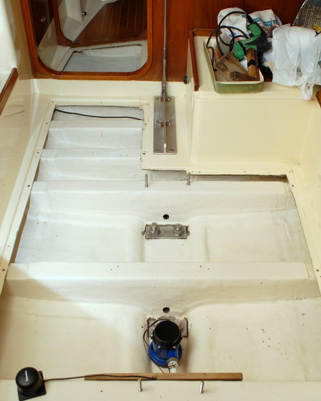

I do it the hard way... Remove everything I can, then use any and every cleaner I can to get it spotless. This is the original gelcoat at 29 years old after cleaning with lots of chemicals including but not limited to Magic Erasers, Acetone, Mineral Spirits, oxalic acid (for rust stains) and general purpose de-greaser products .

Aren't those flat bilges fun? The guys with deep ones hate 'em 'cuz they can't get to the bottom. Those of use with flat ones curse 'em 'cuz with any water in them, when the boat heels the water sloshes you know where. Ah well, boats are compromises, right?
