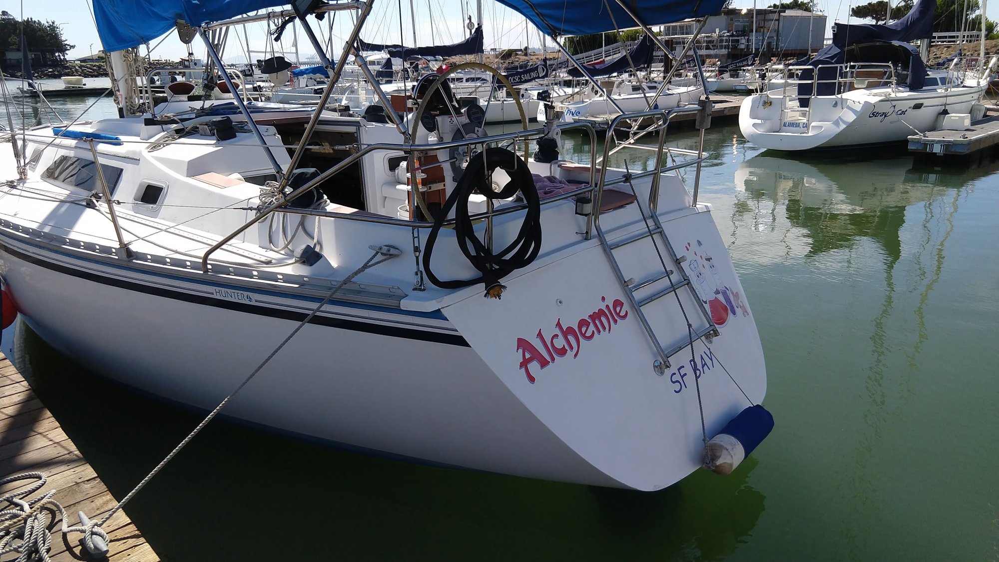

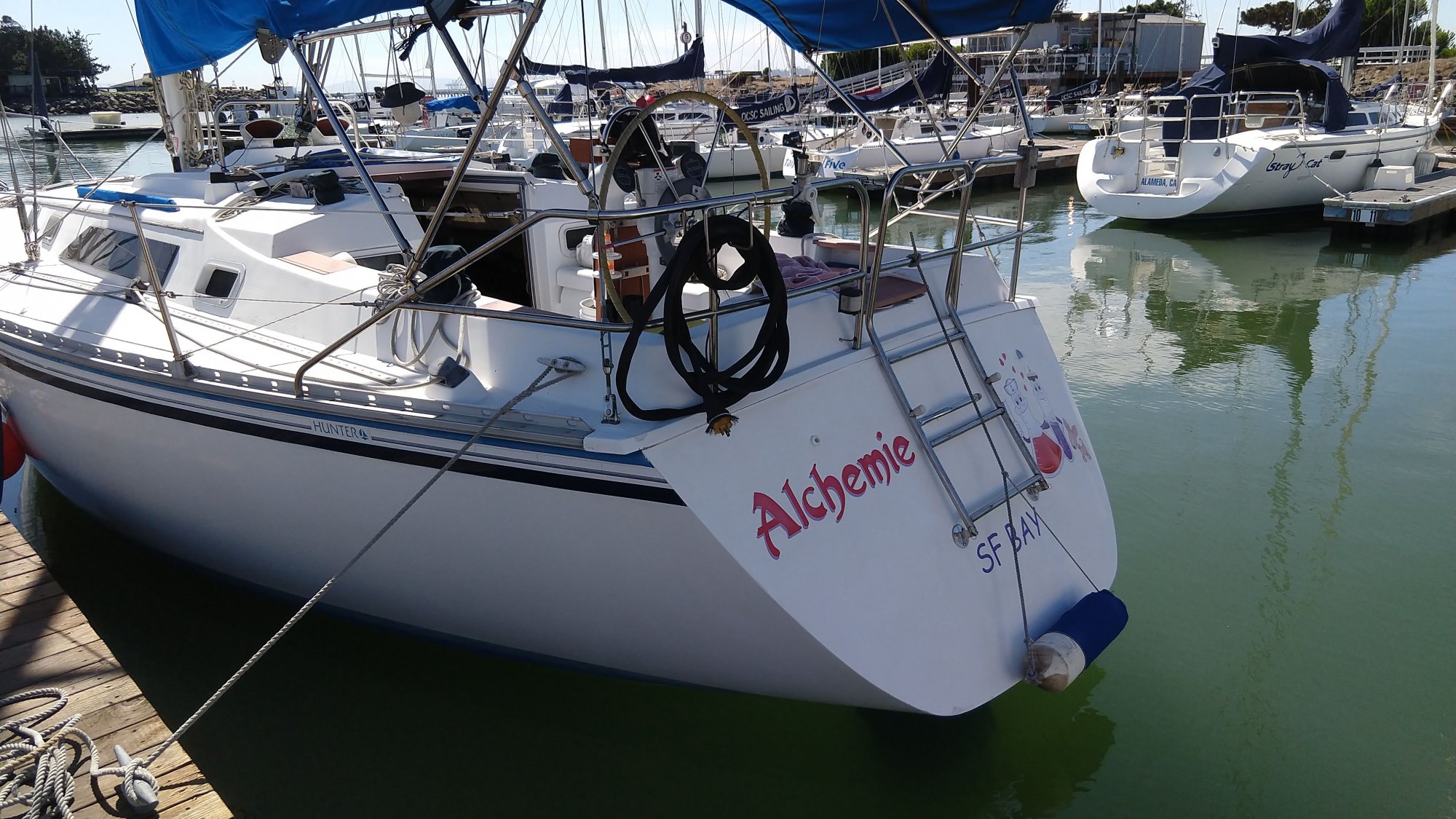

Way back when we first bought our boat, Hubbell ran an ad for a braided cord cover. It could be compressed and made large enough to fit the big cord end into it. It was just a matter of milking the entire cord into the cover. Then the ends were taped or zip tied to keep it in place. You could also include a phone cord, cable hookup. I said it was a long time ago. No more sticky plasticizer on the deck. It lasted over 30 years. The nice thing was that it was removable if need be. It did come in a 50' length. A few years later when we bought a 25' cord I found that Hubbell quit making it. However an Amazon search yielded a black version that worked equally well. Here's the link:
It does stiffen the cord somewhat so you might have to roll the cord for storage.
I've attached the instructions for my first cover. Sorry, no brochure. The photo shows my 25' cord with cover on the stern.

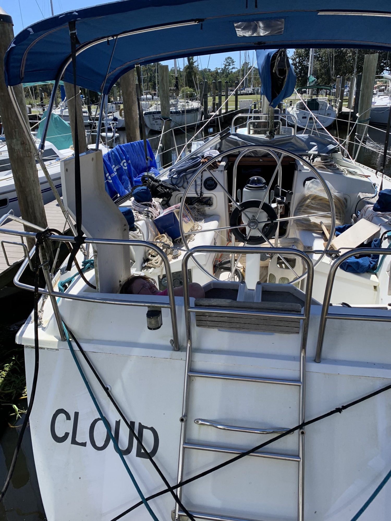

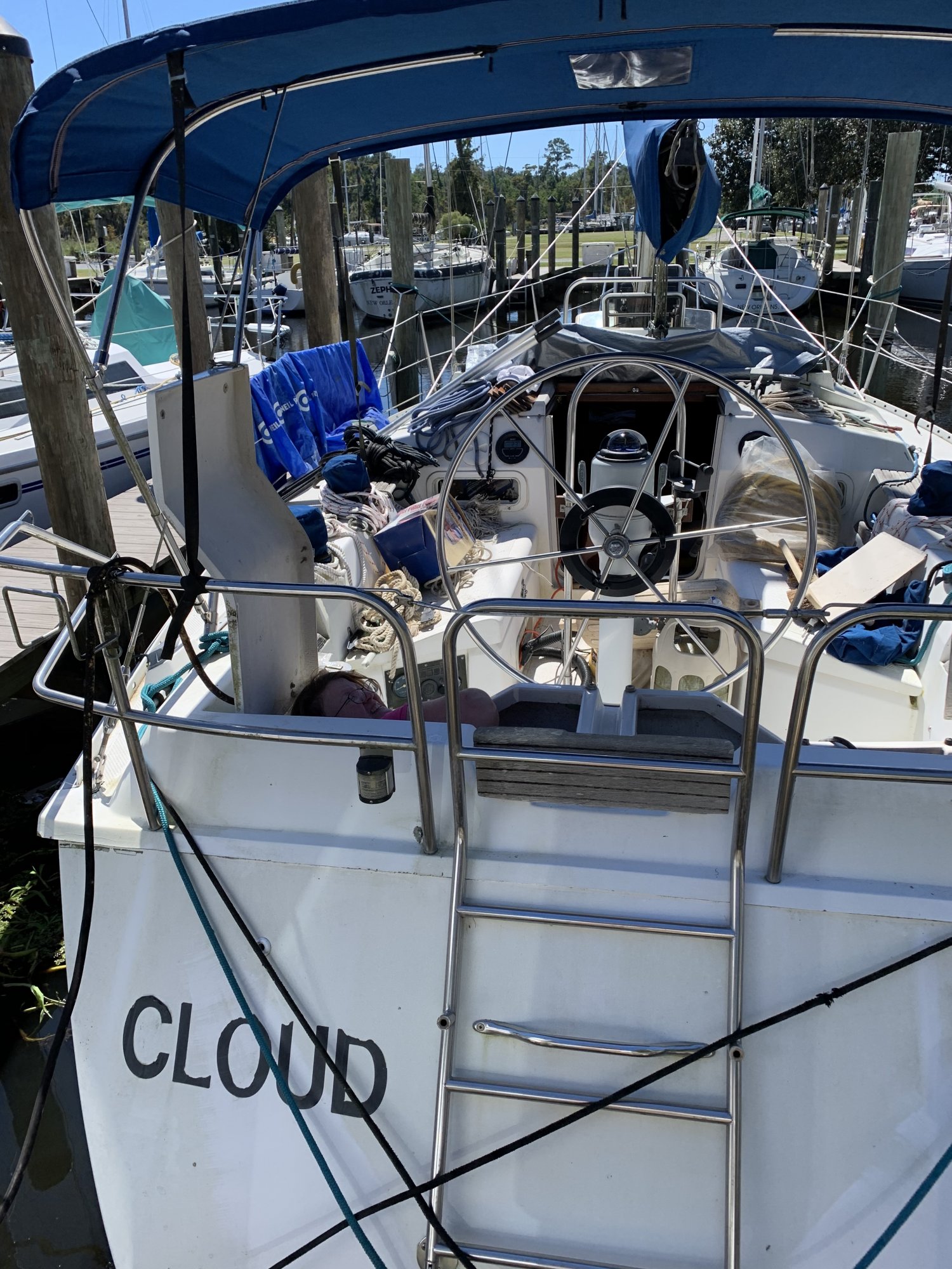

10,221
So, mine is not gooey after many years in the Louisiana sun.. but it is quite black. It is the black cord on the left side.. My docck lines are black so everything matches.. ;) .. The bue lines are "storm" lines that double up the normal lines for nasty weather.
Yes, that is my wife in the lazarette ..

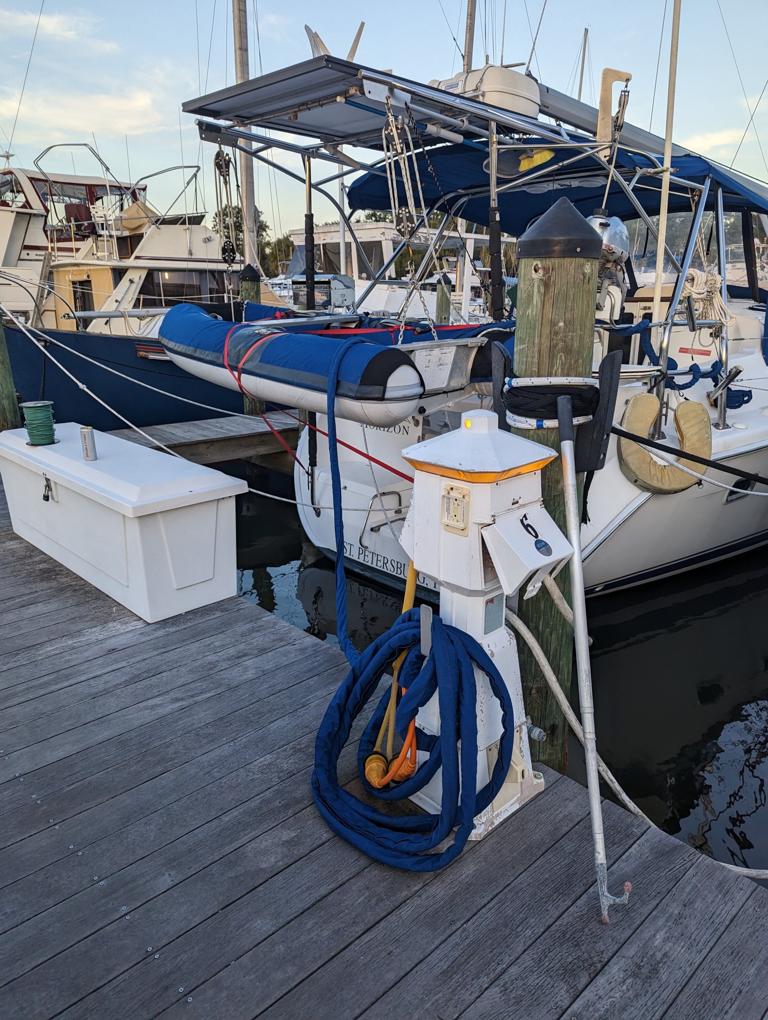

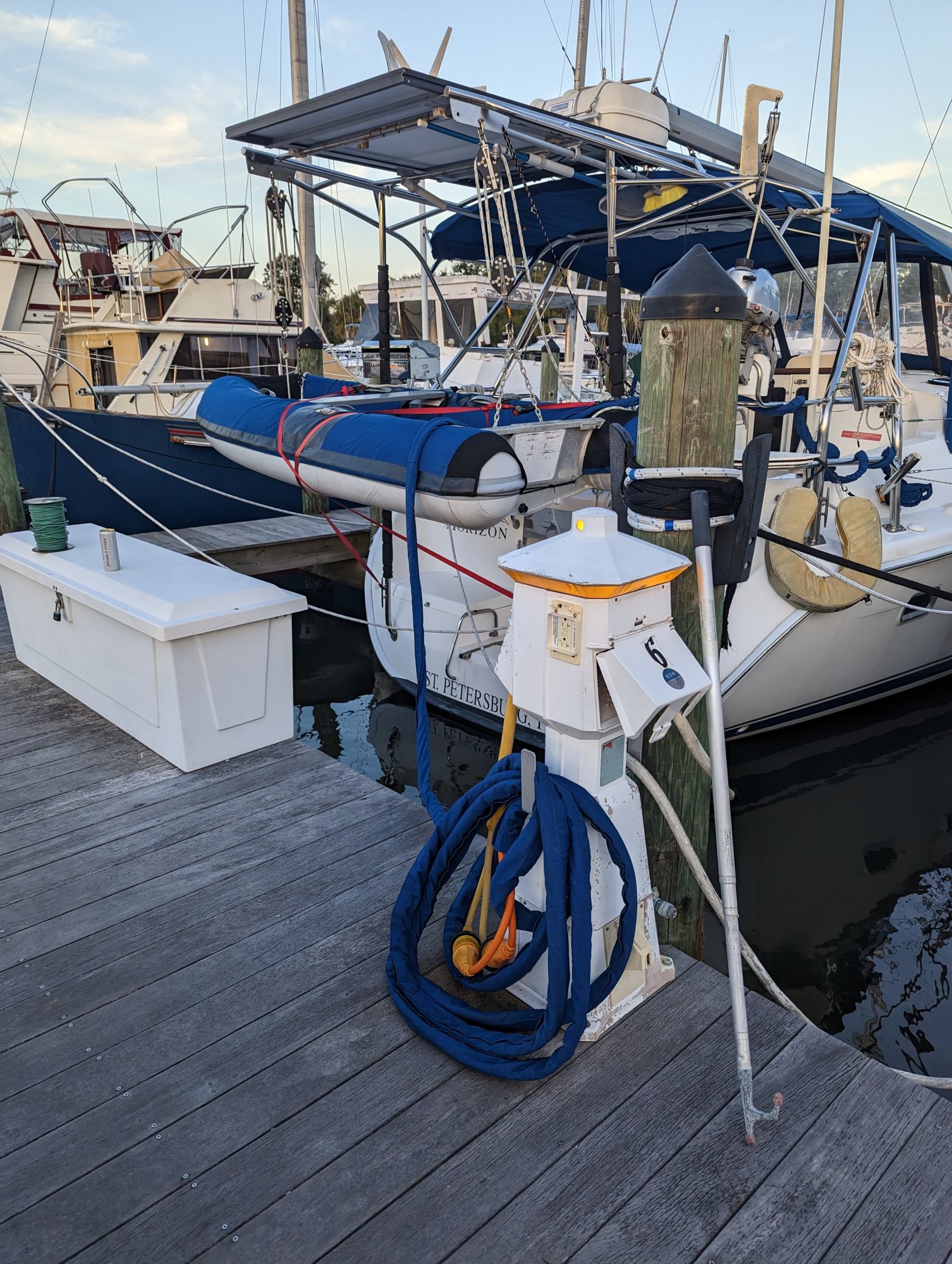

The Admiral made our cord cover and dinghy chaps. There are nice plug covers on the boat side as well. She still has to make the plug covers for the shore side. 50' Velcro strip, and Sunbrella, covers our Smart Plug set up quite nicely.
