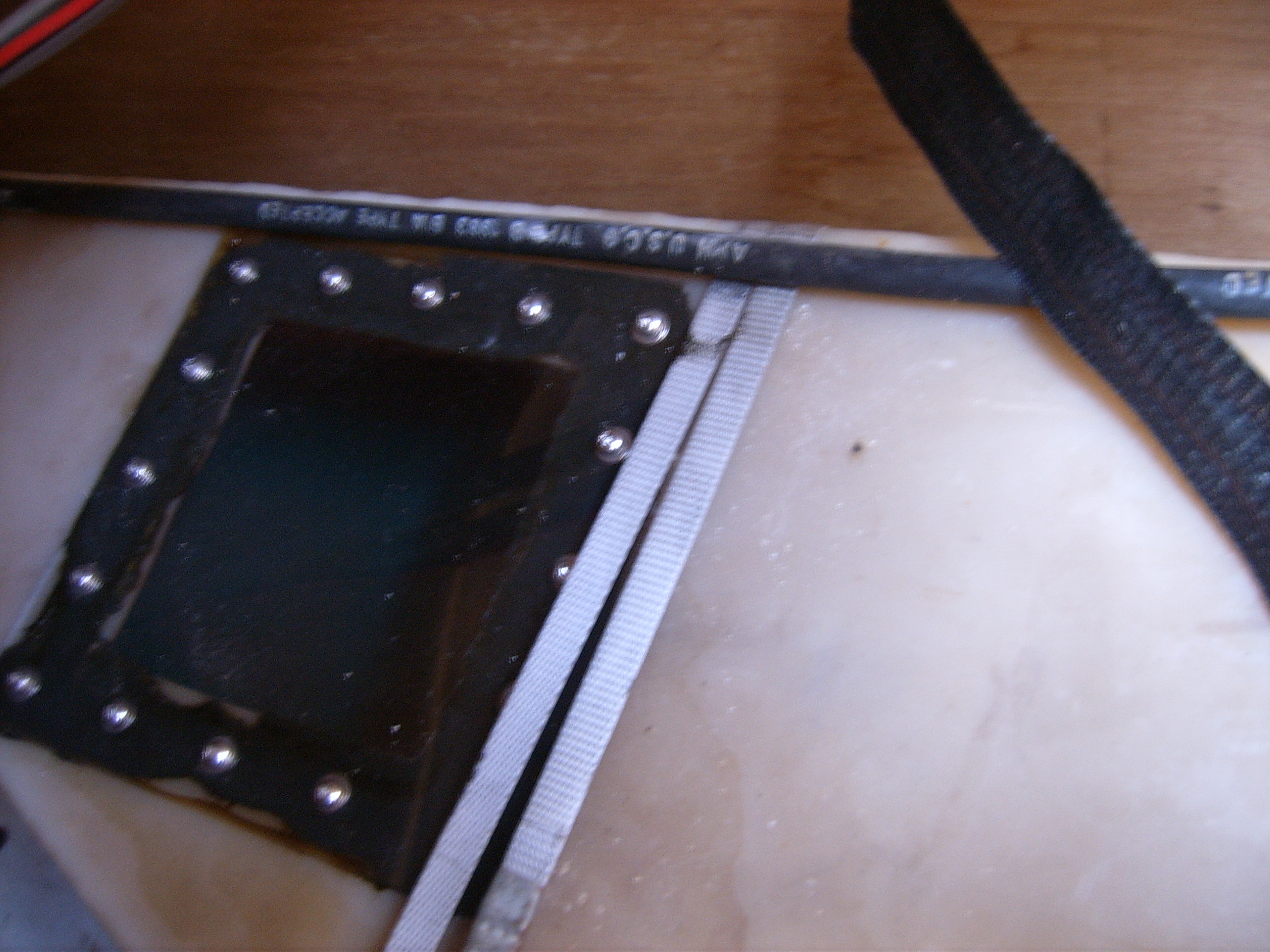

I cut an opening in mine about 9 years ago. I re-sealed it with a piece of lexan sealed with a Permatex sealer- look for one that is impervious to kerosene or diesel if you can find it. I screwed it down with SS screws. It is important to pre drill and insert the screws in the holes before sealing, then do another wipe out of the tank. I found it adhered fine- I removed it about a year gao to check and clean- it was just fine, really didn't need cleaning.

Clean out on fuel tank.JPG I cut an opening in mine about 10 years ago and cleaned it out- it really needed it. I re-sealed the opening with a piece of lexan sealed with a permatex sealant- choose one that is impervious to kerosene or diesel. I screwed it down using ss screws. It is important to drill the holes and insert the screws before sealing. Than wipe down the inside again to get any plastic bits. Mine sealed fine- I removed it a year ago to check and clean and it was well stuck down. Here is a picture of the cover
