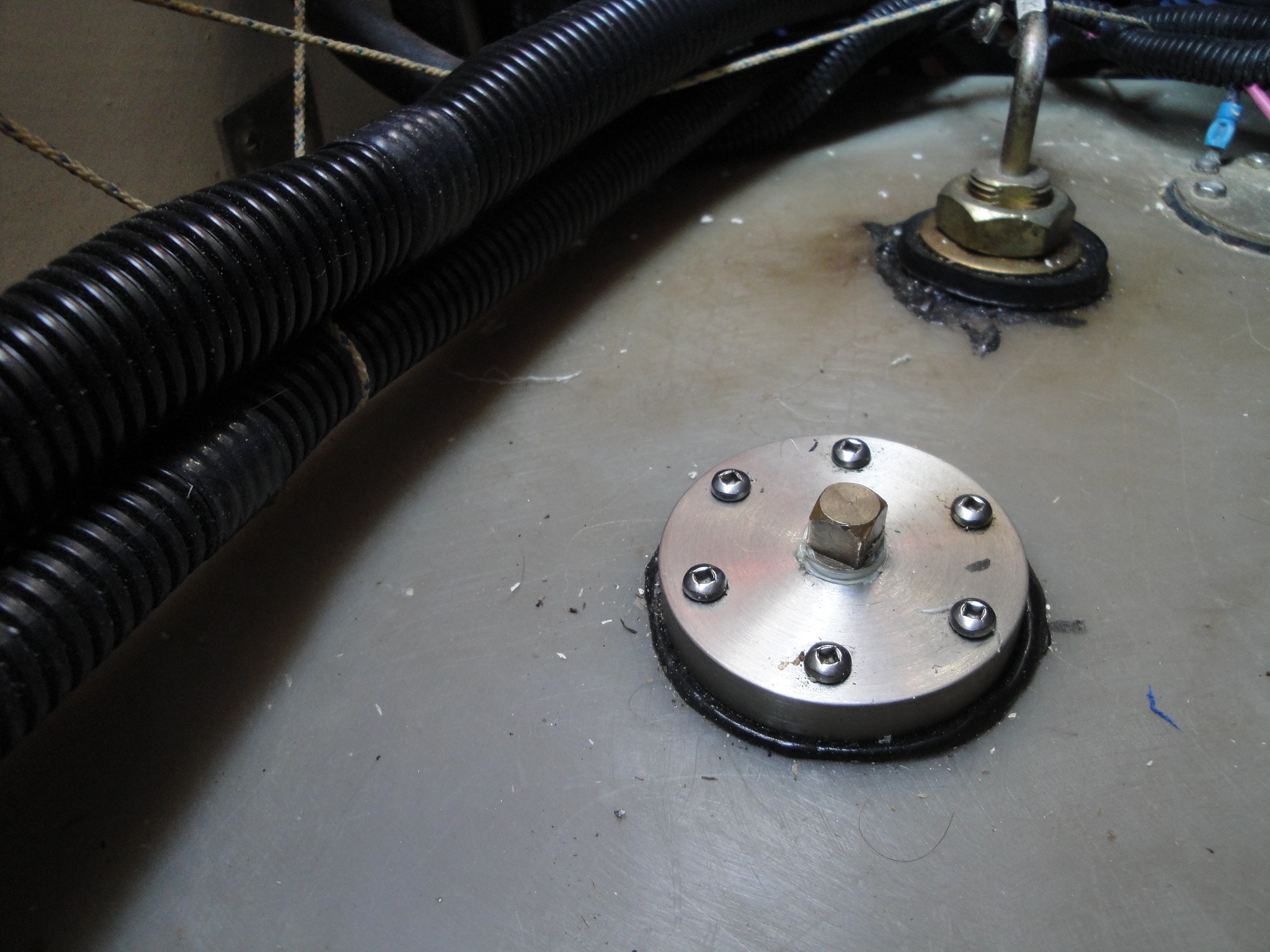

I use this access to pull out (using a Pela oil extractor) any small amount of water/crud which may accumulate at the lowest point in the tank.

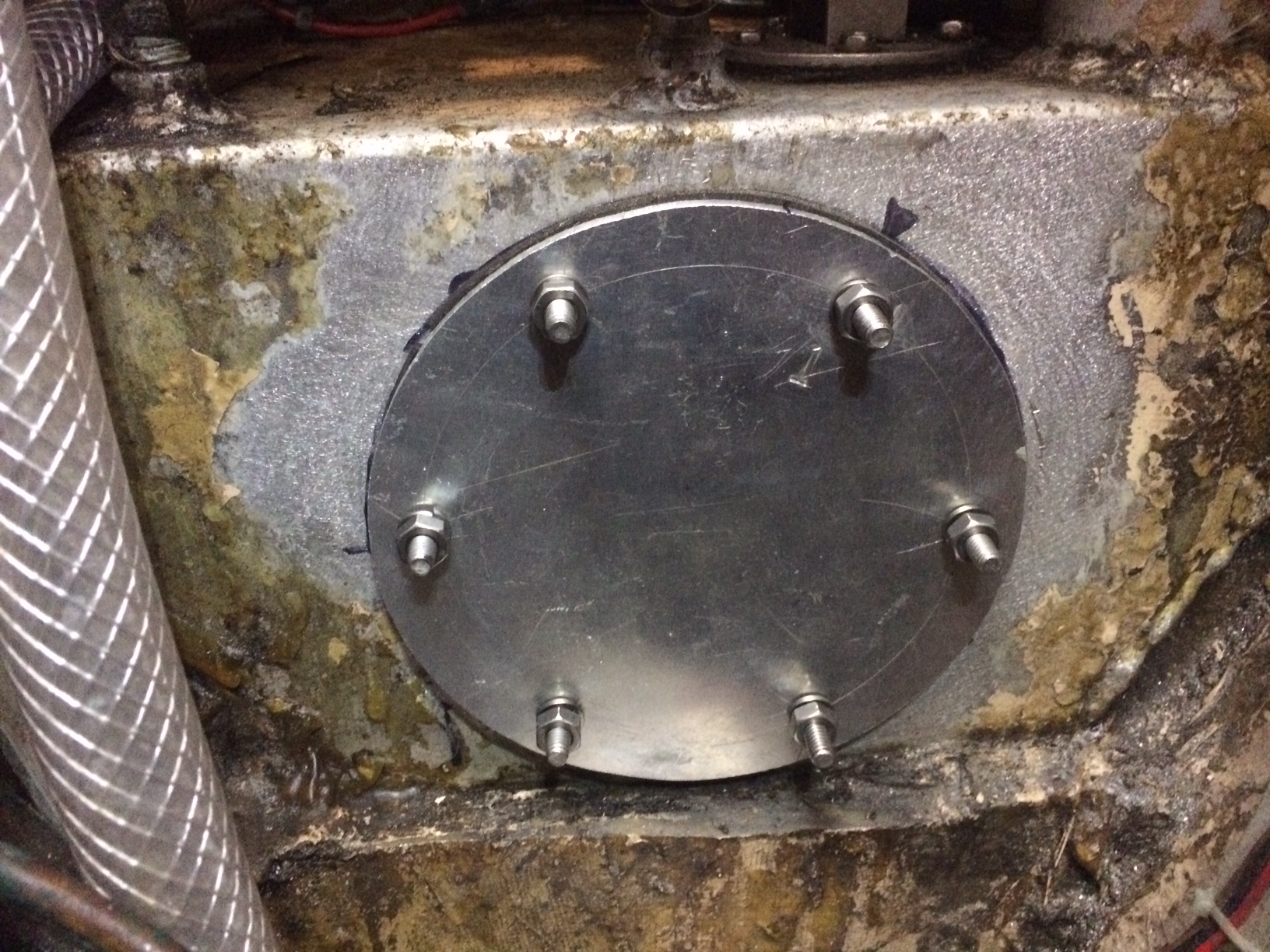

Here is a possible solution. The tank was quite long located immediately beneath the motor in the keel so removal was not convenient. Chemical/enzyme treatments were quite ineffective.
I made up two plates/gaskets and installed one in each end of the tank. These are like Ralph's plate only the hole in the tank is 4 inches diameter, the backside is reinforced, and I used studs for fasteners.
Such a plate permits access for a long handle brush. In this case the tank surfaces were also blasted repeatedly with a small Ryobi pressure washer. Spray/brush the surfaces, vacuum the water out, and repeat until the water comes out clear. These repetitions used about 3 gallons of water each pass.
Similar plates can be purchased from Seabuilt.
