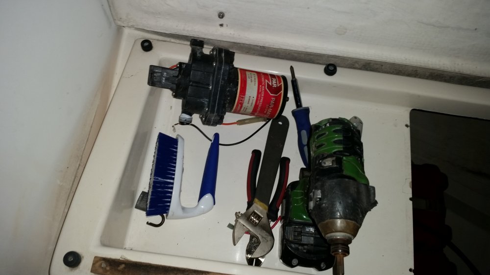

I have a 1983 Hunter 31, and the Jabsco freshwater pump was not functioning. It made noise, but did not pump water. I tried to prime using a shopvac at the kitchen faucet. I was able to pull water from the tank through the plumbing, but as soon as I shut off the vacuum, the water flow stoped, and the pump was still just making pumping noises. So, I replaced with a brand new Shurflow pump bought at local yardsale for $5
I now have running water, however this system must have been out of service for a long time. Lots of mold/slime, came out of the faucet, and I still get almost zero flow out of the sink in the head, and very little to zero flow anywhere out of the Hot Water side of they system. How would you suggest cleaning the plastic waterlines of any standing mold/slime without damaging them?
I have thought about using pressurized air to blow them out, but don't know how much pressure I can safely use.
Are there any chemicals I could safely run through the system that would clean the lines?
