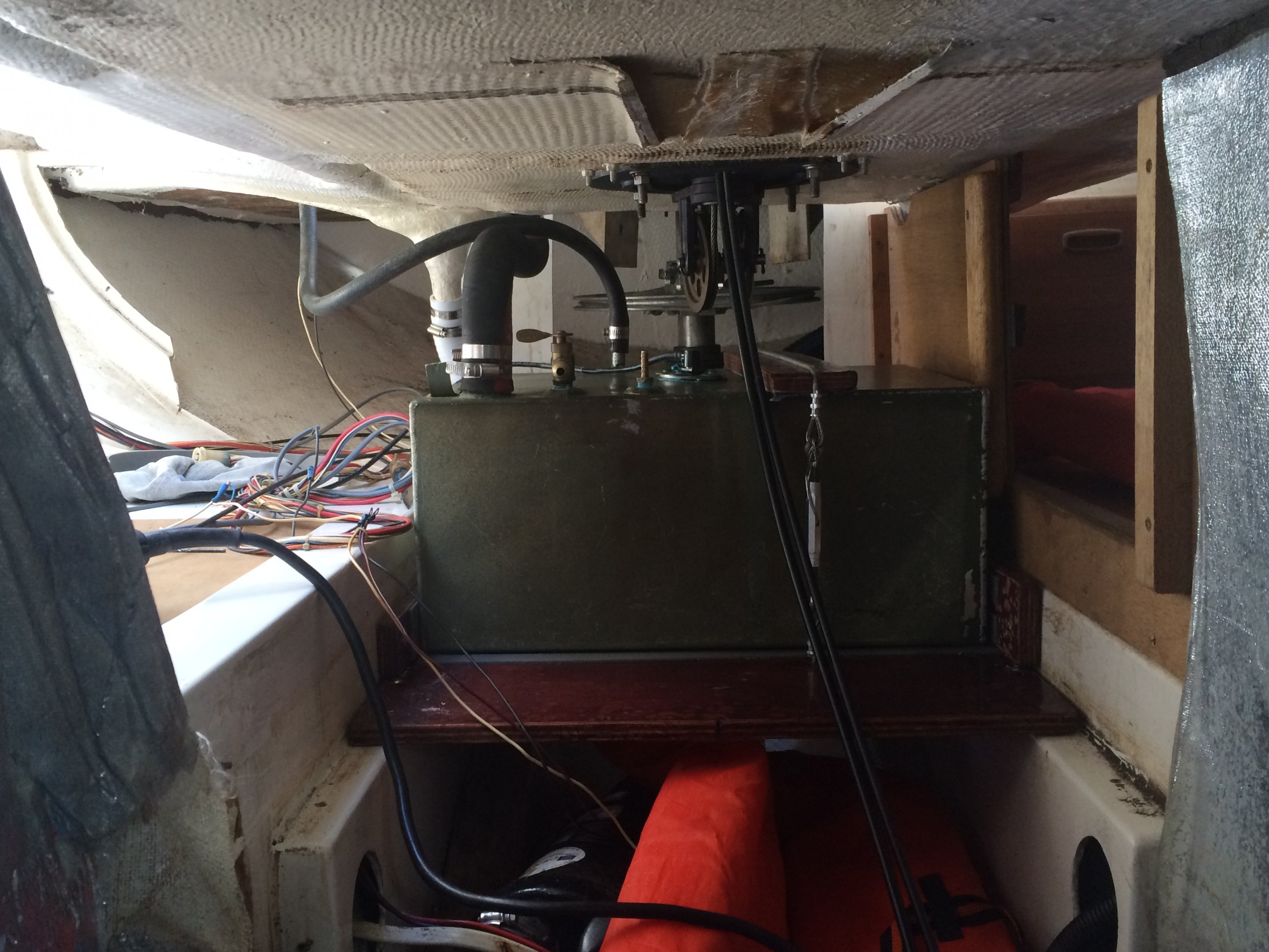

I did the entire area of the fuel tank in 2015. I have an 82 so the fuel gauge always leaked and saturated the plywood holding the tank. The Ply delaminated. I had to toss the water heater and pulled the tank to thru the starboard Laz. Epoxy coated the new ply and used a wire and turnbuckle arrangement to strap down tank. The wire does not touch the alum tank. I put the new type fuel level sending unit. Works great. No leaks. Also pressure tested the tank at 3psi. Some exterior pitting on bottom of tank. I coated bottom exterior with JB Weld. No Leaks. Smell of Diesel is gone.

On the '82 that would be so. No problem. The water heater in front of the fuel tank is another story. I would not assume that you can get the fuel tank out through the starboard lazzarette on all the Cherubini H30s. Hunter changed things from one model year to another.

Looking at your pic, the engine bay space to lazzerette is identical. I already removed the original water heater through the engine bay with a small mod to the lazzarette shelf, so I should be able to get the tank out through it if it will fit through the seat opening. As Hamlet said: "That is the question"

Yes, I removed my fuel tank through the starboard lazarette after I removed the inoperative water heater. Cleaning the tank now before replacement.

Mbirk, thanks for the info and confirmation. I will measure twice so that I don't have to cut once before I remove the tank.
