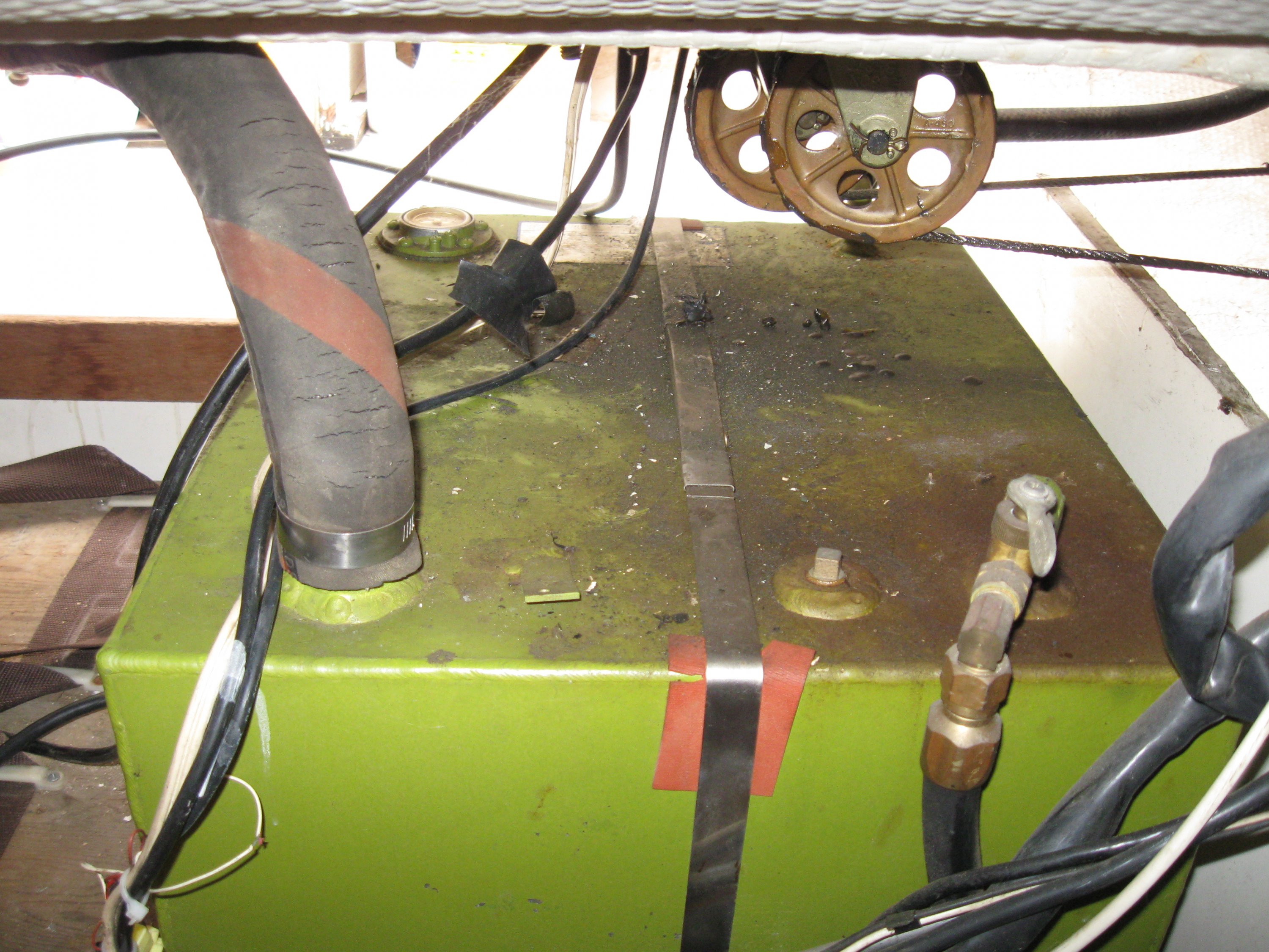

Here is a picture of it.

Please let us know how you get the tank out. I see you've already removed the quarter berth bulkhead, which I had to replace. I've thought of replacing my tank but I don't want to start the project until someone else does it and will share the process.

It probably goes without saying, but......regardless of what you do with the tank, that fuel fill hose has to go. It's probably original and is well past it's expected life span.

I agree with Dalliance. That hose is worn out. Will probably break when you remove it.

Thank you for the recommendation. Believe me, it is being replaced. Along with every other hose in the area.

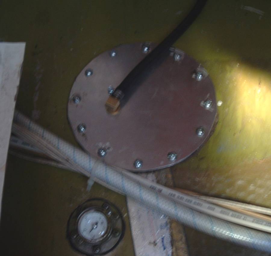

I cleaned mine in the boat by adding cleanout ports. I had to add two because the tank had a baffle. I pumped out the tank into a barrel and gave it to the marina for the yard tractor. I was surprised how little crud was in there after twenty years.

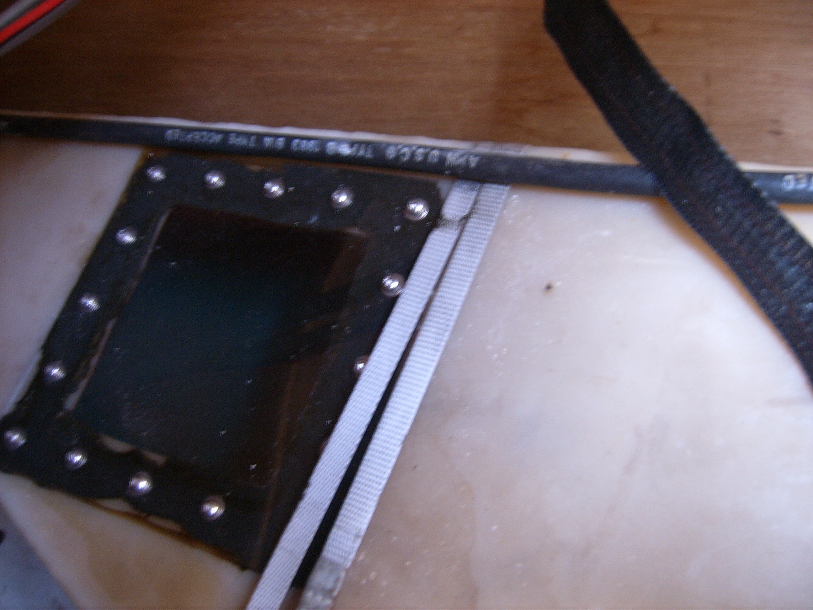

I cleaned mine about 10 years ago likely for the first time. If I had known how much crud was in it I would never have ventured out in waves over 6"! The last gal and a half looked more like they had come out of my eavestrough than the tank. DO clean it. I cut a hole in the top- easy cut with a utility knife- then wiped it out, then again with a kerosene soaked rag. I closed the opening with a rectangle of lexan screwed down every 2" with SS self tapping screws. Sealed first with liquid gasket - choose a type that is resistant to kerosene or diesel. I opened and cleaned again this fall after haulout. Not very dirty at all after only 10 years. Here is a pic of the cover

Mine is a welded aluminum tank. Is yours the same material, just asking as you mentioned you cut the hole in the top with a utility knife. It seems like a very good idea though.

Richard has a poly tank, either a later model boat or an upgrade. I wonder if polyurethane contributes? I've known others with aluminum tanks that found theirs to be like mine, just a little crud at the pickup.

Yes mine is poly- I only took a quick glance at your pic and it was about the same colour as mine so thought poly. Cutting will be a bit more tricky- making sure no particles stay in the tank and get into the fuel. I wonder if poly accumulates more crud somehow. The boat was always a freshwater boat, but maybe additives contributed?
