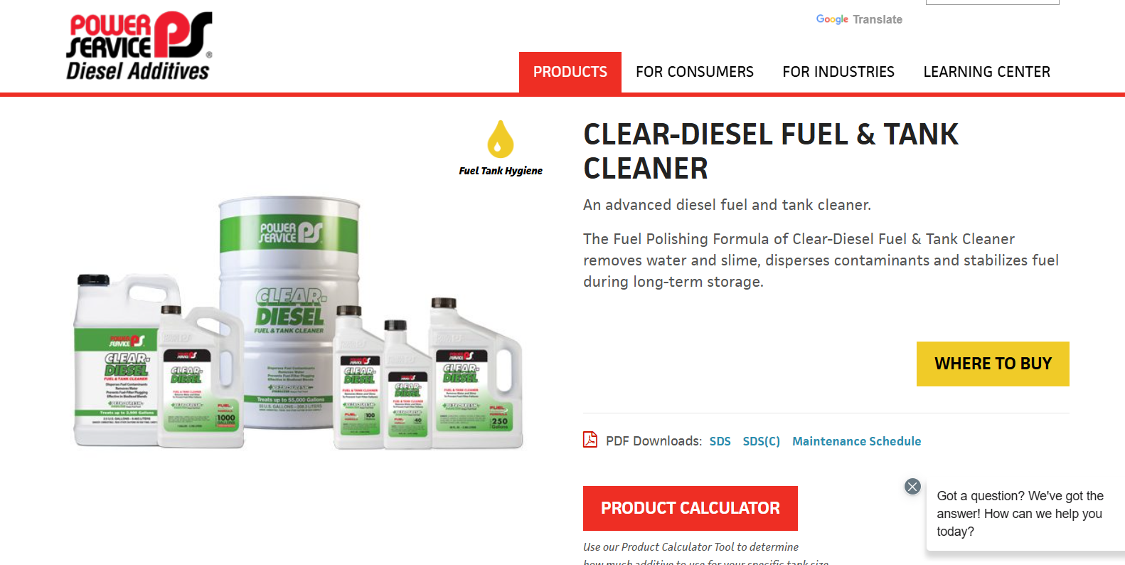

Here is an idea.
Here is a product that may be helpful.
This interested me, so I started looking online to seek out reviews.
This PS review from 2013 was noteworthy. The only other reviews I found were anecdotal from users, (edit: most were favorable).
Fuel Right
This product, one of the most expensive in our comparison, was not tested in our previous biocide trial. It is not a registered biocide, although the company claims protection against biological growth.
While the product has its supporters, it was the only product tested that made corrosion worse than the control, and it was the only product that induced pitting in the aluminum sample. Perhaps an increased dose would have helped-it had by far the lowest usage rate-but the product literature did not suggest higher rates for special purposes. Available in 16-ounce, 32-ounce, and 1-gallon bottles, this product is a good example of why boaters need to be wary about manufacturers claims. Bottom line: Not recommended.”

I had the same issue when I got my boat. Previous owner never added any biocide. Complained that once in a while the engine would quit due to fuel starvation. I opened up the tank at the fuel tank level sending unit and the bottom was caked in thick black sludge that was plugging the intake pipe. I built a polisher and ran it for a couple of days stirring up the bottom. Had to empty the separator and change the filter a couple of times there was so much. Same as you I was concerned about the crap on the walls. I found this product and my tank is clean now walls and all. Haven't had any problems in years.
