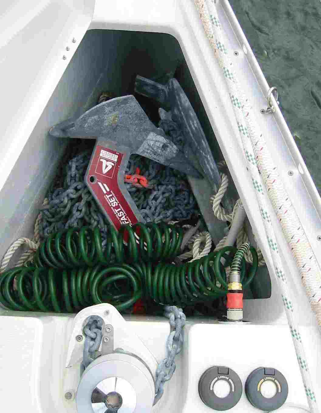

If all you want is an anchor washdown. You'll use a couple of gallons, tops, and you won't have funky marine life decaying in your anchor locker. There's a cool little quick-release deck fitting that Newfound Metals sells on their website. I installed that on my boat when I put in a windlass this past spring. You can see it if you follow the link. Paul sv Escape Artist h336

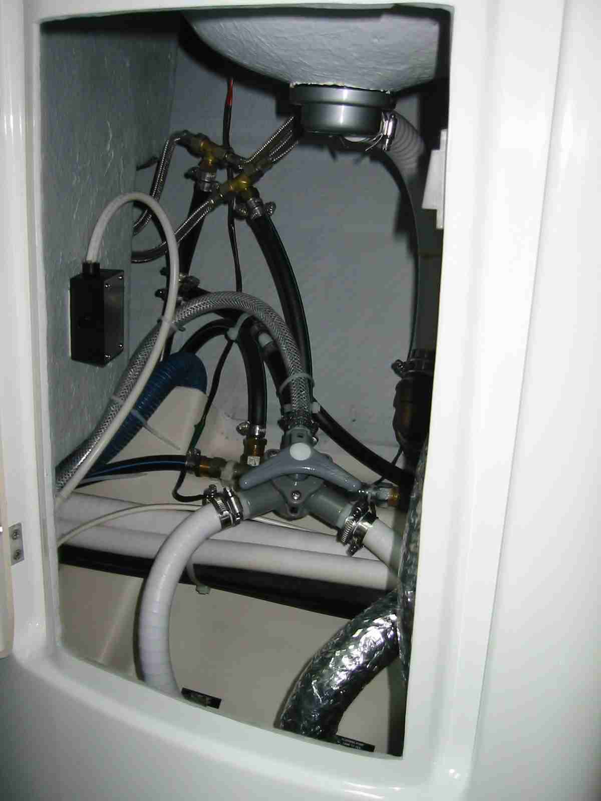

Kevin, I installed a dedicated 12 V water pump with a permanent hose up to the anchor lock. With a 2 way valve, see picture, I can choose between fresh water from the tanks, or raw water. To avoid drilling a second thru-hull, raw water is taken from the head water inlet using a second 2-way valve. I included a check valve in the fresh water inlet pipe to avoid contamination of the water in the tanks. To simplify electrical connections and plumbing, I located the new pump in the same area of the main fresh water pump and I installed a switch to direct the current to either one of the pumps at a time. This saved me from installing a new circuit breaker in my panel and the extra distance of wiring. It took a little planning to come up with all the fittings, but it has been worth.
