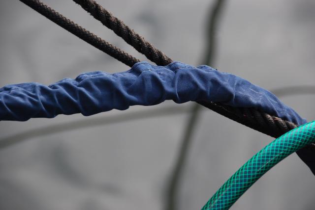

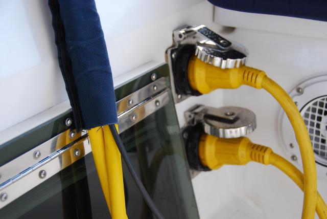

We made our own covers.
Our 'umbilical' consists of two 30 amp cords and a coax for TV/ISP. We could never keep them clean. They would leave a grungy residue on anything they touched. Coiling and stowing was a nightmare.
We made our own covers out of about $50 of Sunbrella and velcro. It's still a wrestling match but it's at least more manageable now. That was 7 years ago. Still using the same cords and cover and they still look like new. We made a 50' and a 25' one. We can connect them if the power pedestal is too far away at a transient dock.
A big problem in our experience has been that plugging and unplugging the cords without religiously shutting off the breaker at the pedestal causes arcing and pitting in the plugs and receptacles and becomes a fire hazard. Don't ask how we know this.
