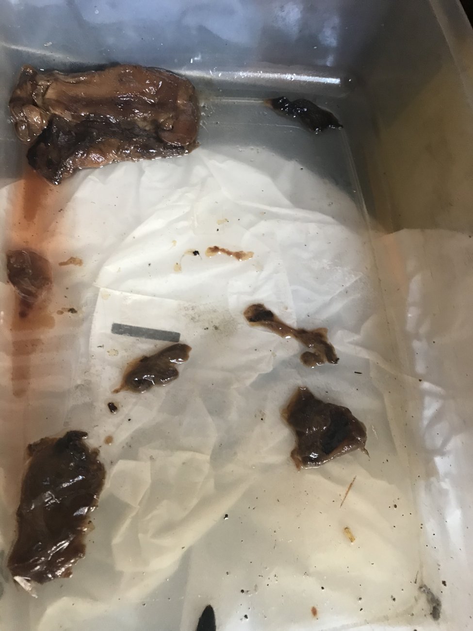

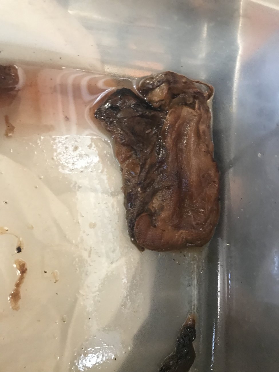

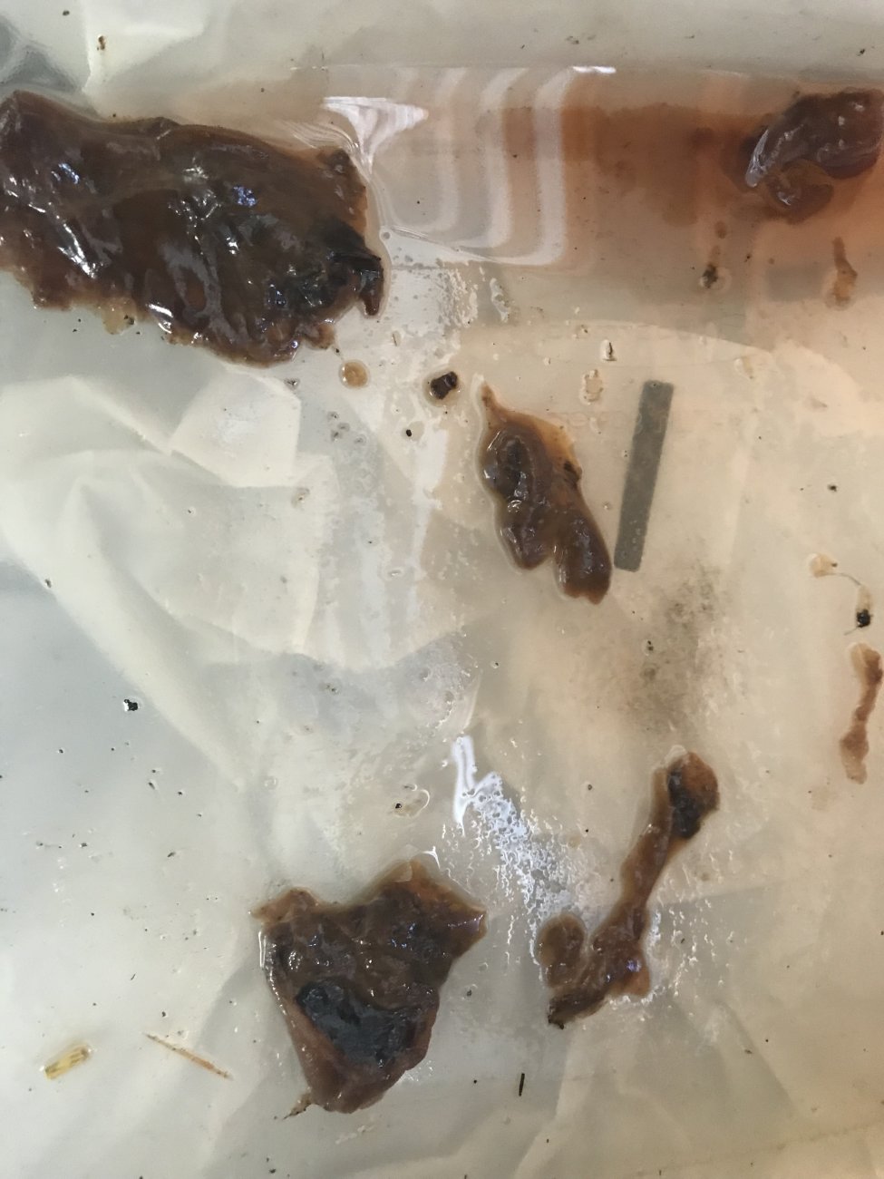

Well 2 times had to get towed by BoatUS back to my dock and changed out both fuel filters but yes engine still stopped and so decided to check fuel tank and pulled out pickup tube and found the screen was dirty but got one of those snake camera and could see some funny looking junk down on bottom and so pumped the fuel empty and could still see junk and used shop vac and sucked out some funny junk.
I am now running all my fuel through a racer fuel filter before putting back into tank
here are some photo’s of funny globs that came out of my tank.
First time ever having fuel problems.
