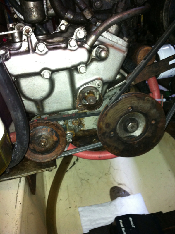

Thanks everyone, I'm heading to the boat today. I'm going to try the Simple Green approach first and report back with pics.

Went and cleaned the engine and engine compartment today. I used Simple Green applied with a spray bottle and rinsed off with water from our garden sprayer we use for cockpit showers. Worked like a charm. I am really impressed with Simple Green as a cleaning product. I expect it will be a staple in my cleaning supplies.
