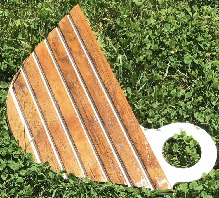

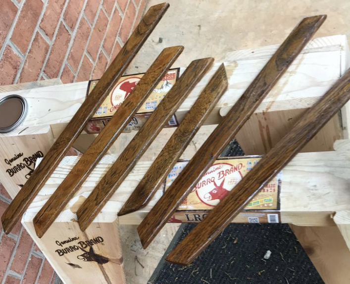

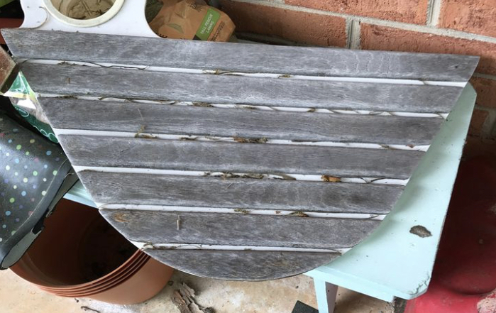

Here is a before strip, an after strip, and an after sand/revarnish
