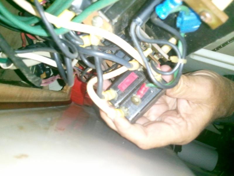

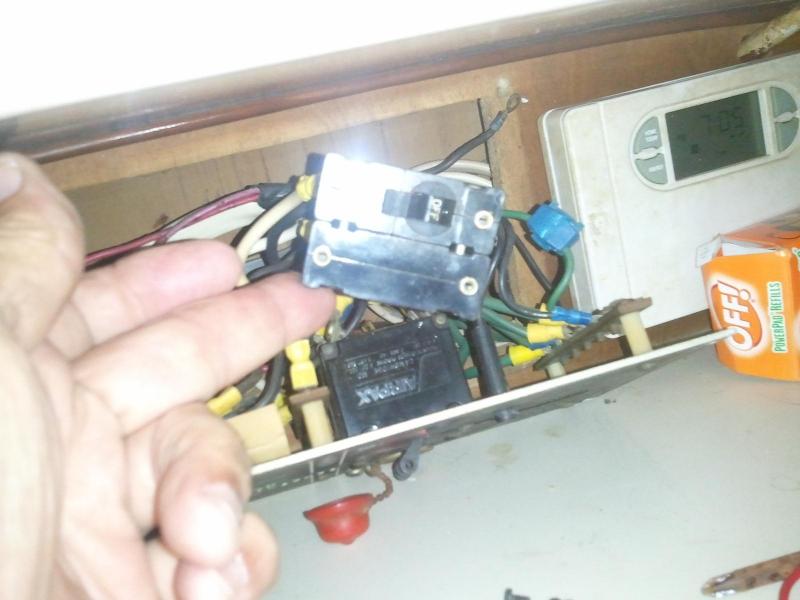

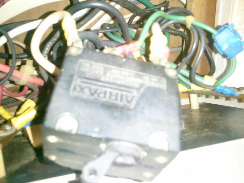

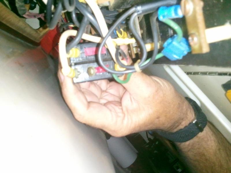

i have a 1984 hunter 31 that the main 110 volt circuit breaker has died. mine has 5 lugs on the back and a single toggle on the front. it is as wide as 2 of the others. it has 5 lugs on the back. on the corners, one is for black, one is for green, one is for white and one is a white wire that goes to a bus. then there is a center lug that has a green wire that seems to go to the reverse polarity light. it is made by airpax and says it is 37 amp. i cant seem to find a replacement. is the type with a double toggle a replacement? i can cut the panel to accomodate one.

The breaker is actually two breakers ganged together internally. The same thing can be accomplished with two single breakers connected together with the fancy little dowel and screws arrangement between the toggels on the front so they opperate together.
Electrically you are trying to switch both the hot (black) and neutral (white). that accounts for 4 of the lugs. The lug going to the green safety ground is just that, the safety ground for the breaker. the pics show it going to the (presumably) ground buss
Most ganged CBs have these so as long as you are OK with drilling another hole in the pane for the second toggle you can go the two single CBs ganged together route.
