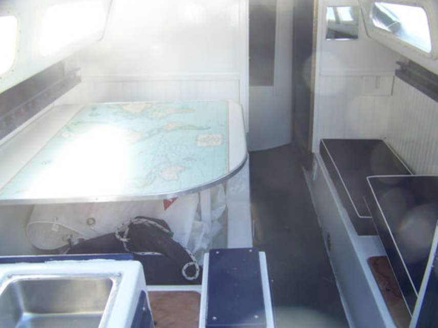

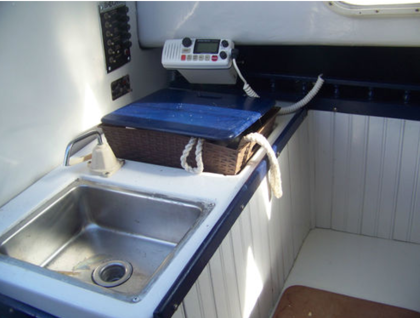

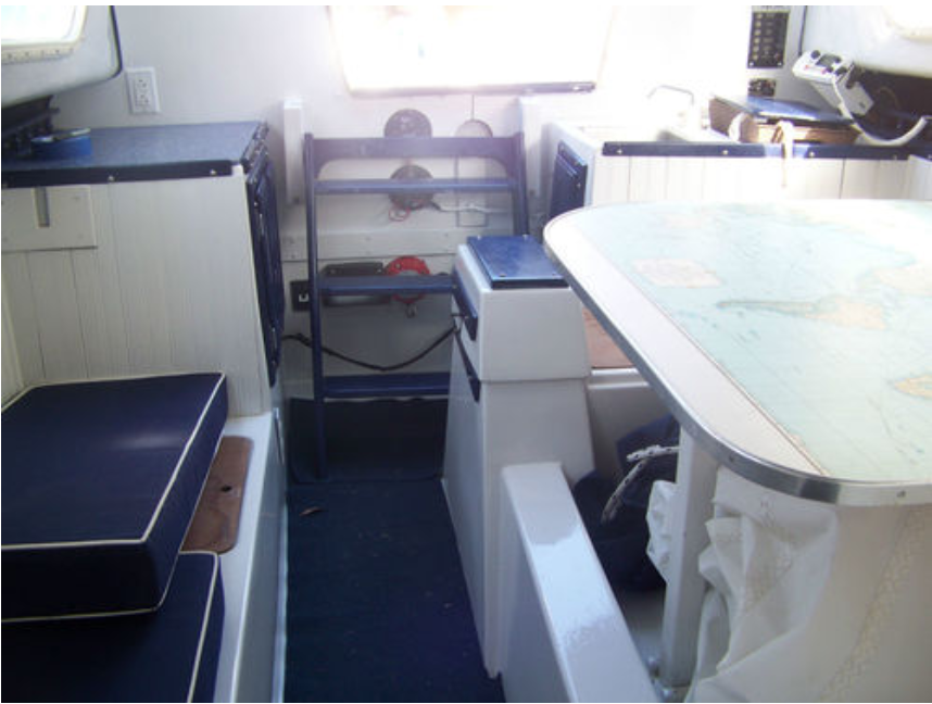

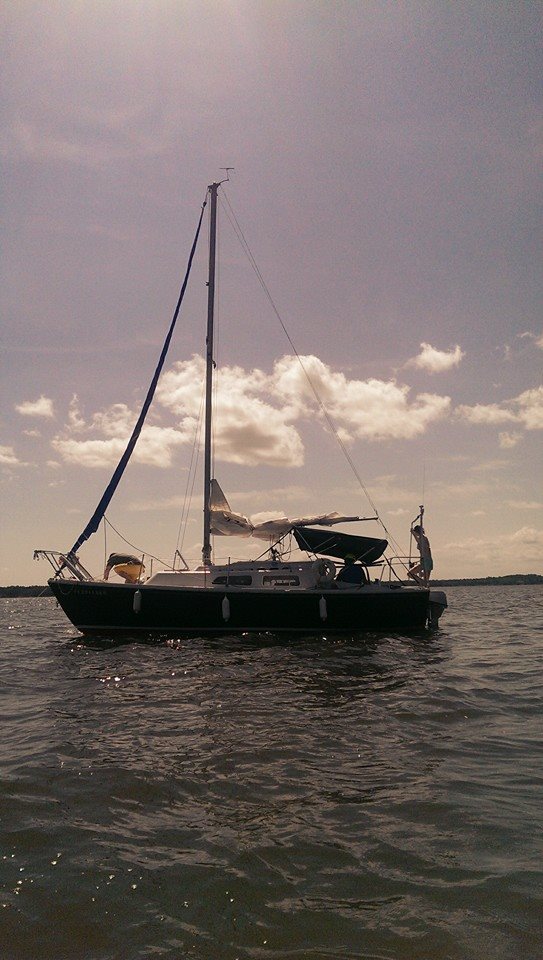

I used to own a Balboa 26. It is a very heavy and well built boat. The fiberglass on this boat is THICK and reinforced in key stress areas. It is technically trailerable but it is not easy to launch and retrieve. I'd say the Balboa is great if you want to trailer home for the off season but you would want a slip or mooring if you were going to use it regularly. The Balboa has a 1200lb lead bulb on the bottom of a cast iron swing keel. It is one stiff boat. If you look at one, pay close attention to the keel area and ask for a test sail that will let you get her heeled over. The keel pivot bolt is below the water line so any issues with the bolt gasket will result in significant leaking. It is a relatively easy fix but it would require that you have the space and tools to make the repair. You want to put some stress on the pivot pin to make sure it is not leaking so the test sail is essential. You also need a serious keel winch and hardware for this beast so look over the condition of the winch and cables.
There is also A LOT of storage under the cockpit area so if you set it up well with easy to use storage compartments, it would make a nice long range cruiser. I used to keep four small coolers in there and still had room for a 10 gallon gas tank and it was not even close to full. That area would also be a great place to put an expanded batter bank (if you move the gas tank). The cabin is very nice and the V-berth large and actually usable, however there is no main berth. You have to drop the table to get a "main berth". With the table dropped, you have a nice queen sized bed. To starboard is a settee that could sleep a 5th person. There is an area for an enclosed head and a hanging locker. There is also a large icebox to port that is usable but could be converted to an actual top opening fridge. The galley sink is also in that area. To starboard is a place for a stove. Mine boat's stove was removed by the PO and I used a camping stove on top of that counter. You can see all of this in the photos below. As a long range cruiser, it would be nice for a couple and one kid. As a short range weekend cruiser 4 or 5 could fit. Five gets tight as storage becomes an issue.

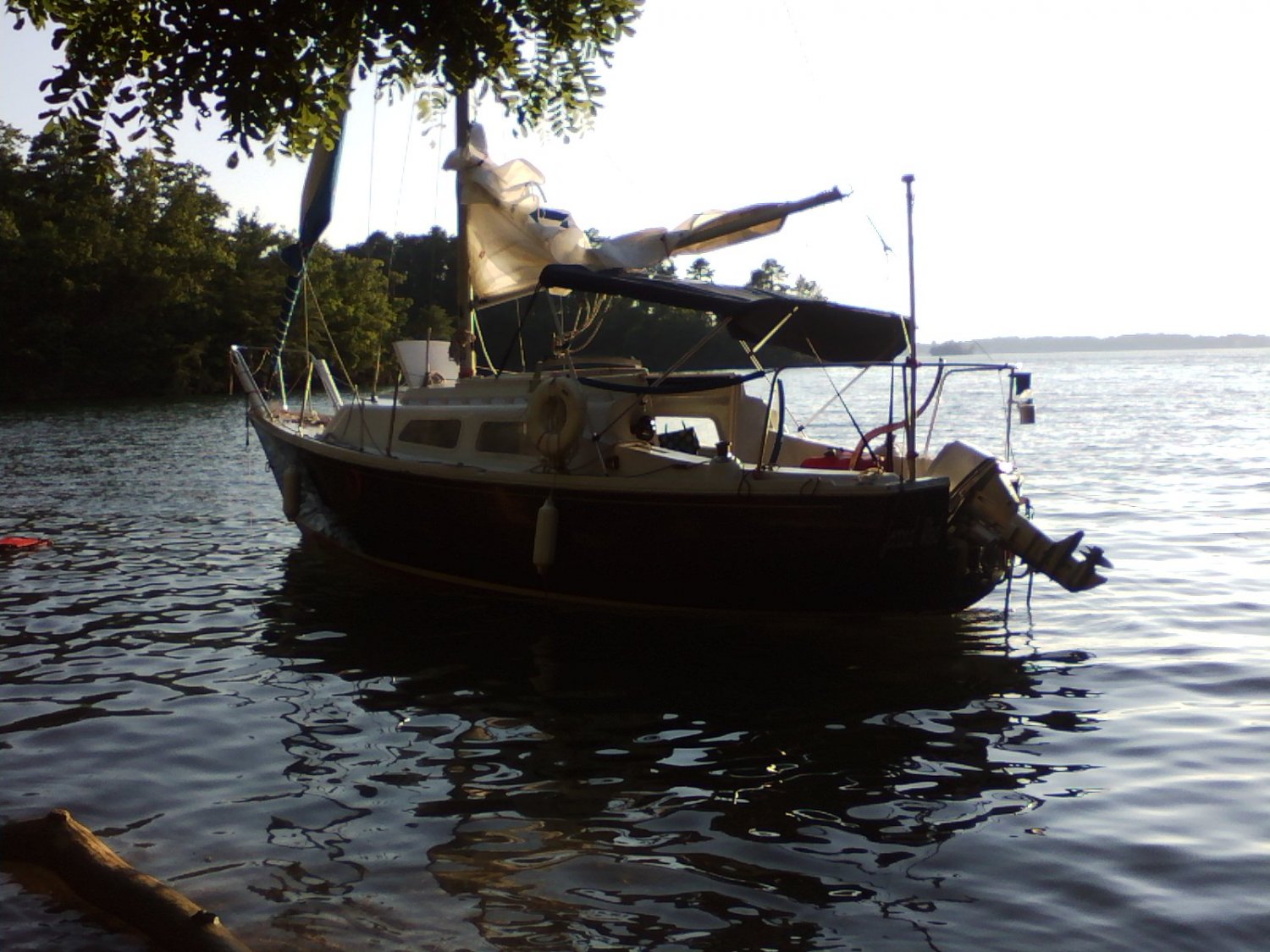

I did a lot of work on mine and have attached a pic of the keel I restored. You can see the lead bulb and get an idea of how stiff this boat is. I have also included some interior shots. In the first interior shot, you can just make out the hanging locker to starboard just before you get to the V-berth. The head is behind the bulkhead to port. The V-berth is behind a second bulkhead so the head and hanging locker are in their own "room". You can just make out the opening to the V-berth in that seam photo.
The first two water shots are at Smith Mountain Lake in Virginia. The second two water shots are in the Pamlico Sound off the coast of North Carolina. She is a stiff heavy wind boat and can go into shoal water but raising and lowering the keel takes a few minutes so it is not like you can sail fast in shoal water and quickly raise the keel as the bottom rushes towards you. You still need to pay attention to the water depth.
