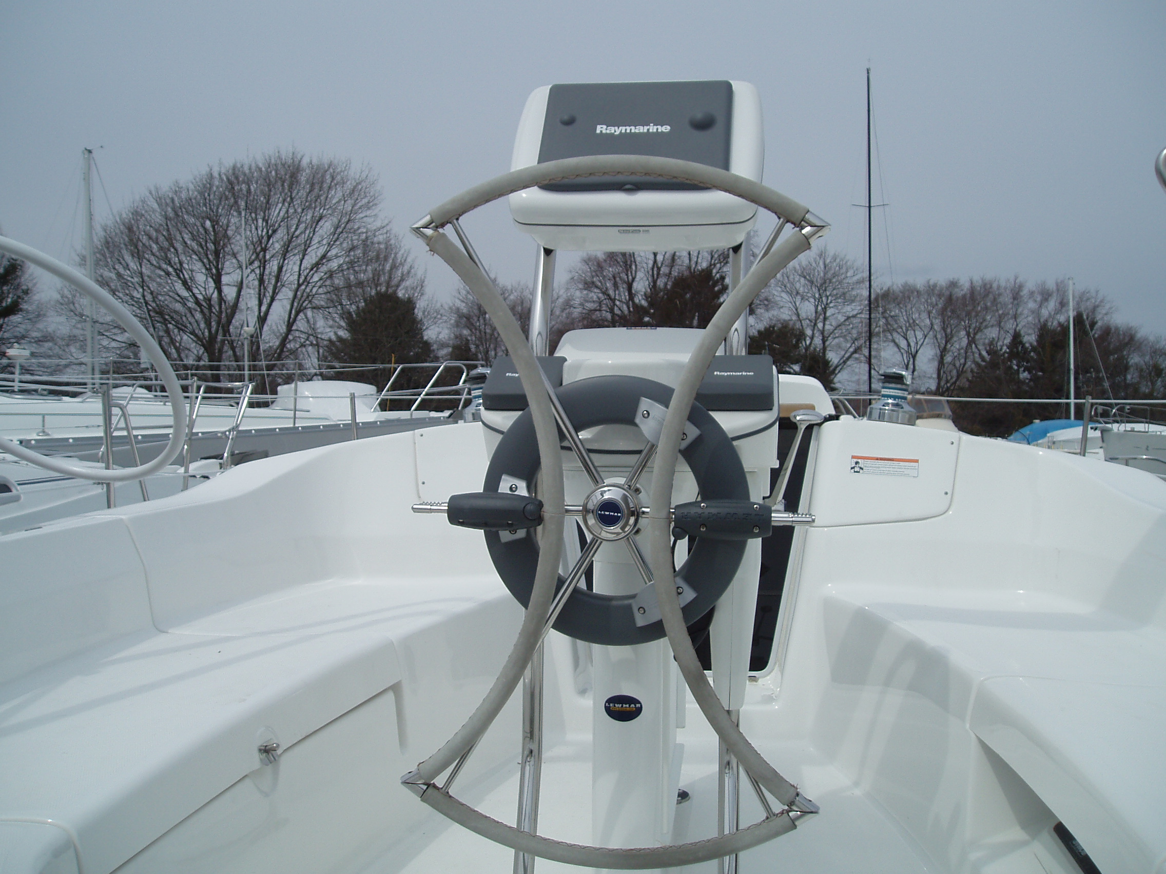

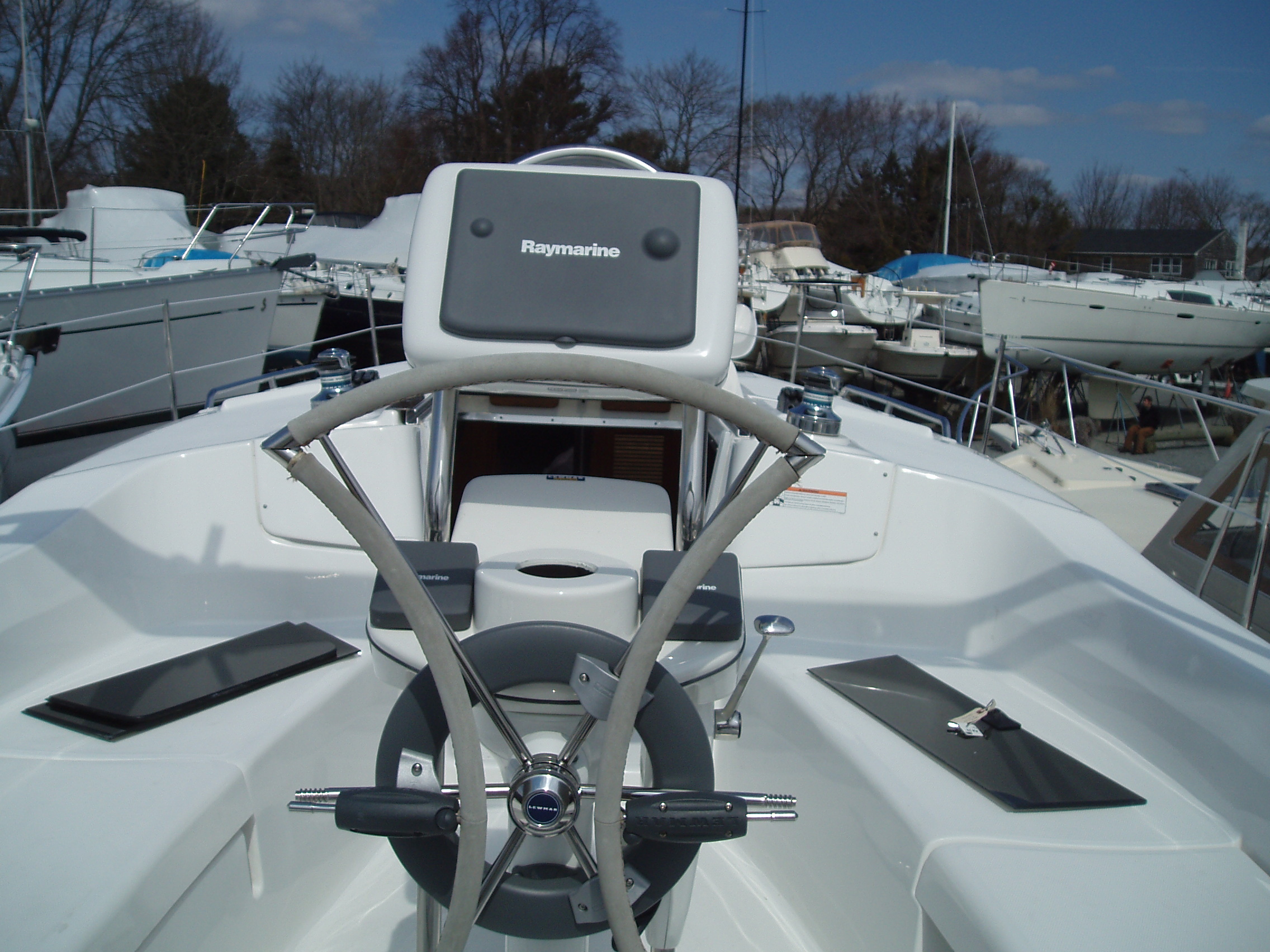

This is my GPS Chartplotter at the helm and very happy with it Ray C-80 and it does everything I could ask for and have radar auto sonar and did have sirius sat weather but gave it up for smartphone weather.
At one point was going to upgrade to newer wifi Ray chartplotter but found out my radar would not work with the new
and I think my sonar would not work with the new and need other upgrades so decided why would I change when so happy with what I have.
My wife has a samsung tablet and added Navionics to that and Iphone and all kinds of weather reportig on both
I will be waiting for dock to dock coming soon to android before renewing the app and maybe even try out Plan2Nav
and so I am all setup with plenty of backup and yes still check my paper charts.

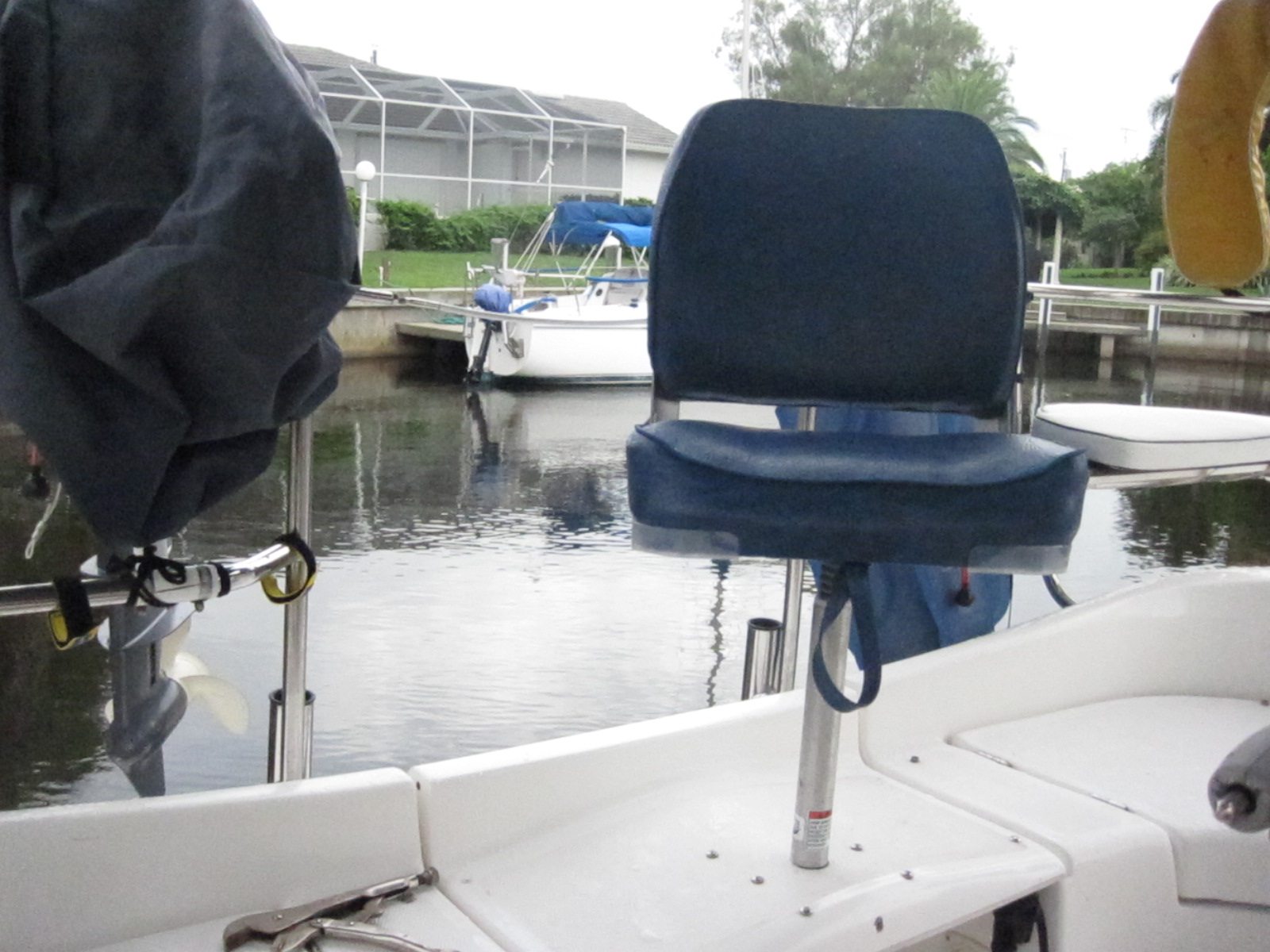

Helm seat upgrade and always having back problems and not be able to see over the helm or out over the bow of the boat when sitting was always looking for a solution and here is what I did
and works great better than I hoped for.
Nick

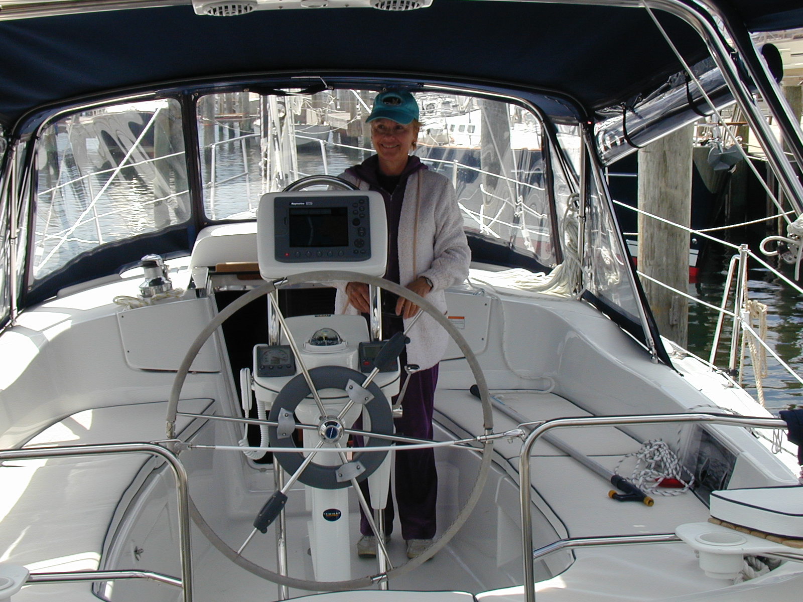

Thanks for the Photos,
I seethat you have a Nav box mounted at your helm and the C80 is flush mounted in that box.
This is what my helm looks like, and I am trying to get ideas of how to mount the C80
Dec 19, 2006
5,832
Hunter 36 Punta Gorda
I see you have the stainless bars for mounting a nav pod but looks kind of tight,a friend got hit lightening
and he upgraded to all new Raymarine and what he did was add a bigger nav pod that had the chartplotter
and instruments on each side and I think they extended the stainless bar up to fit and his helm did look like yours on a 85
old boat before the upgrade.
If I think your compass in middle can be changed and lowered maybe no need for raising the bars and those side
things I am guessing would go into the new bigger nav Pod.
I guess how much $$$$$$ to make the change or maybe you are able to fit the nav pod with out any real big
$$$$$ changes.
Look on E-Bay and I think I saw in the past some new and used Nav Pods,I have not been on E-Bay for a while but
I have found some real good deals over the years but it is work looking.
