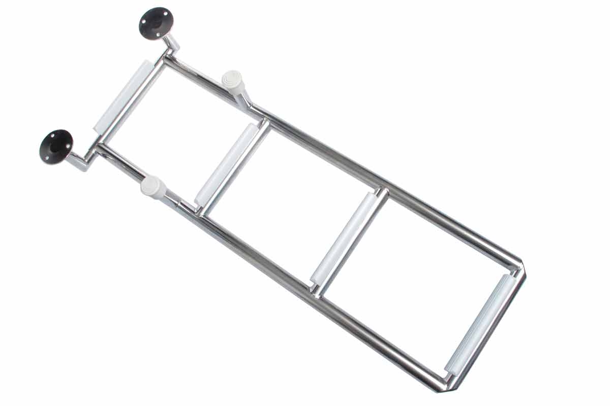

Option 1 is the ladder CatalinaDirect sells for the C22 and other boats. It's a traditional style that folds up against the stern rail when not in use. The only downside I can see this is that it could be tricky to bring the ladder down from water level (person overboard). It does seem like it would fit the boat very well.

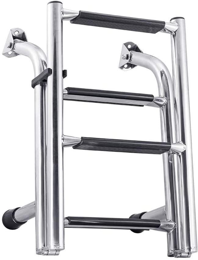

Option 2 is a ladder that folds in half and is made by White Water. I've marked a template and it should be able to just fit it (with rudder clearance) so that the its lowest section does not project beyond the transom at all. The trick with this one is that the best mounting place will put the right side mounting holes closer to a through-hull than I would like. I would imagine that this might drag in the water a little when the boat is heeling to starboard but, then again, I'm certainly not racing it. It does seem, however, that this ladder would be easier to fold down by a person who had gone overboard.
Do any of you have one of these types or the other? Your thoughts welcome. I just heard from a dealer for the second ladder and it seems that it is able to swing freely. If you happen to have this type of ladder, does it tend to knock against the hull (at the rubber bumpers) in heavier waves?
