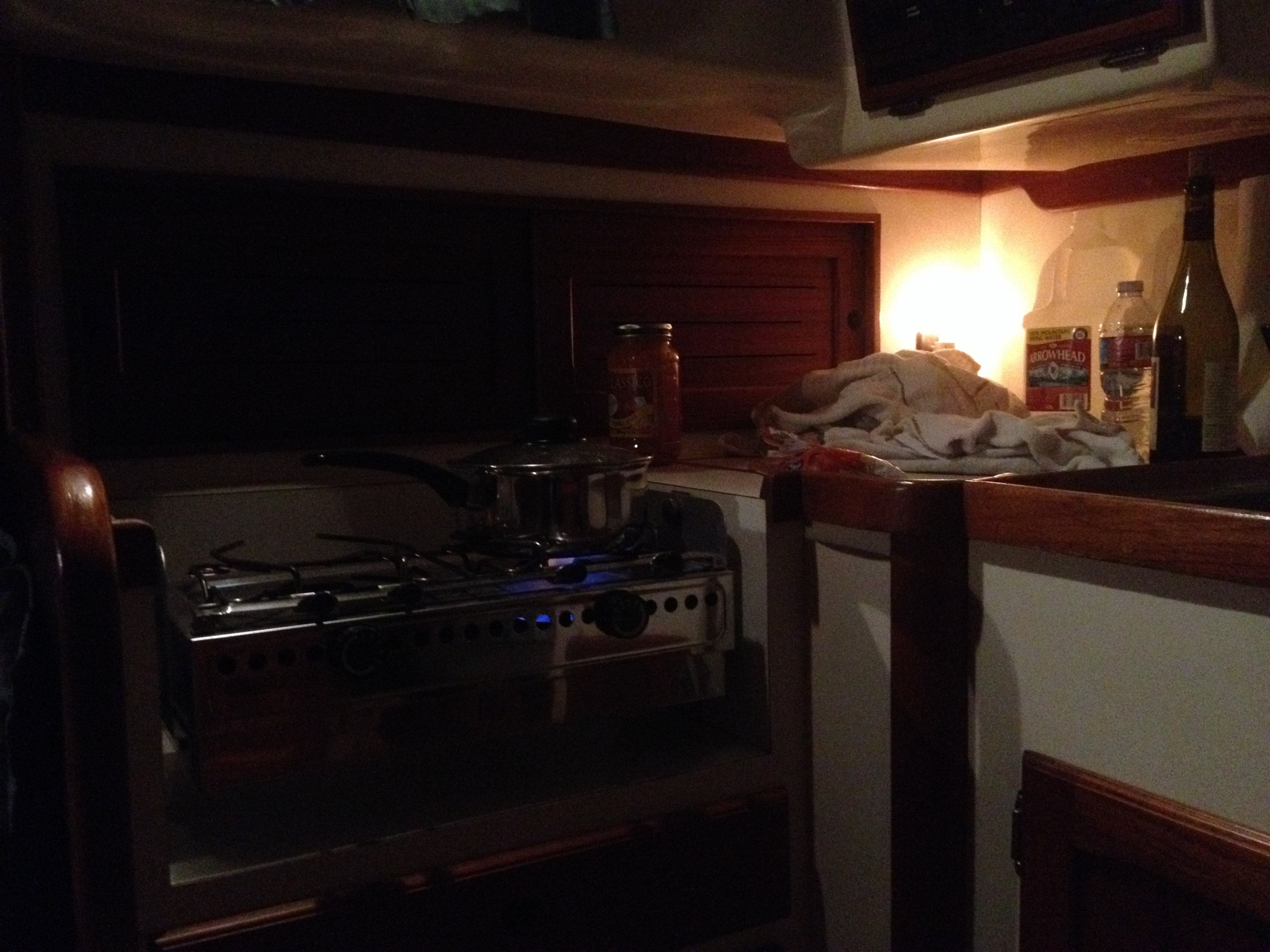

I have an Origo.
Fantastic quality. All stainless.
And brilliantly simple.
It delivers enough heat to boil water in 5 minutes. The internal-wick reservoirs are huge, enough to cook for a week.
Operation only requires opening the valve, which is merely a mechanical reservoir cover, and hitting the top of it with a torch. Adjustable flame using the valve.
Extinguishing is as easy as turning the valve off which closes the cover.
No flaring, no leaking, no pumping. Safe as can be.
Mine is gimballed with pot holders. Can cook under way.
Or you can lift the stove a little and pivot it down flat on the surface, securing it.
Cleaning is just popping the grill off with one motion, and wiping it down.
Fuel is cheap and can be found in any hardware or paint store. No trying to find a propane station, many of which now only exchange 5 gal tanks i.e. Rhino. Not (need confirmation) the 1 or 2 gallon that a sailboat needs.
Side note, it gives off a beautiful blue flame, which reflects nicely off the stainless in low light. :)

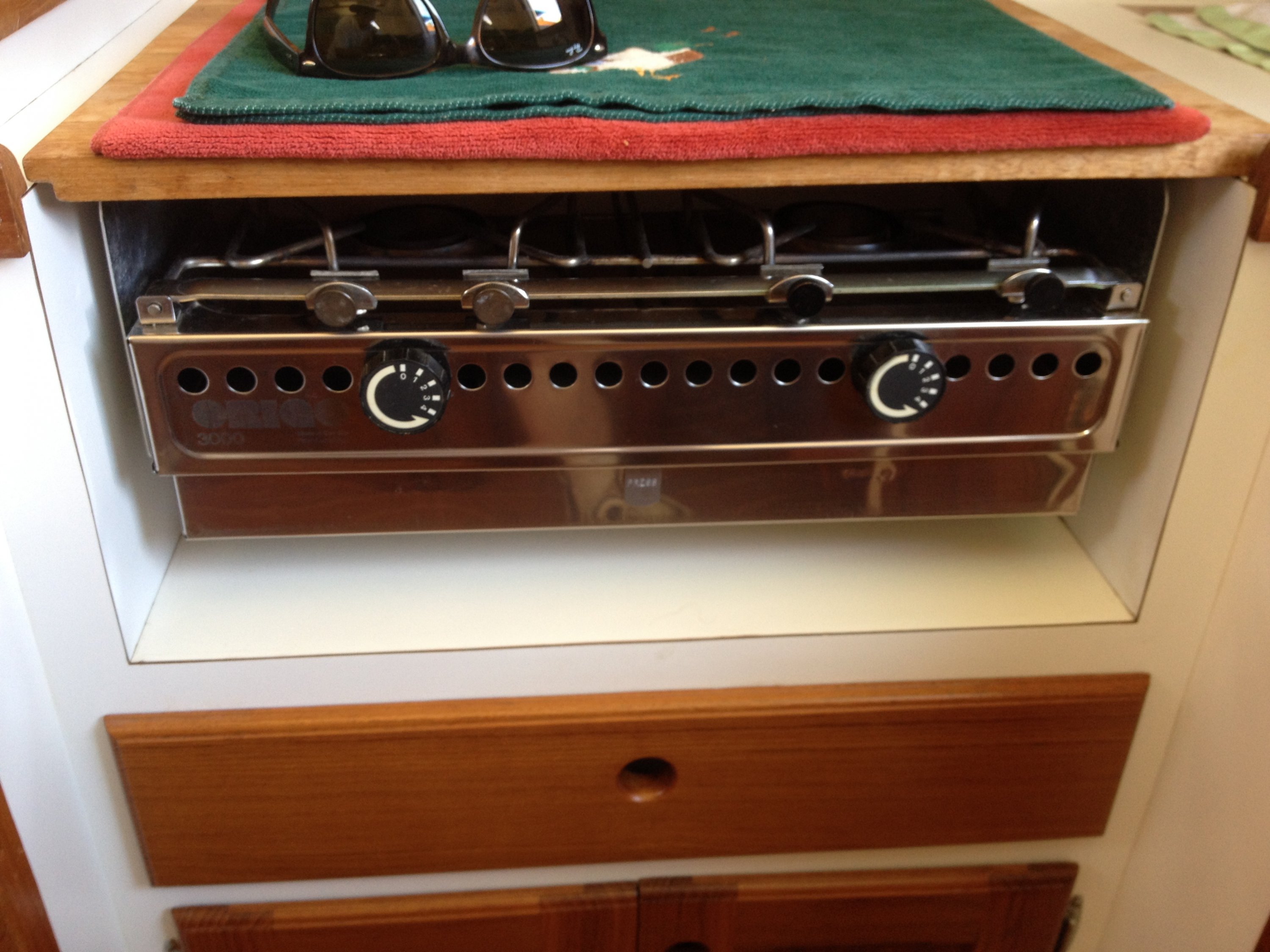

The non-pressurized alcohol cook tops are an excellent choice. Had a single burner Origo 1500 on my previous sailboat and now have a two burner Origo 3000 with pot holders. I think their patent has expired as there is the much cheaper Chinese Cookmate available now. Buy menthol hydrate at you local hardware store for fuel.
Remember a couple of things:
- Get the pot holders.
- Get all of your pots the same size.
- Replace the rubber gaskets when not using the stove.
- Fill the canisters on the dock or in the cockpit NOT in the stove.
- Decant the alcohol / menthol hydrate fuel into properly labelled ½litre or ¾litre water bottles for easy filling (empty canister takes one litre of fuel).
- Use long-reach butane lighter to light it.
- Don’t let the burner fuel run empty or you will burn the wick material.

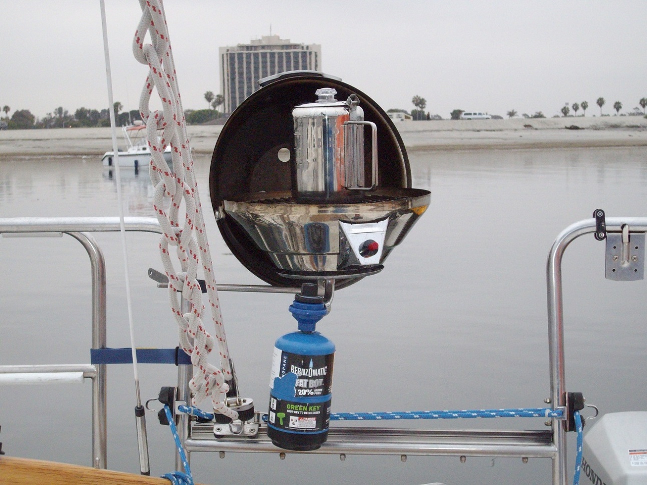

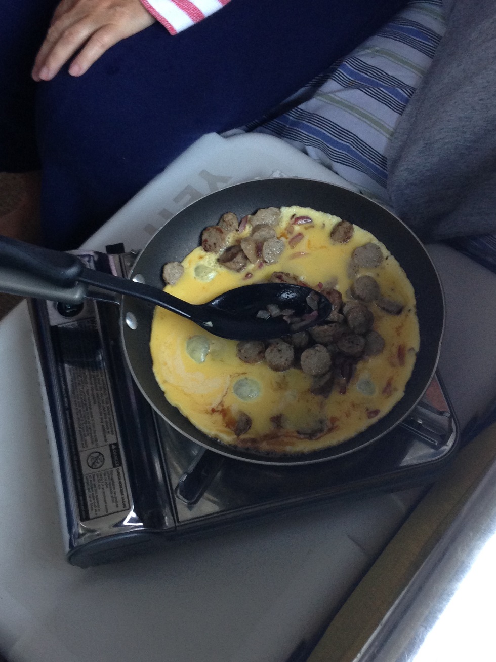

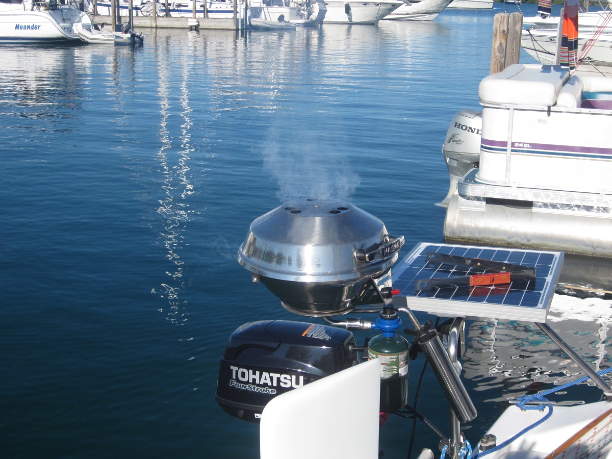

I'm with Gene Neil, never understood the paranoia with butane or disposable propane bottles. Oh yeah, I've heard all the horror stories, just never had any issues, and some common sense goes a long way. We cook with a fully gimbaled propane stove that mounts to the compression post, a single burner butane stove that we set up in the companionway on top of the cooler, and a propane Magma grill that fit's into the fishing pole holder on the stern pulpit. Our butane stove came from Costco, Stainless Steel and was $26. Bought 5 of them, and sold 4 for $50. a piece.

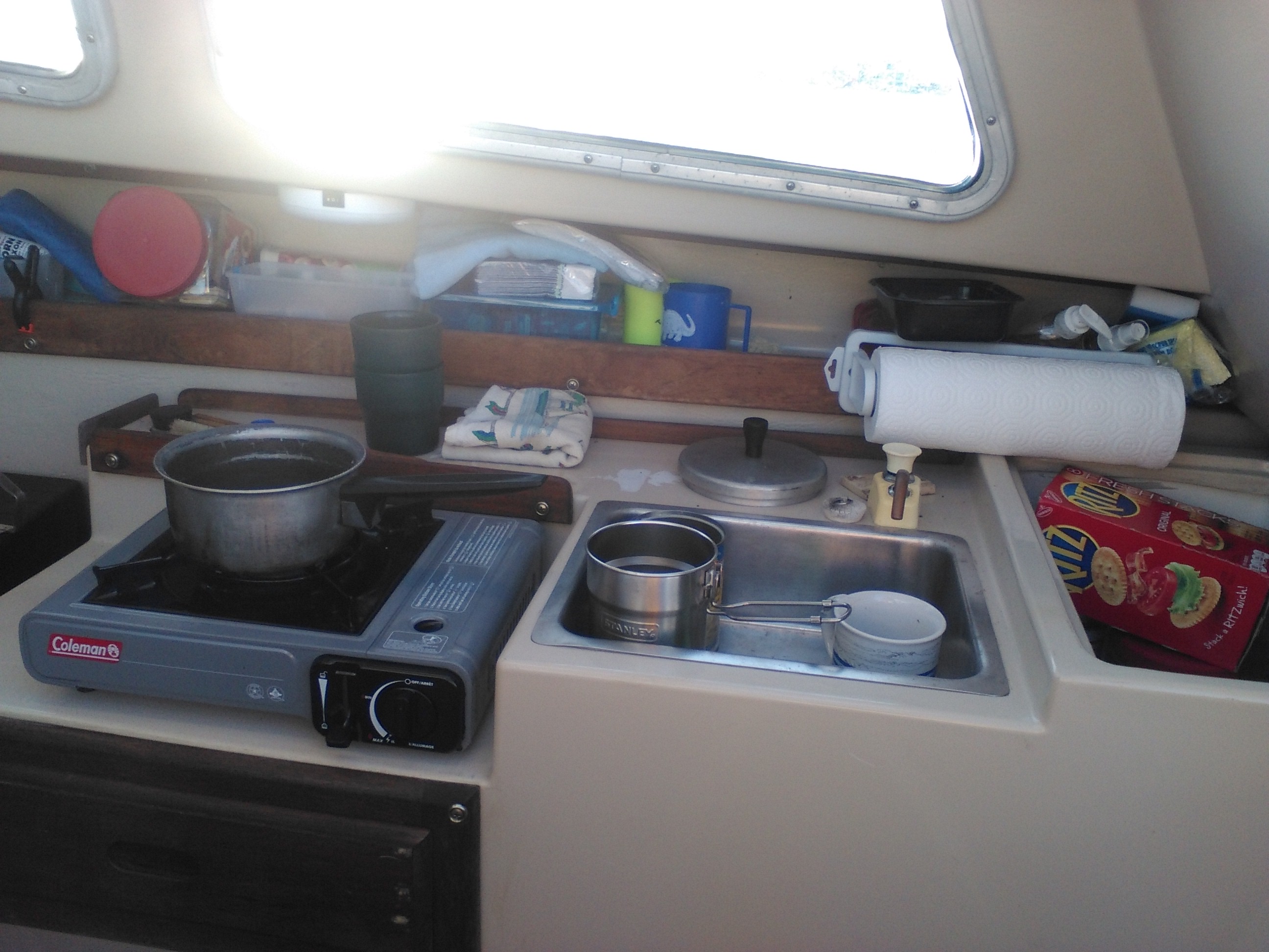

I am on board with the little bistro propane/butane stoves, about 20 bucks for the coleman model and cans are like 2.
50 at walmart and last 4-5 days at least.

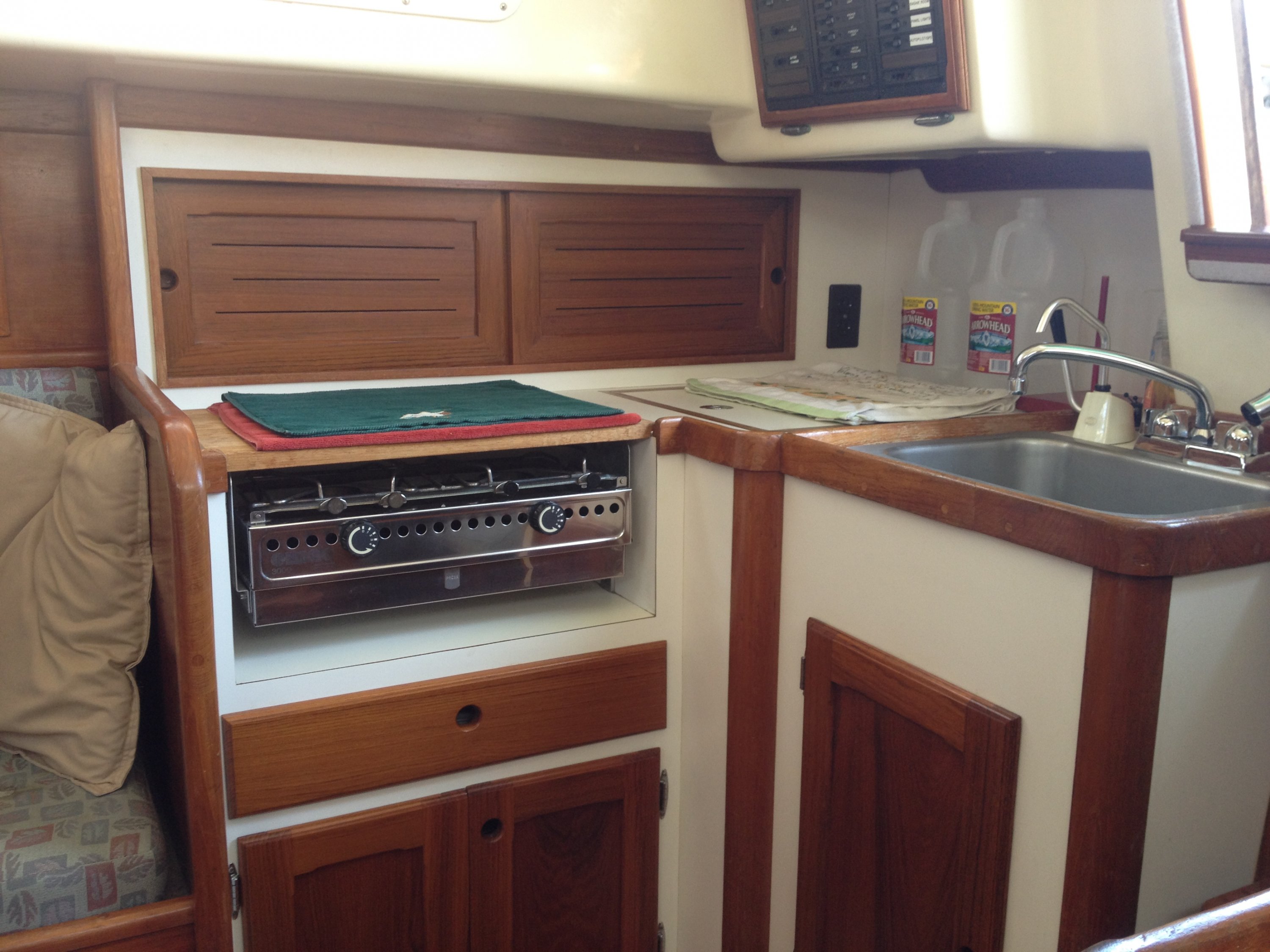

I'm the Origo fan from earlier.
In the long run, alcohol fuel is a giant amount cheaper than butane. $5 a quart which would last a month on a single burner Origo, cooking 2 meals a day for one person.
Also safer.
And can be used in any sea state a good navigator would ever allow himself the possibility to enter.
However, due to others' posts, I'm starting to see the value of a brand-name butane stove, --- in a Catalina 22.
Because the reality is that you're not going to be living aboard nor sailing abroad, so the fuel cost increase won't add up that fast. And you're not going to be cooking in rough weather, so gimballing may be superfluous.
As long as you can secure it to the boat, secure the cookware to the stove, ventilate the cabin, and handle and store the fuel properly, on a price point I'd look hard at the butane stove.
Edit: My Korean wife uses one to cook certain Asian things on the back porch, to avoid smells in the house. :)
And I can say that the stove cooks as good as any.

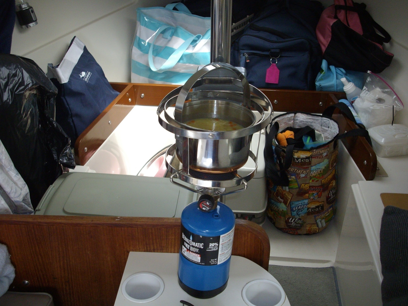

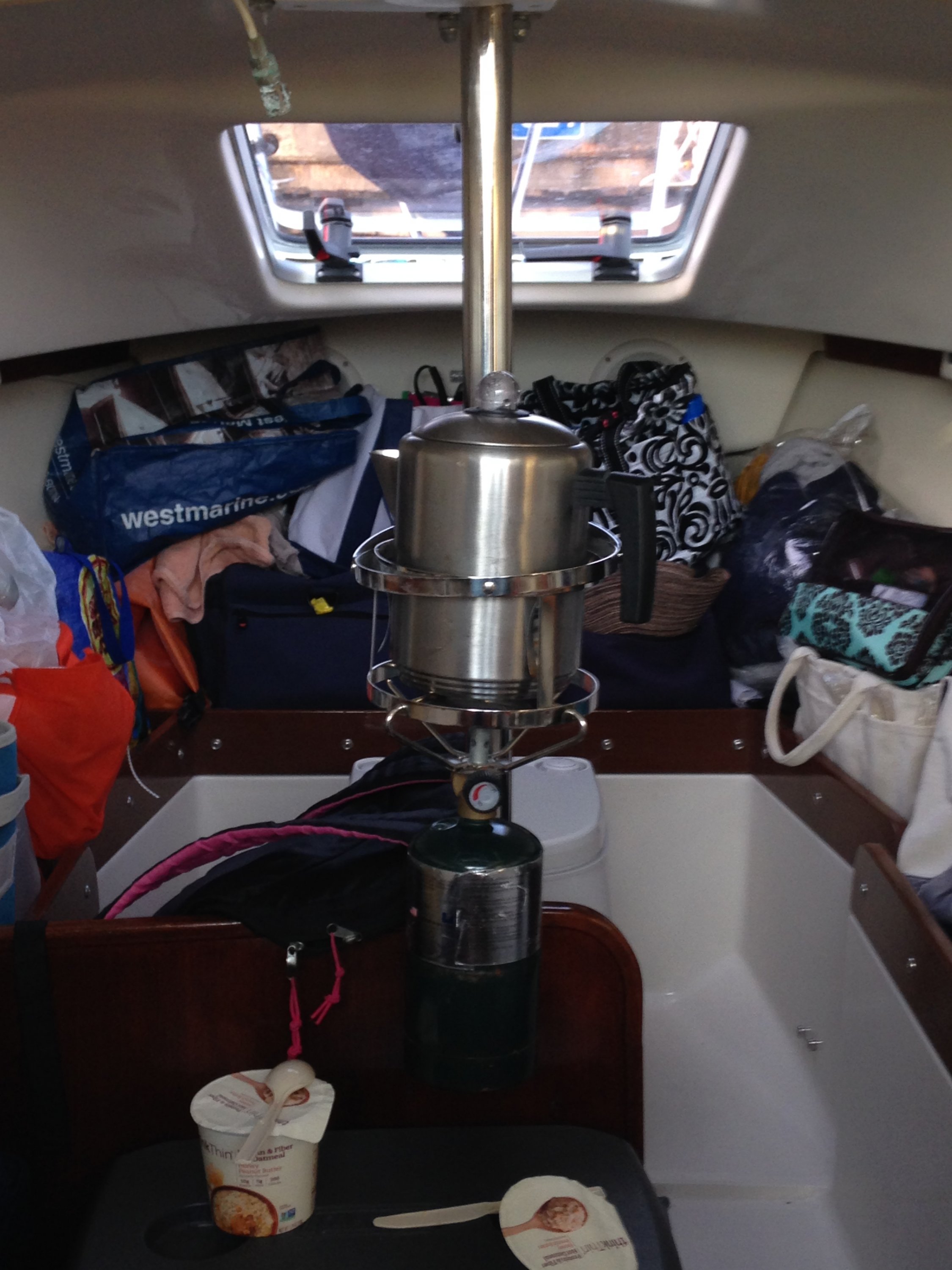

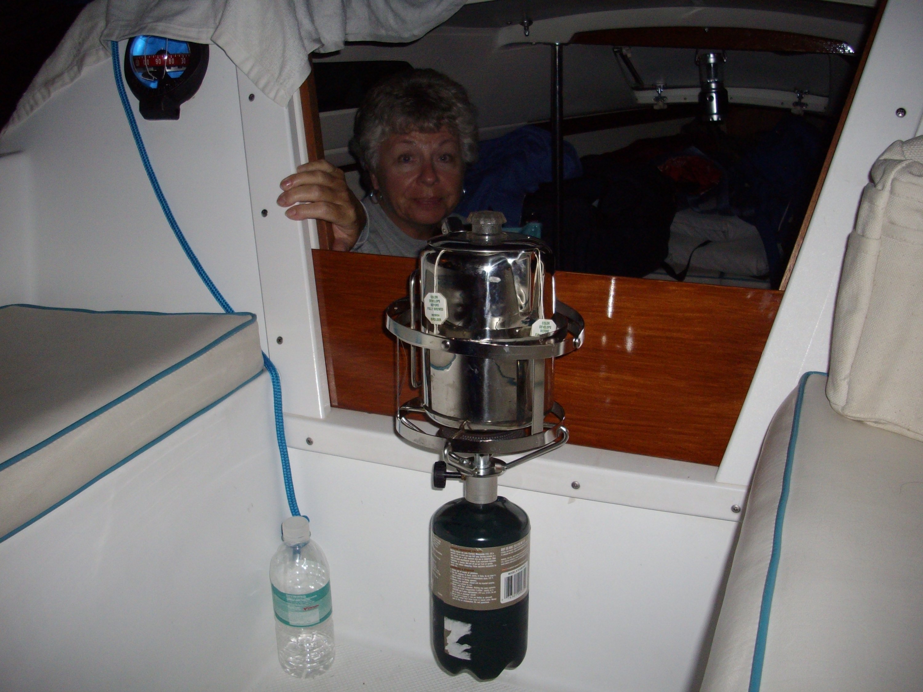

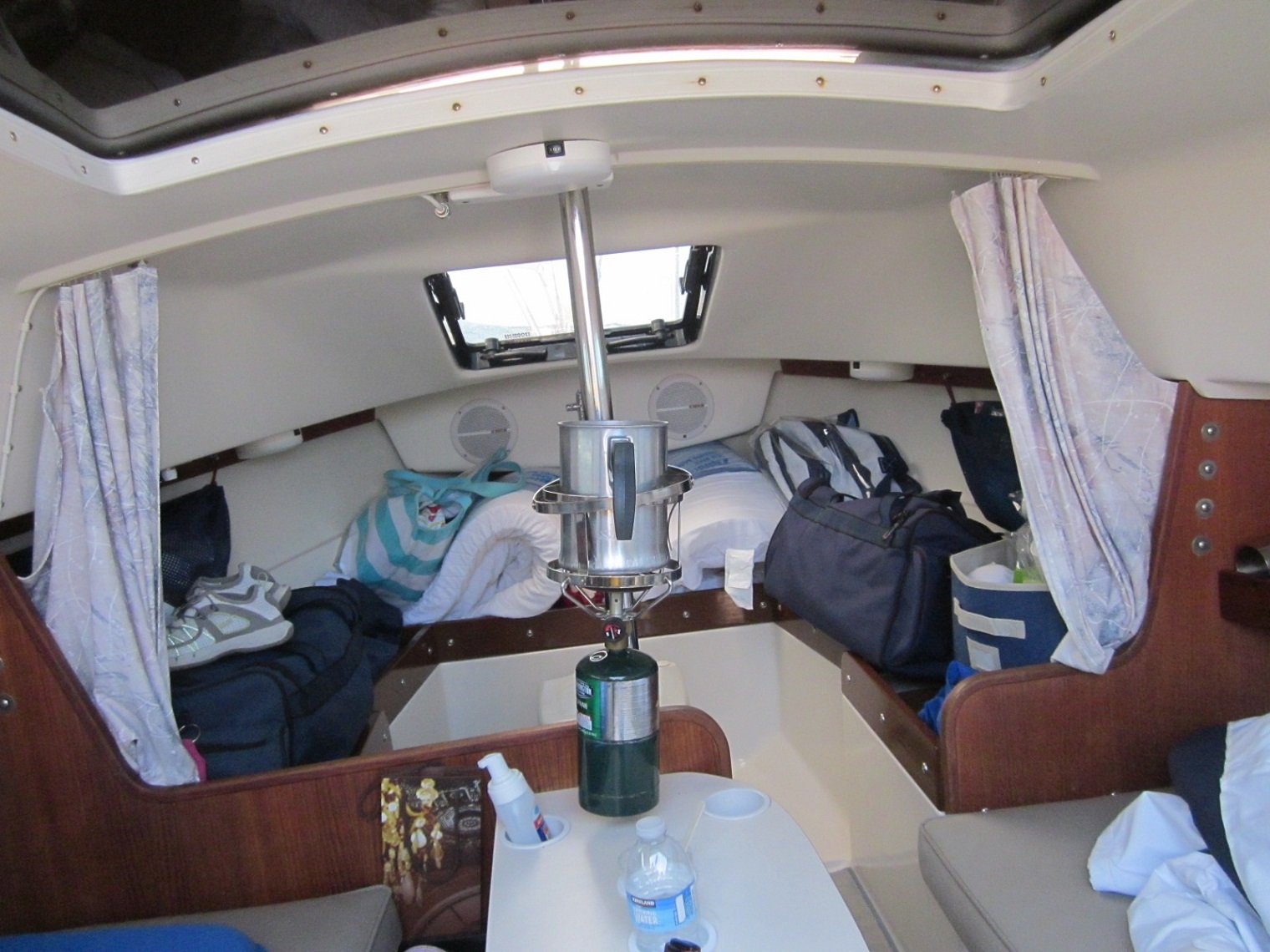

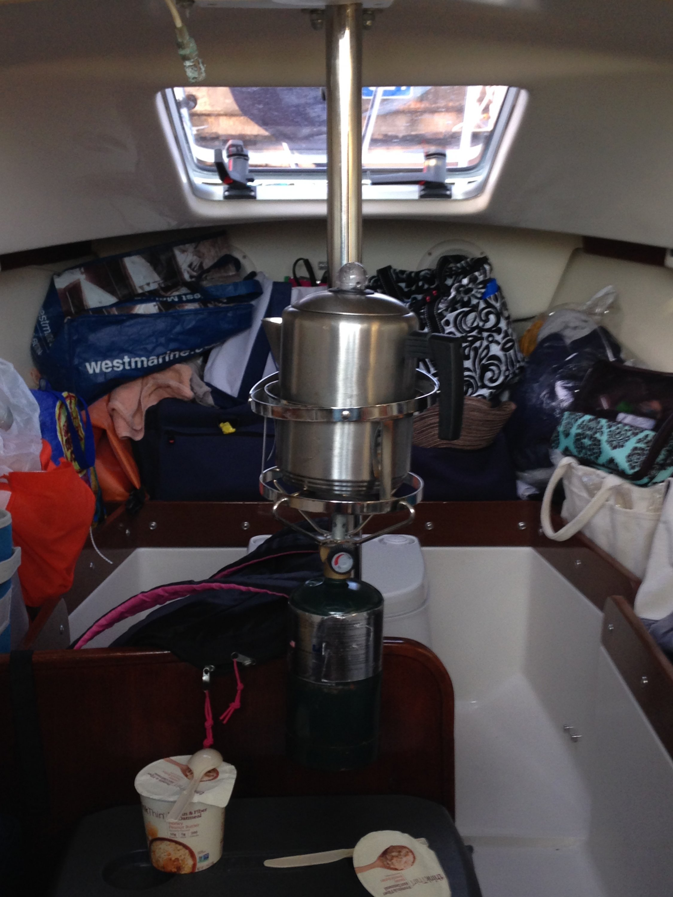

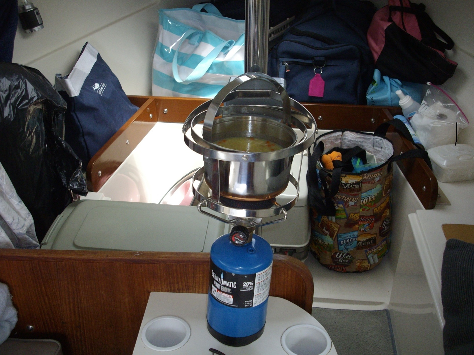

"And you're not going to be cooking in rough weather, so gimballing may be superfluous."
Skipper,

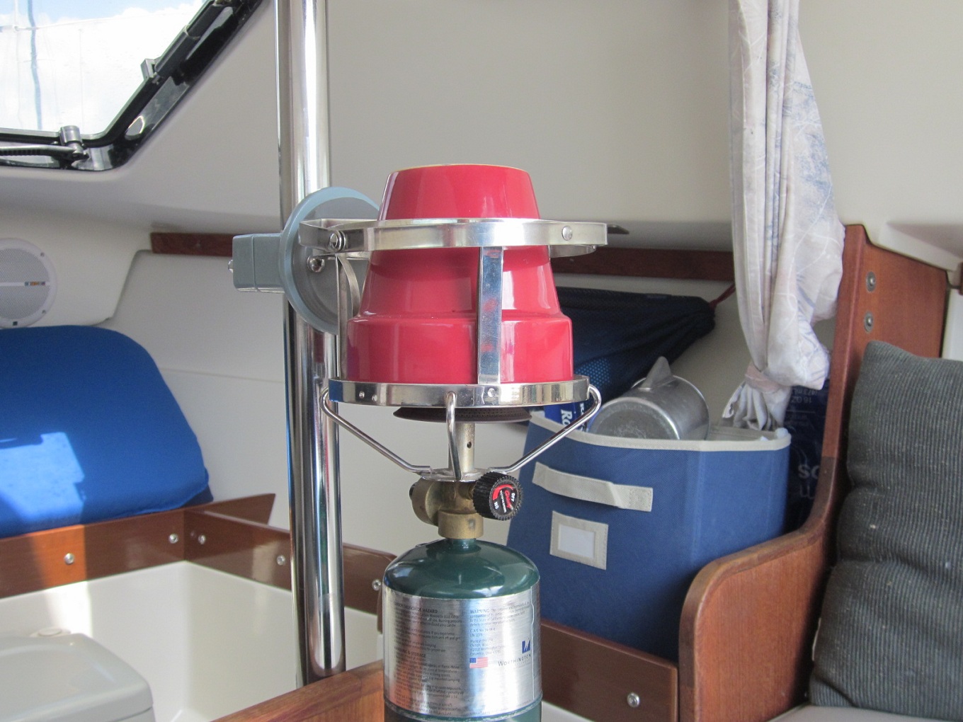

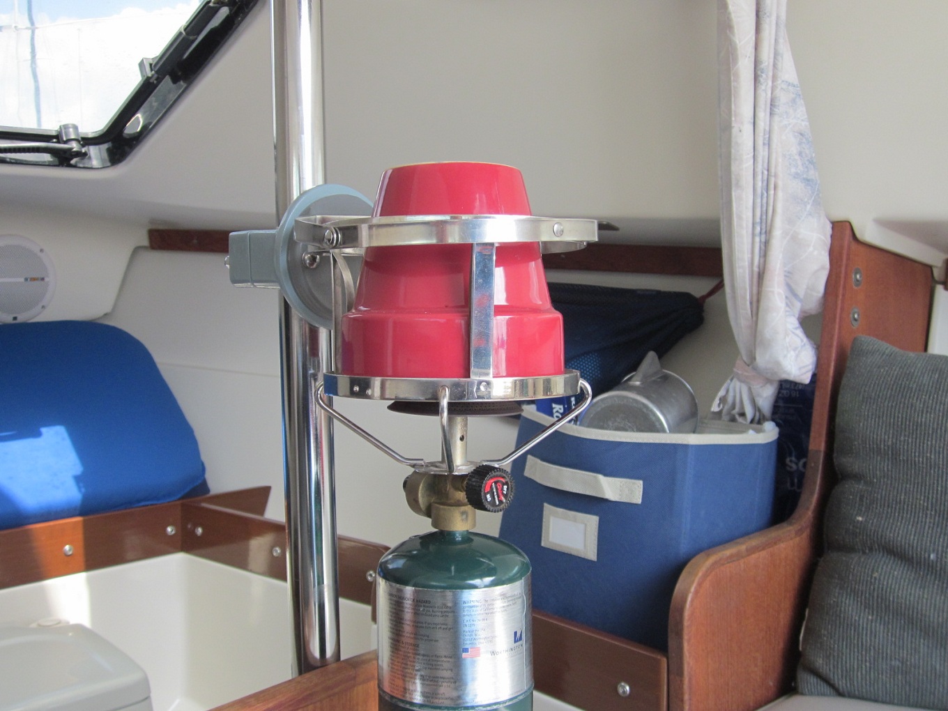

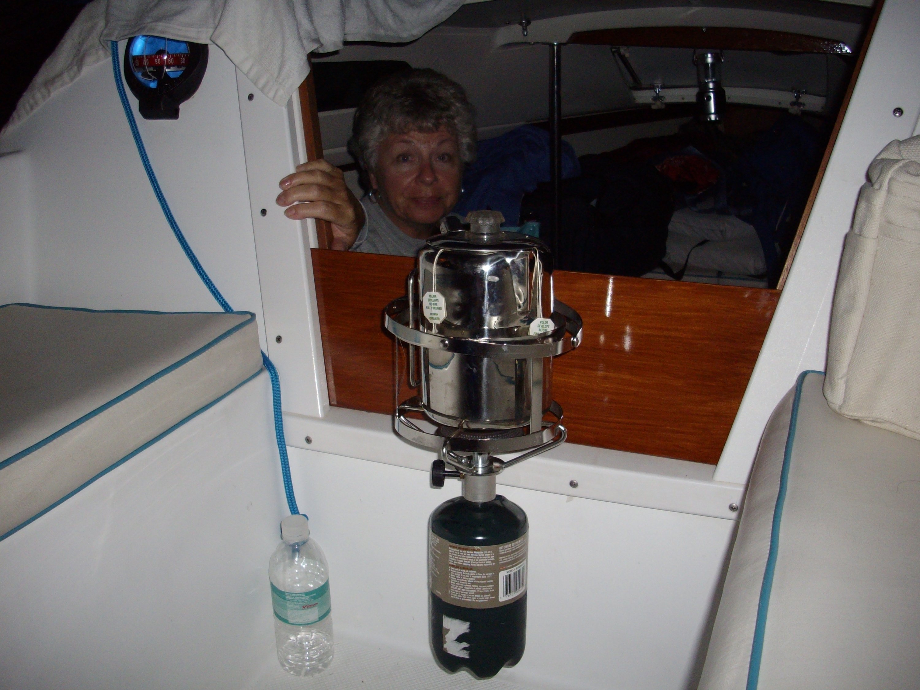

I would have to disagree..... A fully gimbaled stove is very useful for safely brewing a pot of coffee, or making some early morning oatmeal while underway, or taking the chill out of the cabin on those chilly Southern California nights on the hook, or heating up some mid-day soup or stew on that day long journey from Dana Point to Catalina Island.
We also found our fully gimbaled stove handy on those sailing trips to Catalina Island on our Capri-18 also.

Agreed. I said as much earlier.
I said, "may be" superfluous. :)
IE: if he only cooks in slip or harbor (flat) anchorage. Or even during a smooth sail.
I had a non-gimballed pressurized alcohol stove on my Capri 26, and with pot holders it did fine in favorable conditions. Just a little more sloshing but no spills - in favorable conditions.
He'll have to decide, based on his use intentions.
