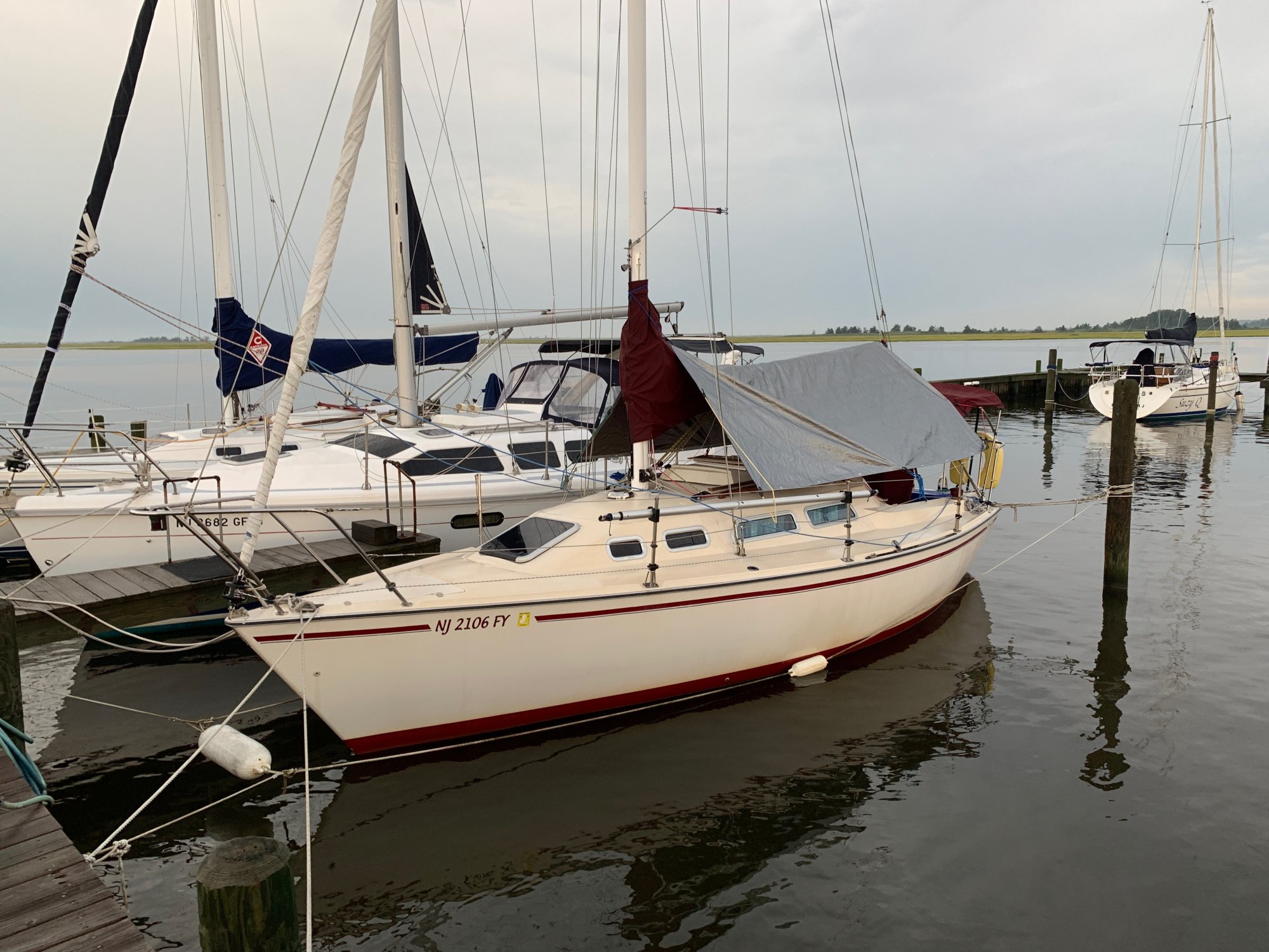

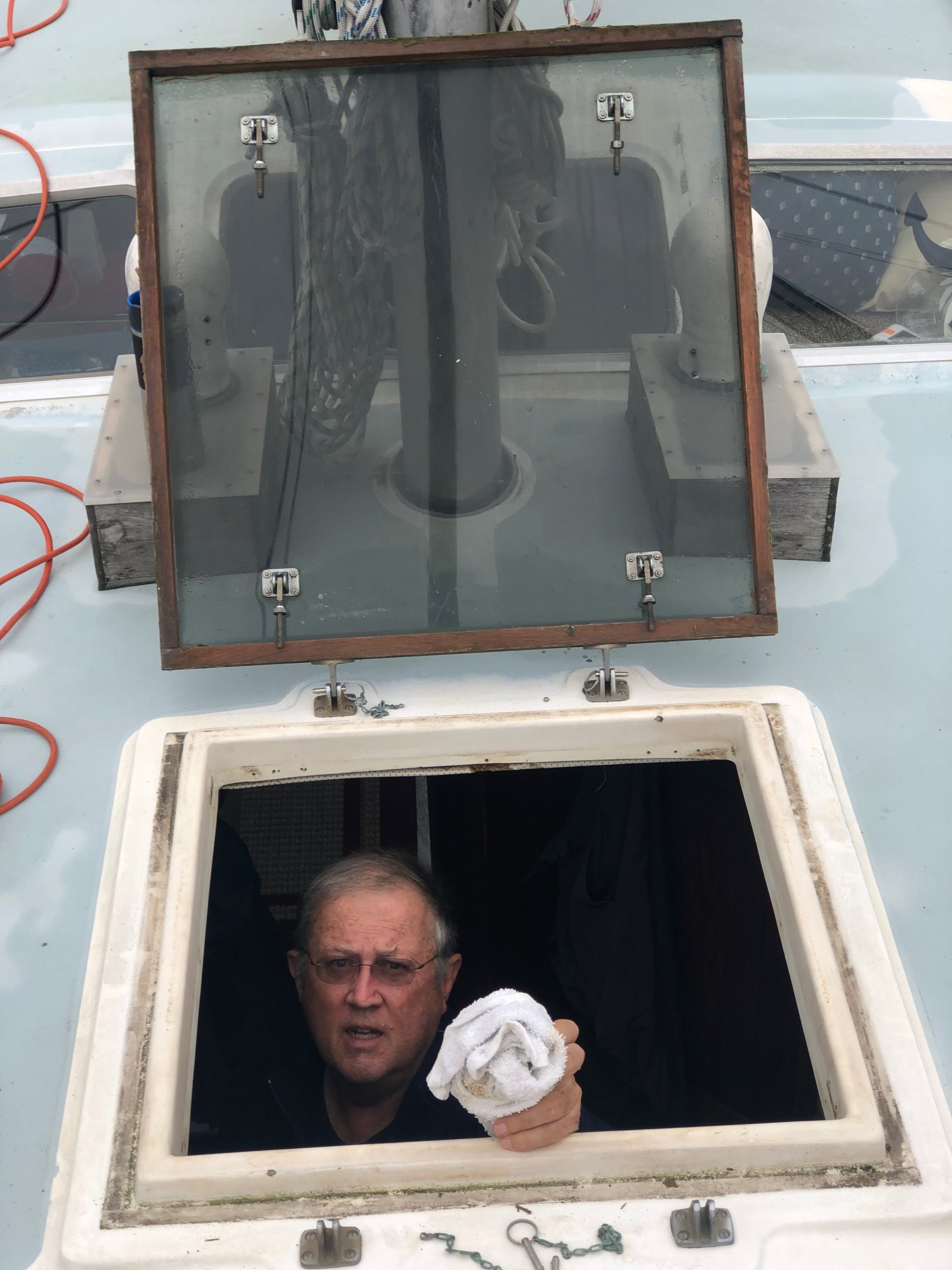

I want to replace mine with a very good quality hatch. About 14 years ago I replaced the original Pompanette-Gray plastic POS with a Bomar extruded aluminum hatch, as seen in the picture. It leaks and the stays failed relatively easily (the metal stripped where the dogs are connected). I made satisfactory repairs with screws that are more robust, but the hatch also leaks - always did. Admittedly, I did a crappy job at cleaning and sealing the flange area around the cut-out, so I suspect the leaks are on me.

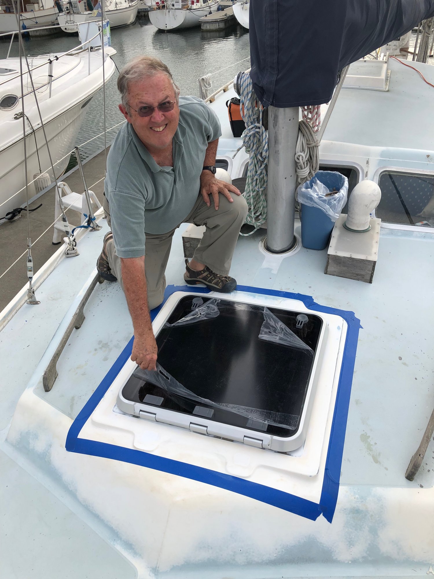

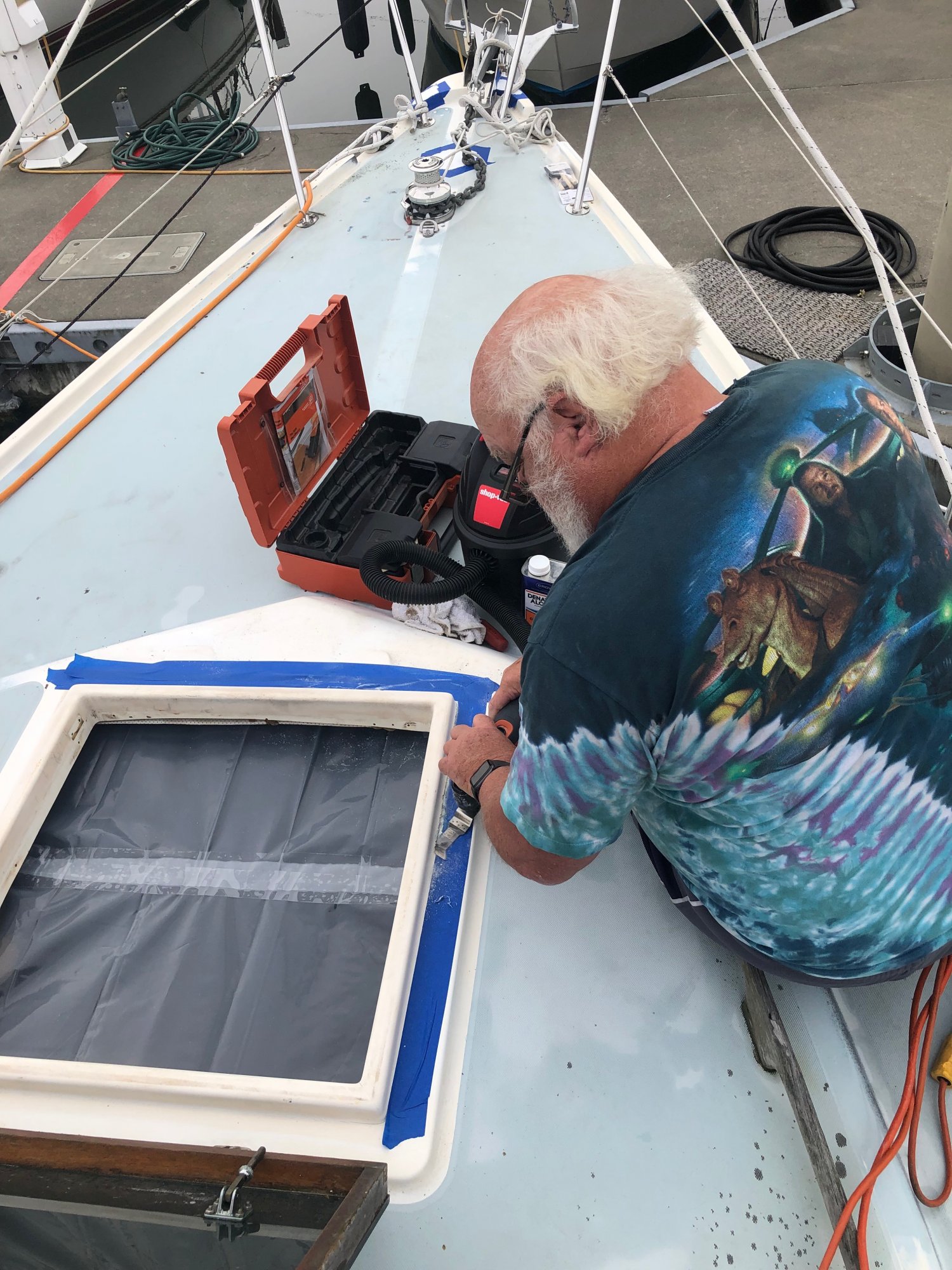

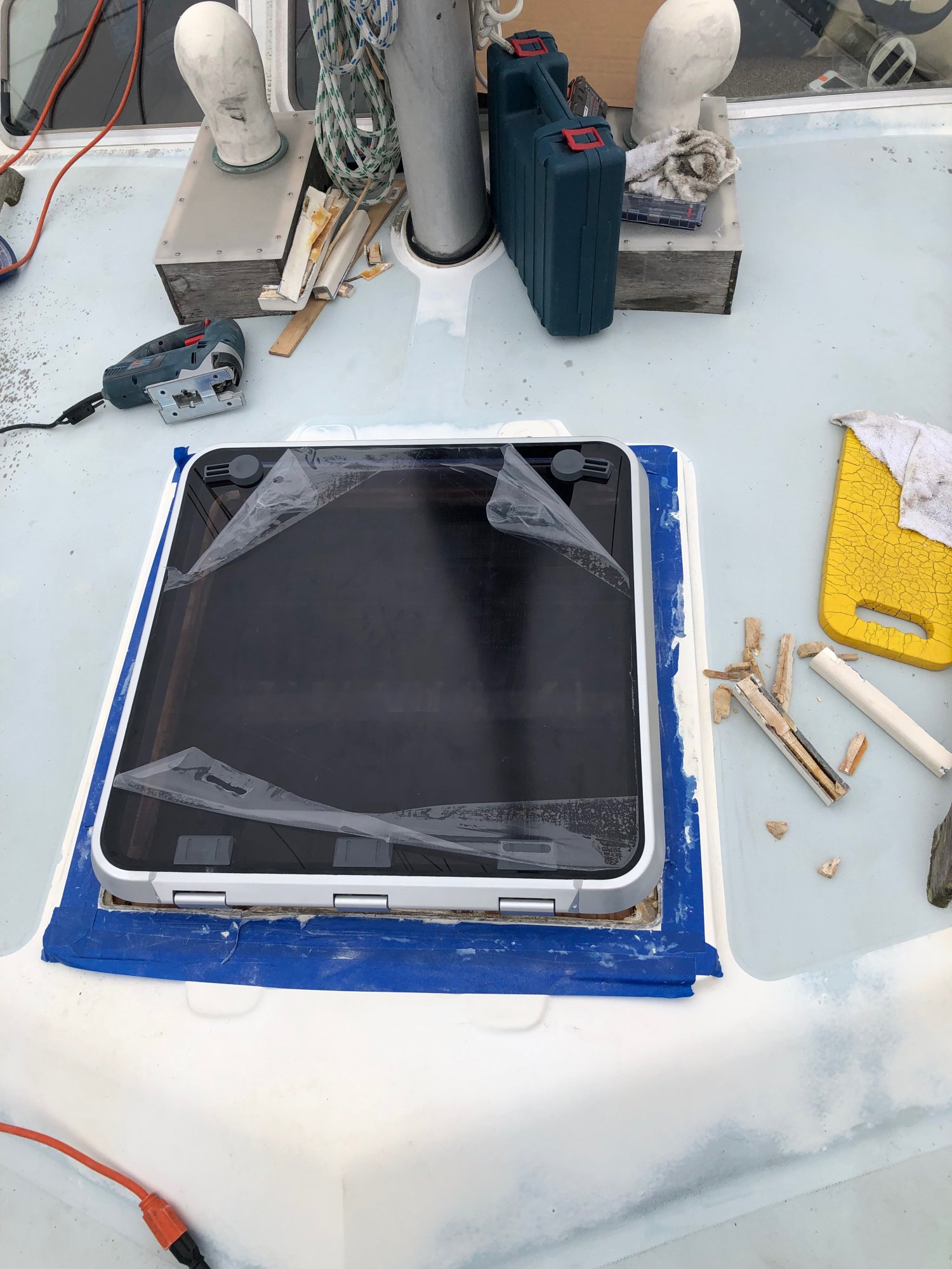

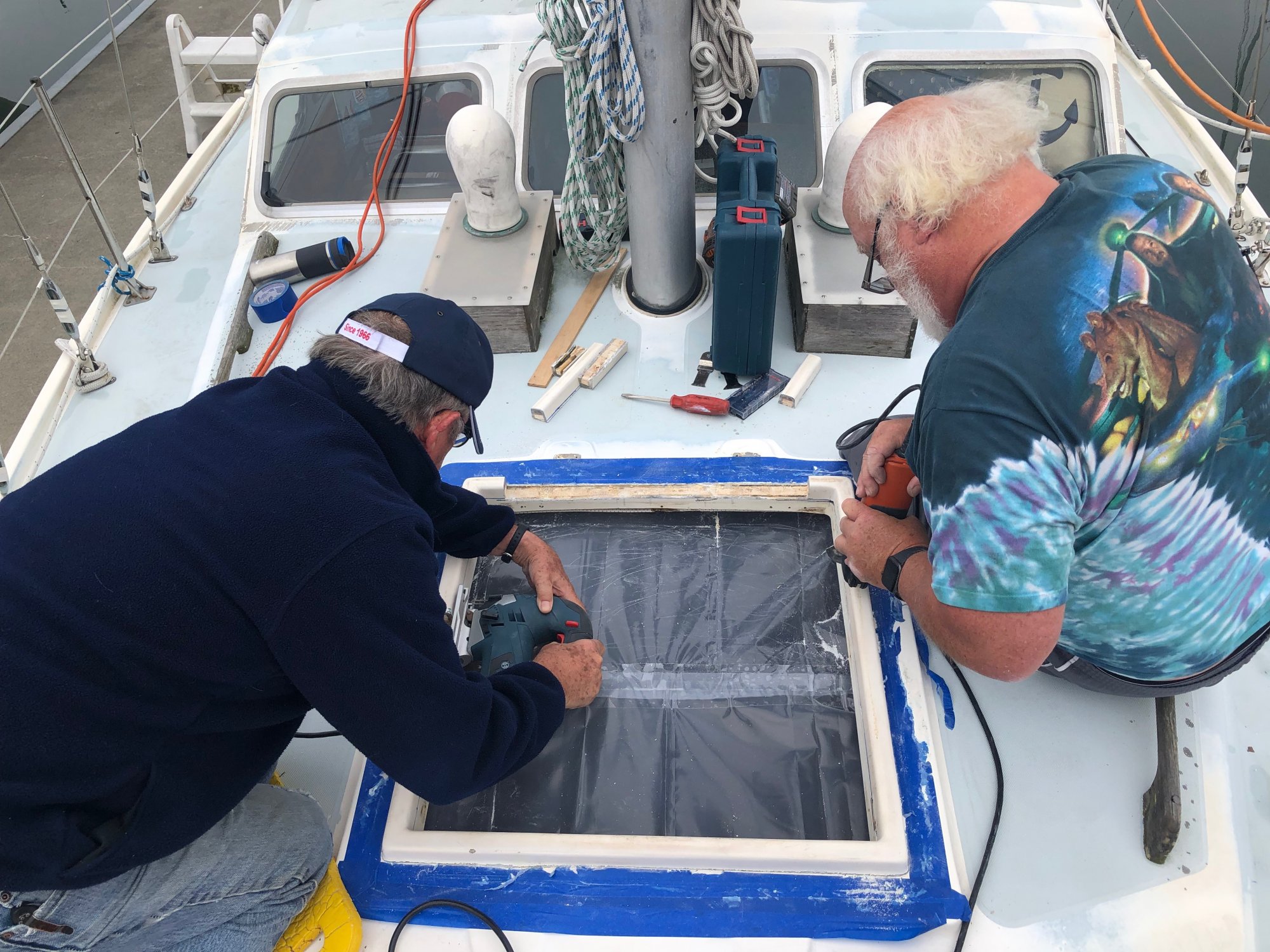

Hi Scott. I installed the Lewmar Ocean 70 this fall. Chose the design with the flange rather than the flat deck. Lewmar really stresses the need for a flat deck where install is going. Check the radius of the corners that it will match your rough opening, or you will be doing some fiberglass work. My Old hatch was square. Made of wood, the plexiglass was crazed, and the frame was starting to separate. Two options. Replace or reconstruct. Not liking the flimsy hardware holding the hatch , I chose to replace. Spoke with the Lewmar folk at Annapolis Boat show and they shipped one to the house.
It required serious modification to fit the new Hatch.
Once cut up and new fiberglass corners filled into the deck installed, sanded flat, gel coated we tested the fit...
Serious happy cheers...
We got around to the final stage, counter sinking the screw holes, gobs of bed-it butyl, careful setting and tightening. Watching with satisfaction the butyl ooze out the edges.
Then the final step, peeling back the protective cover...
Just before the rain set in.
Woke the next morning with a pesky drip. The hinge below my hand in the above image dripped. We removed the screws and the flimsy piece of thin foam used to seal the plastic hinge. Replaced it with butyl and resealed the hinge.
2 days later after torrential fall storm wind and rain squalls, the inside was dry as a bone. I really like that hatch and feel much safer thinking about sailing out into an unhappy sea.

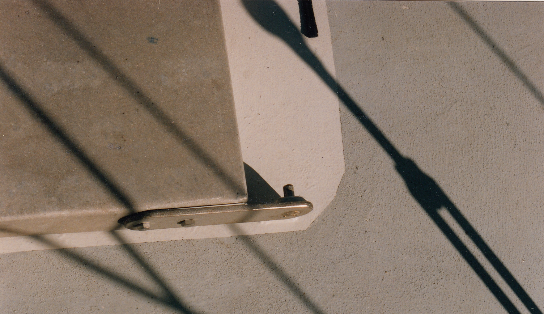

Trouble free , build your own, aluminium fore hatch . Sorry, I don't have a picture of the whole hatch, this is to show the hinges, but gives you the general idea.
