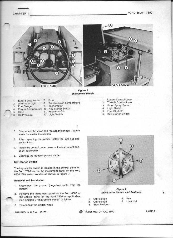

On my 40 year old backhoe I just squirt some ether in the air filter and don't bother to prime. I get a smokey start every time.

My understanding is you never use ether on a diesel...
Installing the primer bulb outside the engine space is good but remember, they are not rated for any interior use.

That's only if you have glow plugs. Because the glow plugs could cause a pre mature ignition when the ether hits them. And in turn blow the head gasket.
