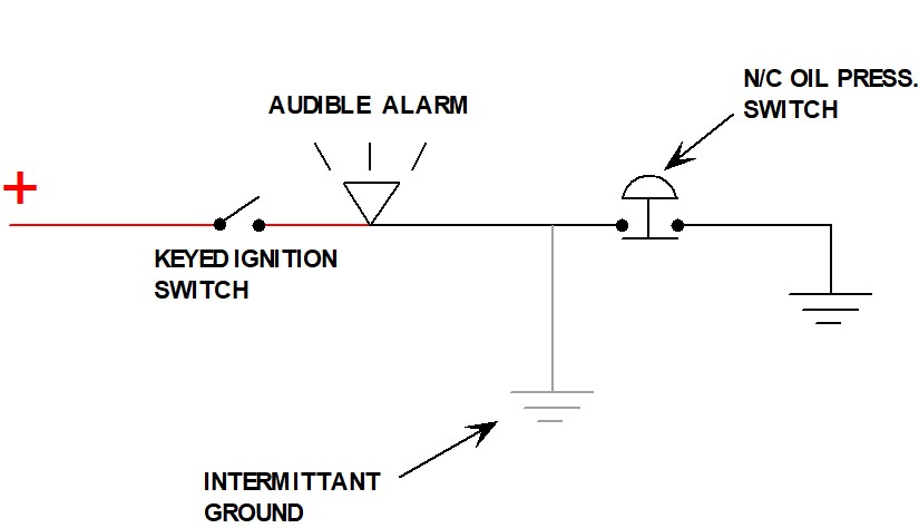

What you have is NOT a loose wire or a corroded wire, but a wire with an accidental ground that is providing a path for power through the alarm as shown:
Without this accidental route for power to go to ground, the alarm cannot chirp.
Your search to solve the chirping problem should be for a chafed wire which is providing this intermittant (accidental) path.
