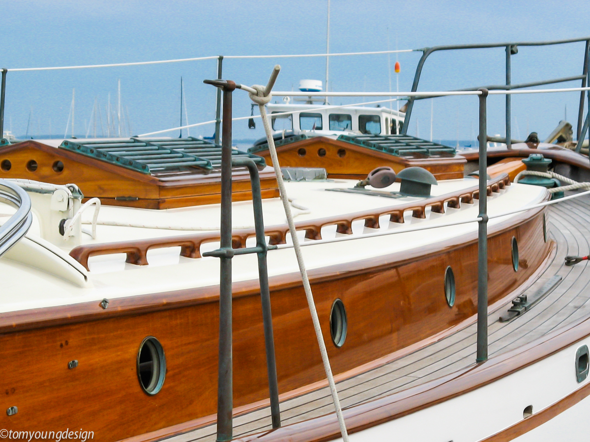

Interesting combination of current forum threads.
One, how to repair chipped varnish. The other, Why shouldn't I let my teak go gray?
Great nugget of info from the person who said, "If you're not sure what you're doing, don't!" Let it go gray. Grey will outlast cupping and chewing wood up to 'prep"
You should do very little sanding in varnishing, even (especially) if you have to take it back to 'wood'.
Last I knew, this boat is approaching 100.

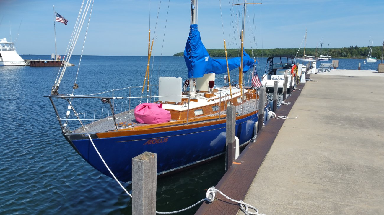

toe rail, what are toe rails? they are a safety feature. they are to give you footing on a heeled over deck so you do not go overboard. that said, you might choose to have max grip for your footing. that might not be a varnished toe rail.
option 3: varnish the top and outside to the toe rail and leave the the inside face natural
that's how we roll on aeolus :cool:
