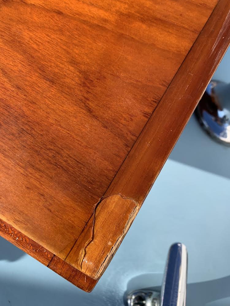

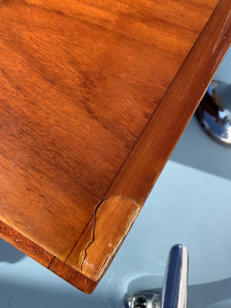

Unfortunately, one of the weather boards fell and a piece of varnish chipped off. Do I need to take off all the remaining varnish and rebuild all the coats again or can you “repair” a corner like this?
13,069
This can be repaired. Do you know what varnish was on there?
The process is simple. Using some fine sandpaper, 180-220 feather out the chipped edge and the area that is missing. Clean out all the dust and debris and build it back up with multiple layers of varnish. Best if you used the same varnish, if not a good quality varnish will do, Epifanes Gloss Wood Finish is my favorite. Jamestown Distributors TotalBoat Gleam is another good product.

Thanks. The previous owners used Interlux Schooner varnish.. I am glad I don’t have to strip the entire thing...

IMO, it depends on whether you want it to look the same, or be a lighter patch.
First I'd sand it gently and see if the wood will come back to the original color. Feather as above, etc. But if it stays light, you can stain it to match, then varnish.
You can fix it. It will take a long time to build up that 10 coat original build plus 36 annual maintenance coats..

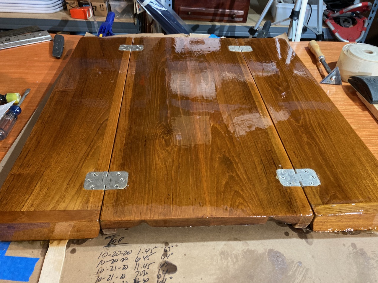

The varnish is the result of many, many, coats of varnish. Many more than the usual 3 or 4 coats most folks give varnish and probably given a maintenance coat every year. Over time the coats build up faster than they wear off.

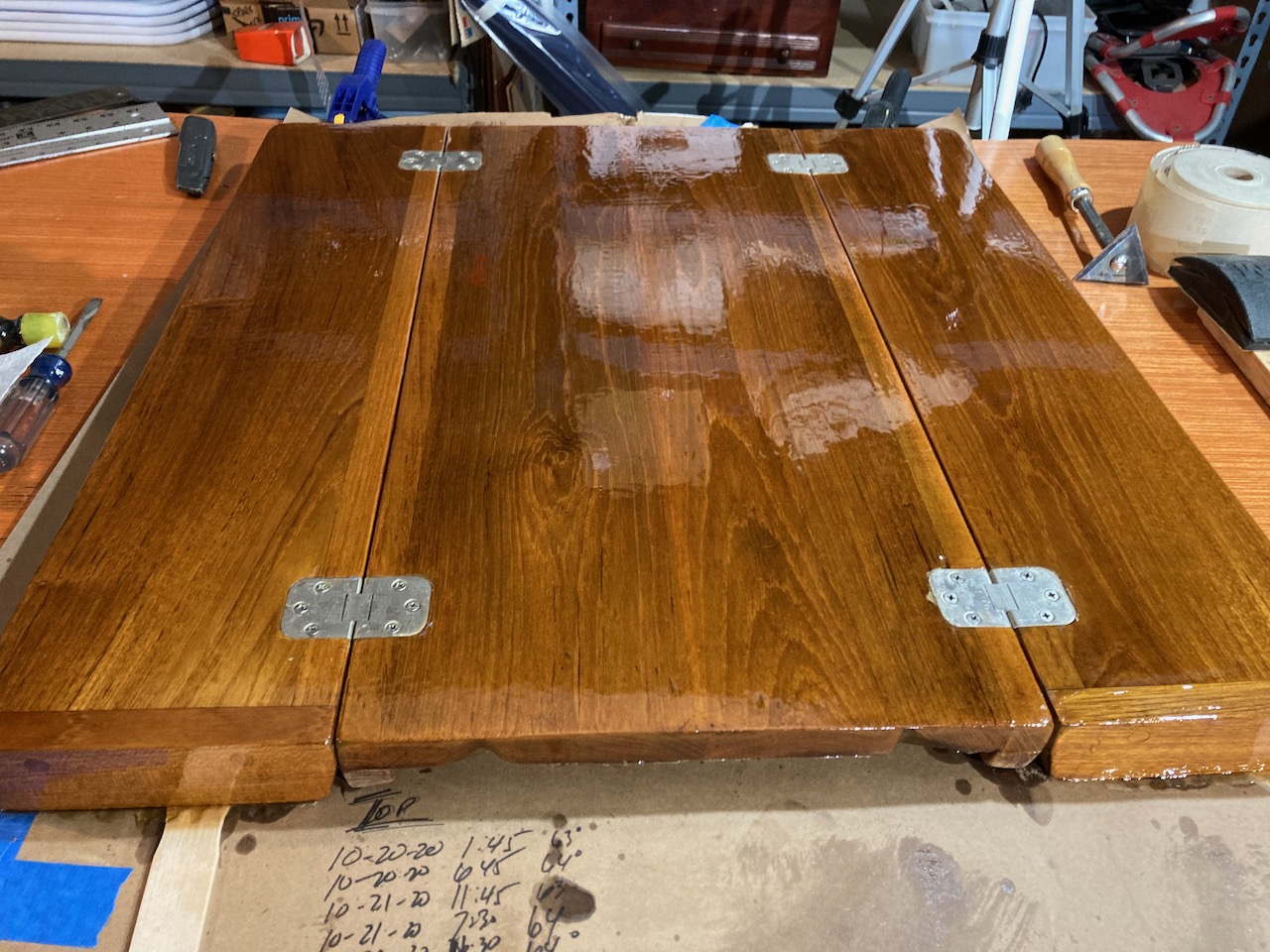

I am currently finishing a cockpit table. The more coats of varnish, the deeper the gloss and the longer you can go between maintenance coats. The table has 2 coats of sealer and 6 coats of TotalBoat Gleam Gloss varnish.

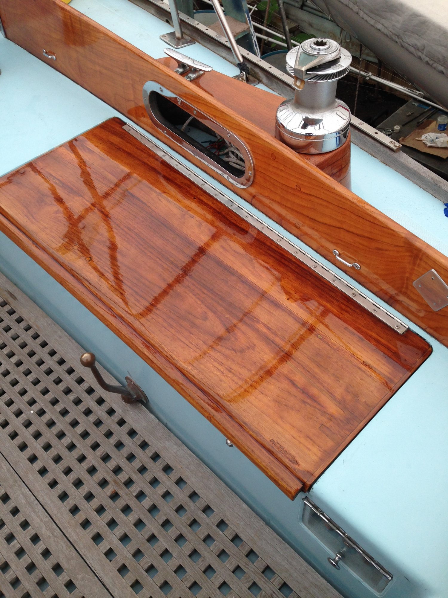

13,069

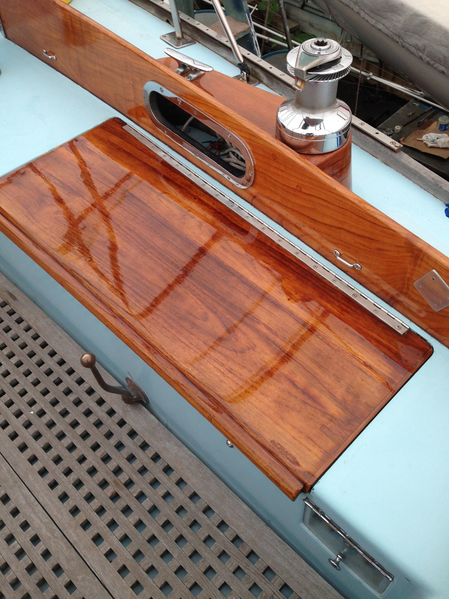

I think TomY’s description of the previous owner as a “varnish zen master” was close and that it is all truly varnish from years of care. Here is a picture of one of the lazarette covers he left me.

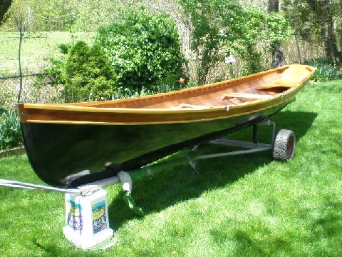

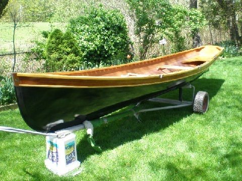

While I can see why you guys are saying that, I don’t mean to leave the impression that he didn’t love to sail her too. He was just one of those amazingly skilled people. This is a 17-foot “pulling boat“ he made in addition to 4 wooden kayaks. He installed a sliding seat in the pulling boat so he could row around Long Island Sound like a sculler.
We have had a lot of fun sailing her this year and the varnish survived my mediocre sailing skills.
