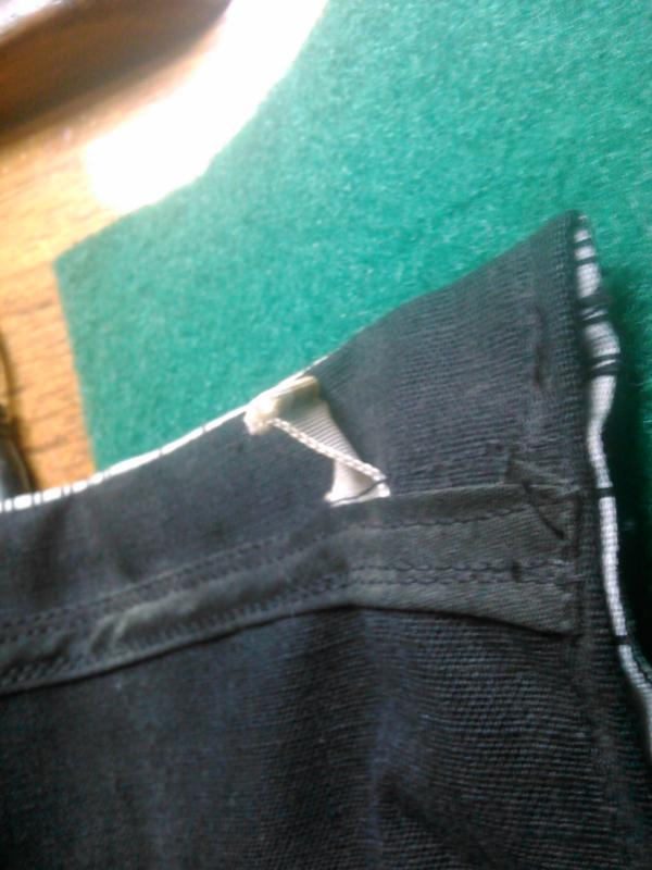

I still have the track and the slides on my 1980 Cherubini Hunter. I'll be at my boat tomorrow and will take a closeup pic of a slide. Maybe that would help you track down something that will work.

Kito: Picture of a curtain slide attached. Essentially they are nothing more that a type of "piping" cut into say 1/2" lengths. The tab part is sewn onto the curtain fabric. Sort of a miniature version of luff tape on the luff of a roller furling jib. The pipe diameter is about 1/8" before the fabric is wrapped around it. It's quite possible that sewing stores might have something that would work. Probably you would need bring a track from your boat when you go shopping to check the fit.

Well I'll be darn. That's exactly what it is......miniature luff tape tabs sewn onto the curtain. Thanks a ton Rardi. Makes my easy first sewing project a little more difficult though :)
