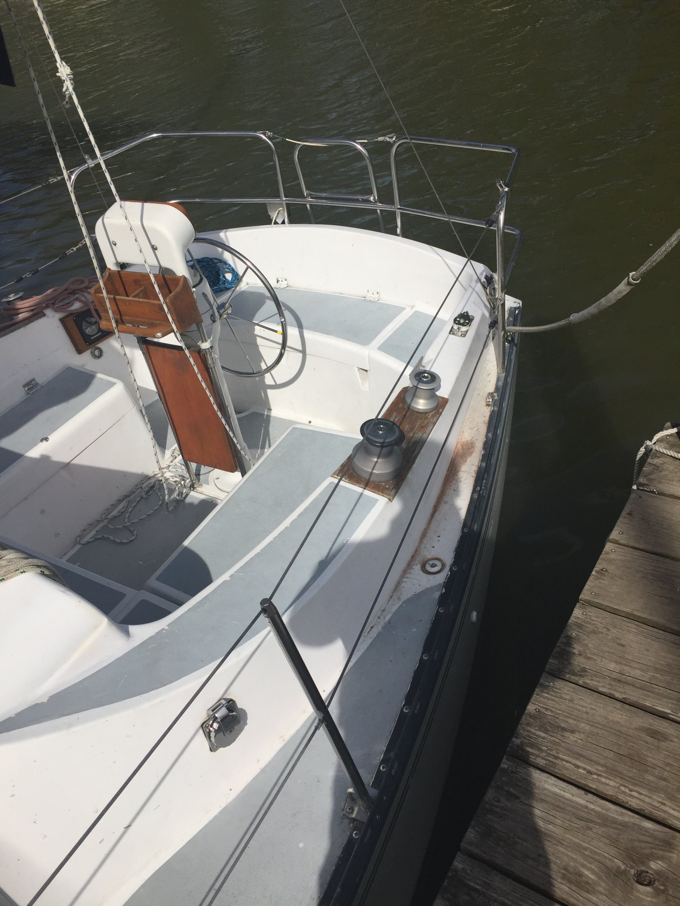

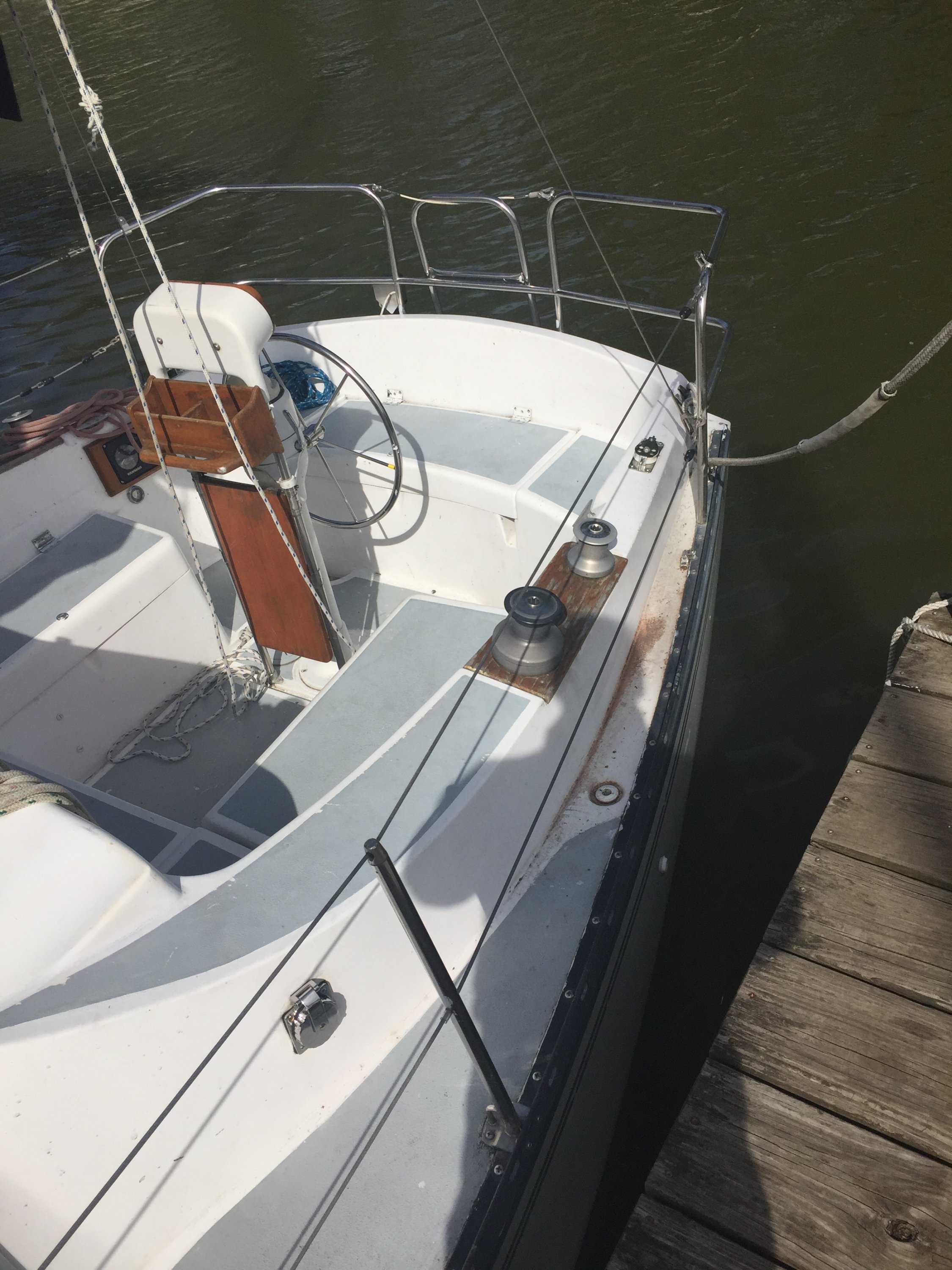

I'm the new owner of a 1980 30ft Hunter Cherubini and I have some questions about some of the rigging that the boat has installed on it by the previous owners. My previous boat was a 14ft Hobie-Holder dingy so the learning curve here is pretty steep. I have a roller furling Genoa and the sheets run back to snatch blocks attached to the toe rails. From there I have run them to the winches mounted back aft, but I'm now wondering if I should be running them first to the cheek blocks mounted aft of the winches. The boat also came with a spinnaker but again I'm not to sure about where and how this should be rigged. I will include a picture if I can.

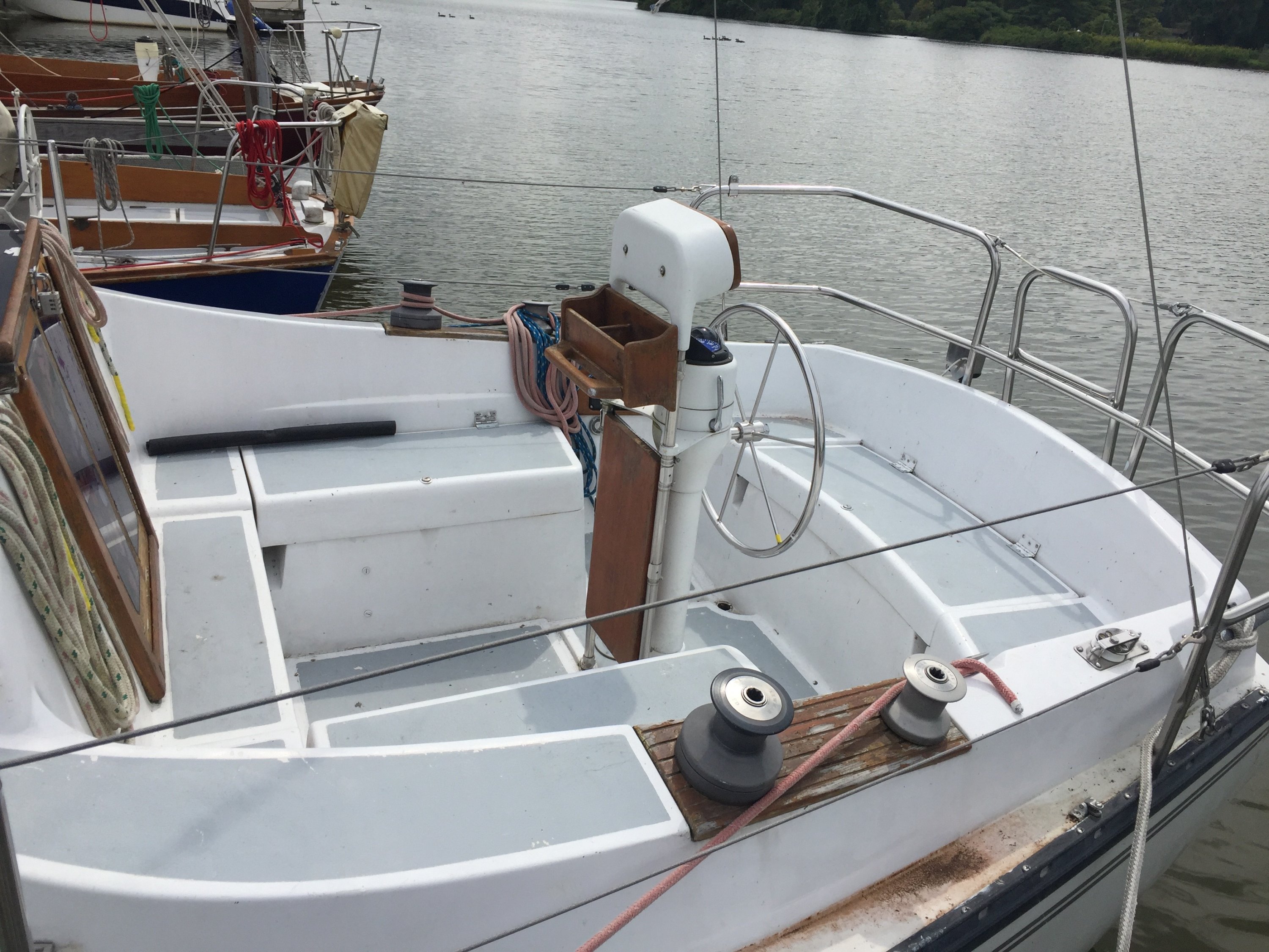

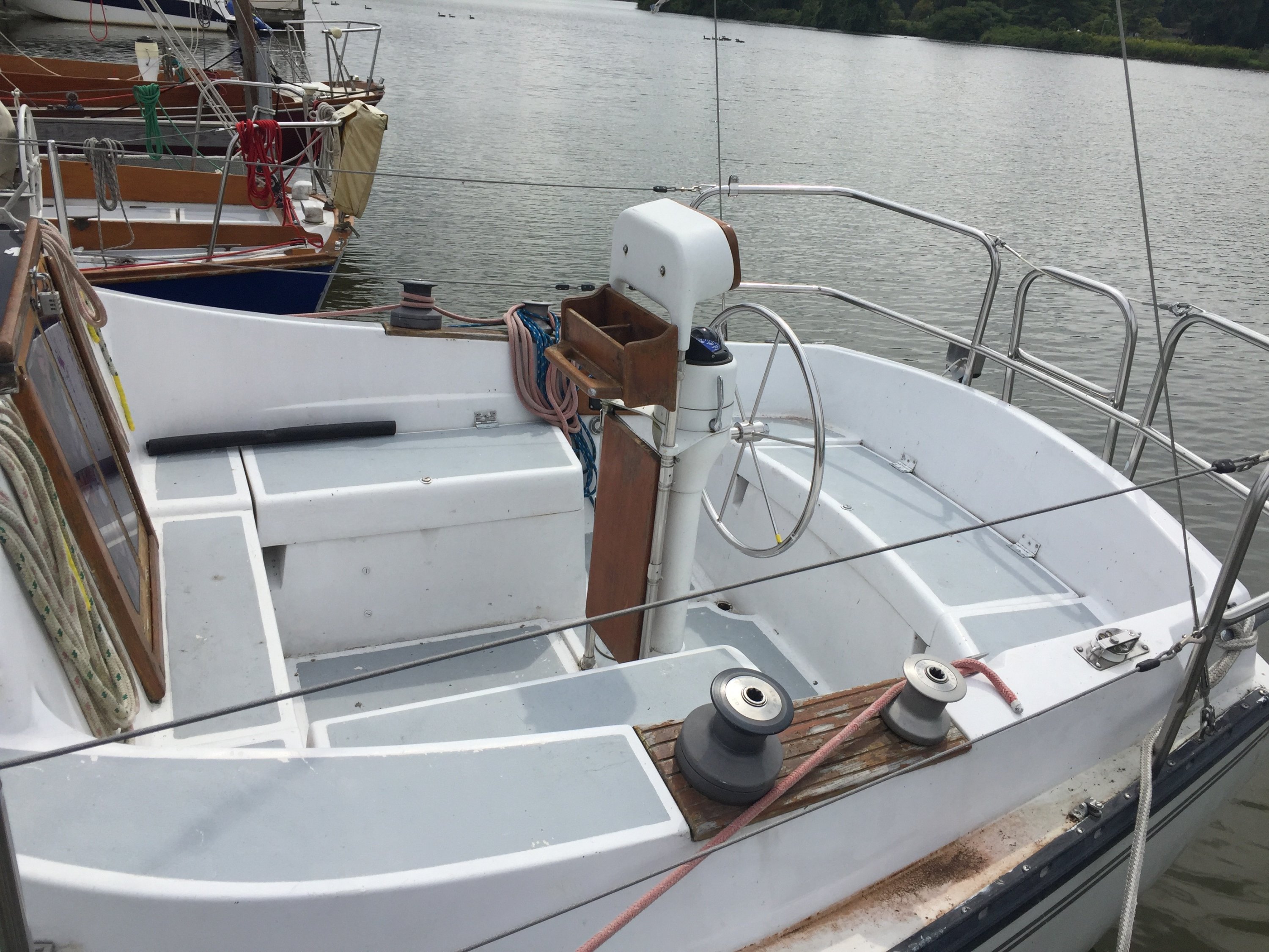

Welcome to the forum @Mohawk Jack. Looks like we’re gonna be neighbors this season if you’re staying on Cayuga. I am somewhat familiar with your boat and have seen it many times. The picture attached below show the simple and straight forward starboard headsail sheet running outside the shrouds into the blocks on the toe rail, and directly to the larger winches. My headsail is hanked on. The boat has a pair of sizable jam cleats on either side to run the sheet tail to once trimmed. I suspect that your aft most blocks are for the spinnaker and run back forward to the smaller winches when deployed. Where is your boat now? Parking lot at Treman? Perhaps I could meet you on a decent weather Sat. Or Sun this winter and we can take a look close up. Send me a PM and I’ll provide my contact information.

Welcome to the Cherubini forum. I'm a little late to this thread, so can't add much other than agreement with what the others have have already said; the cheek blocks and smaller aft winches are for spinnaker sheets rather than the genoa sheets. The foreword winches are for the genoa sheets.
The genoa sheets should run back to blocks on the toe rail and up to the genoa winches as shown the BlowMeAway's photo. Change the position of the genoa blocks on the toe rail according to your point of sail and how much of the genoa you have reefed in.

Thanks Dalliance, I'm an engineer so I'm used to getting bombarded with data and then having to make sense of it all in my own terms. My problem with the current setup of blocks on the toe rail is that the angle to my winches from the toe rail was pretty steep due to the design of the boat. I will experiment (engineer) this next season and see what works best for me. I always appreciate the knowledge of more experienced sailors so feel free to chime in at anytime.

@Mohawk Jack with your jib block so far forward you have me wondering if your jib has the correct foot dimension. All the pictures of your boat model I have seen show the jib block well aft of mid ship which provides a better angle to the winch. I guess if your jib was reduced in area by furling then the jib block would have to be more forward. You could always put a second block on the rail further aft to get a better angle to the winch, the second block may need to have a short cable on it to guide the jib sheet inside the safety stantions.

DayDreamer, you are seeing my problem. I have thought about offsetting the block from the toe rail with a cable or line in order to make the transition to the winch less severe but I have not seen this done anywhere else.

@Mohawk Jack In your first image, below the aft winch on the deck there is a padeye with a u shaped shackle. Do you have a block that can it to this shackle. Then you genoa sheet would run down to the forward block, along the rail to the aft block and then up to the winch. If this block was on a piece of dyneema (soft shackle block) it would sit tall and give you a clean fairlead to the winch.
Having not seen all of your boat it seems a possibility as to how it was rigged.
