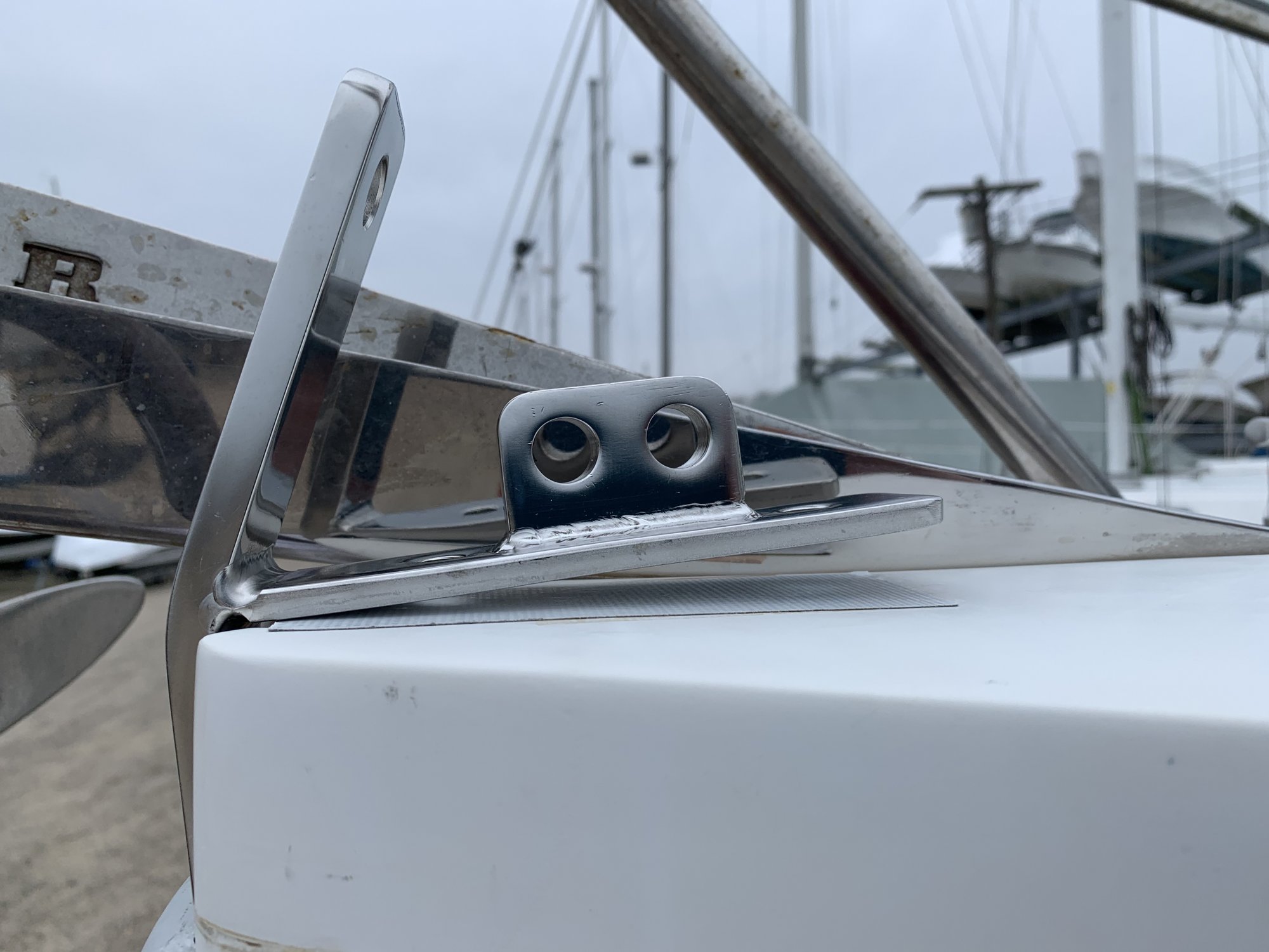

How is your standing rigging? I found a reason to replace all of mine for peace of mind, even though on the surface it looked fine. If you are curious, I can tell you about the stem fitting. It is one reason why I replaced all standing rigging.

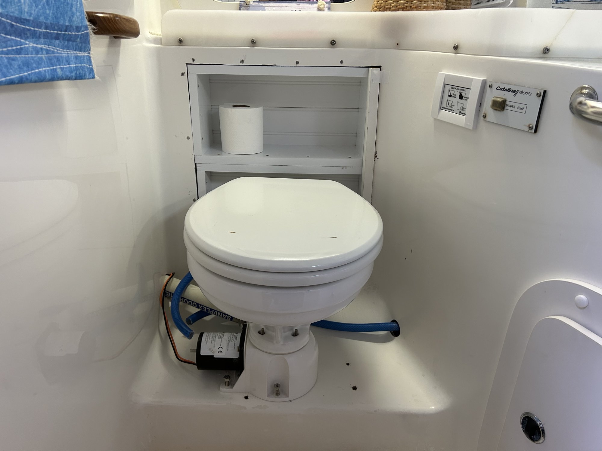

I love the boat, so I'd be happy to share any of my experiences. Mine is a 1999 model that we bought in 2020. I looked at a 1996 model in South Norwalk. It was in the yard at the Total Marine Boat Dealer. I think the later models had some significant improvements.
The only component that I didn't replace was the holding tank. I believe the holding tanks are a plastic that will resist the odors. I was inclined to replace the toilet because I did not want to live with that tiny marine toilet and I wanted a standard size. The problem is that the pedestal that the toilet is mounted on is very narrow. I also wanted an electric flush - freshwater system. So my expense for a new toilet was more expensive to begin with. The toilet itself was over $500. You can price everything out on Defender. I spent at least $1000 in total, I think.
I wanted freshwater because pumping in Barnegat Bay water into the toilet is not appealing. I'm guessing that LIS water in the Norwalk area is similarly dirty. It was very easy plumbing in the freshwater from underneath the sink. It only required a few connection fittings, a small check valve (optional) a little bit of pex tubing and 1/2" hose. I replaced all of the discharge hoses, including the hose to the deck pump out. I replaced the macerator pump (you will find that in the battery compartment) and the hose from the macerator pump to the thru hull. The worst cause of smell was the vent filter the previous owner installed in my aft cabin closet. It's right behind the head and I suppose he thought it was a good idea. It was the worst and it stunk up the closet. The closet is cedar lined and it would be nice if it actually smelled like cedar! It was a bad idea and it actually made the ventilation worse. The first thing I replaced was the vent hose from the holding tank.
Sue didn't want the standard size toilet to stick out into the compartment too much, so I actually cut a hole in the fiberglass panel behind the toilet so that it would fit the way we wanted it. It was a bit of a project, but now that it is all trimmed-out it works very well and looks fine. I added shelving above the area that I needed to cut out and I went a little overboard. It could have been a little more compact. But it was necessary to make space because the electric toilet had a different and larger footprint so I had to do it.
That hole in the center of the panel was a mistake so I had to make a plug for it. I just bought materials from Home Depot to make this and now that it is trimmed out, it looks ok. The connections and fittings in the back of the toilet actually needed to fit in that lower compartment. I made it wider than it needed to be and if I were to do it again, I wouldn't cut into that curved wall on the right side of the picture. That was poor planning and it made it much more difficult to trim it out. I think what I did was make the boxes first and made them too wide. I ended up cutting the fiberglass to fit instead of re-making the boxes. Lazy ... and I wish I did it a bit differently!
You will need to take the cabinet out over the toilet to get access to the deck fill and the vent. Getting to the deck fill was the trickiest because there is some extra framing to remove. I needed some help from @Ward H to figure out what to remove. He saved the day after I contemplated giving up!

I will have to go home to find a picture of my old stem fitting. I was made aware after reading an article in the C320 International Association. I've been meaning to join but I haven't yet :(. I found this article after I got concerned over some rust stains that I found developing at my stem fitting. I didn't notice anything (neither did the surveyor) when I bought the boat because it was cleaned and spotless. But then rust stains began to appear in the first season. After reading this article, I replaced the stem fitting the first winter. Since I took the mast down, I decided to replace all standing rigging since it was at least 20 years old and I didn't want to feel pressure to take the mast down again over another winter to do it. I just figured I should get it over with. I suppose I could have supported the mast and left it standing, but getting the stem fitting would take time and installation would take more time. I didn't want to leave the mast standing during the wicked winds of winter with just a temporary forestay.
Luckily, Catalina Direct sells a MUCH beefier stem fitting at a very reasonable price. I made a few mistakes along the way that I can warn you about if this ever becomes an issue for you. Your later model may already have the better stem fitting. Take a look at the pictures in the article and the picture of mine below and you should see the difference.
