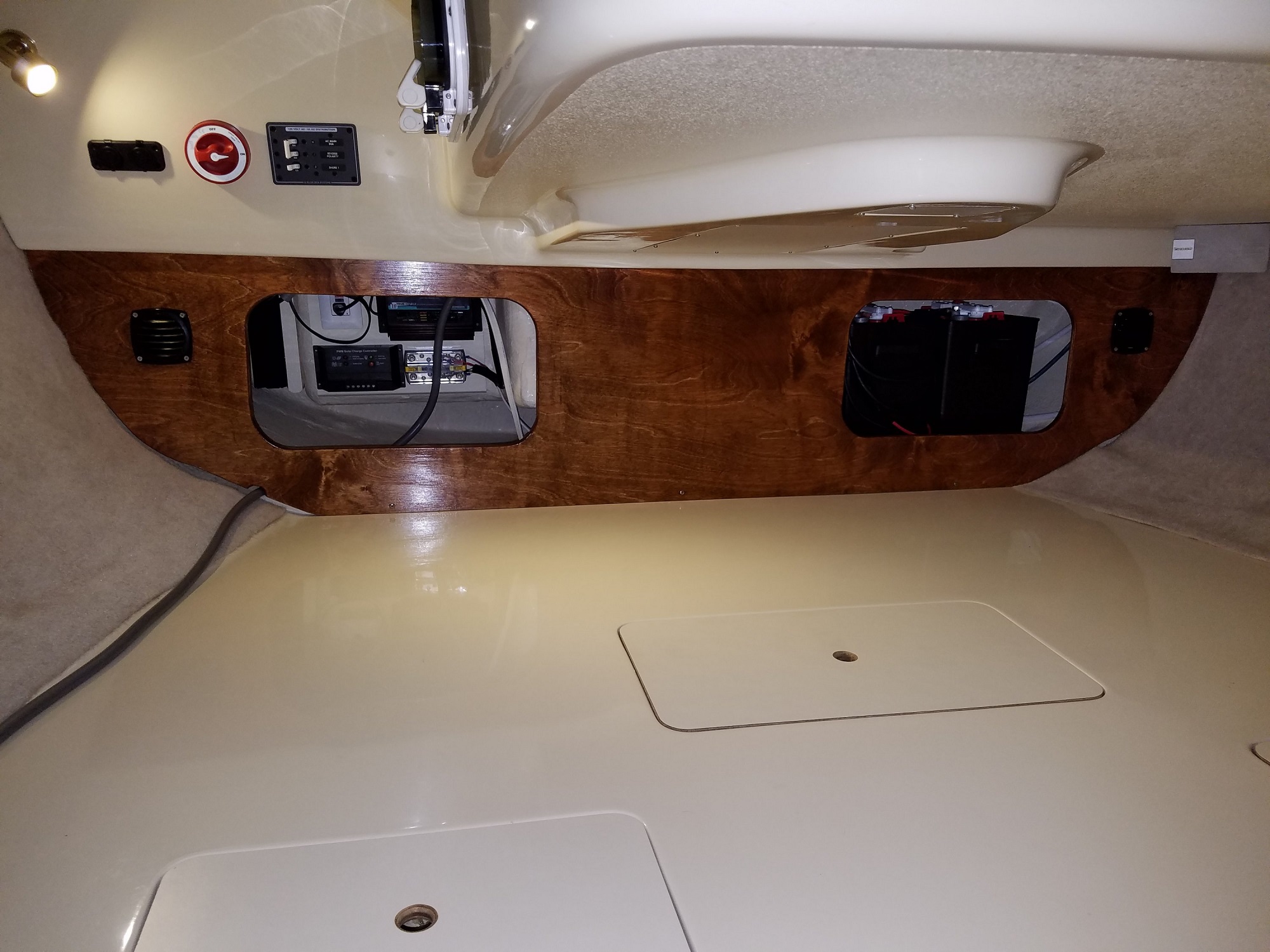

FWIW: Here is a picture of how I did my installation. I have a H26, the transom is different than the 260/270. The PO of my boat installed a watertight shore power inlet in the aft end of the starboard seat in the cockpit, near the motor-well. That location works fine and also has the advantage that the wiring runs directly inside the aft compartment. The only thing I kept of the original installation was the hole for shore power plug, everything needed to be re-placed, as residential house wiring and components were used. I replaced all wiring with marine grade tinned 12/3 Triplex wire. There was not even a main breaker, it was a disaster! From the shore power inlet it is a very short 2 ft run to the AC breaker. I used the Blue Sea AC Main + 1 position breaker panel. As Jackdaw already mentioned it provides a 30 amp main, I added a 15 amp breaker for the cabin outlets. I don't plan to use any real high power devices, 15 amp should be plenty and easy enough to change if need be. The first outlet is a 15 amp GFCI located inside the aft compartment. I plug in the 10 amp battery charger there. From the GFCI it runs to 3 duplex outlets in the cabin. As you can see, I installed the AC panel on the aft bulkhead, for me it's quite accessible. The reverse polarity light is very visible from the main cabin area.

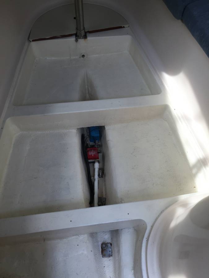

Just an educated guess, but I'd assume that it uses the same hull but a different liner, one with a grid (bonded to the hull) that helps distribute the much more centralized load of the fixed keel.
Jackdaw got it right as usual- I happened to see a H270 for sale on Craigslist, and it has pictures of the bilge and keel bolts. Here is the link:
https://sarasota.craigslist.org/boa/5970261628.html
I've attached the key photo for future reference.
Likes: bamabaxter
