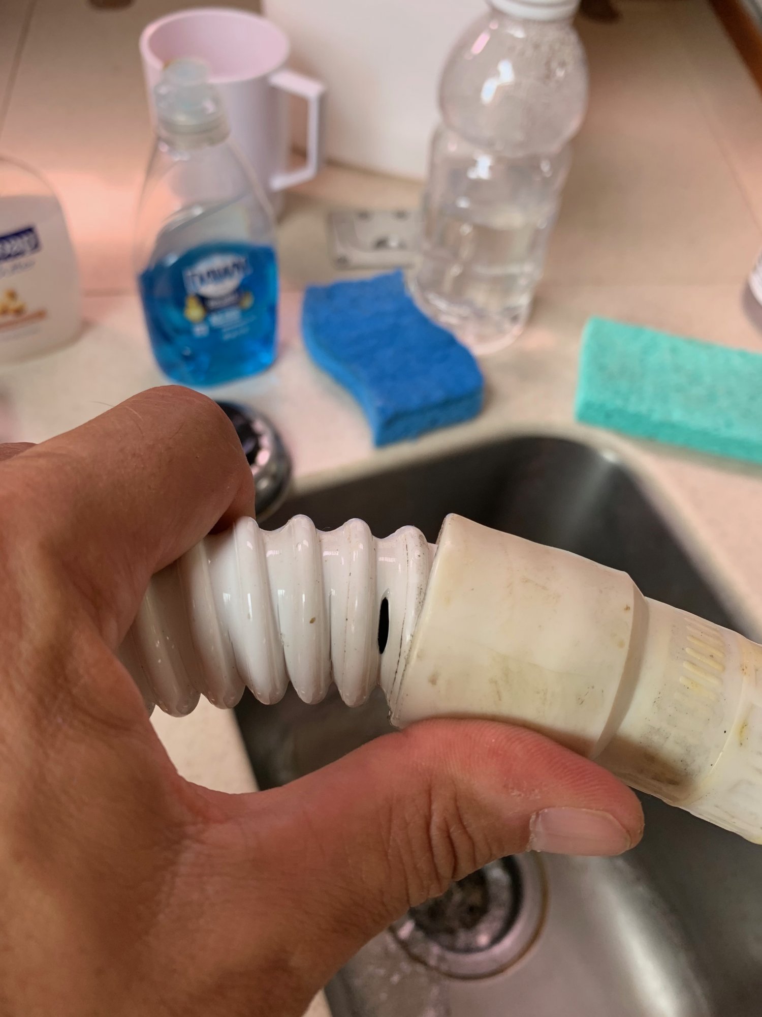

I close all my thru hulls every time I leave the boat. So doing some work today, I opened the thru hull under the sink in the head and wondered why my hand was wet... Check out the OEM hose Hunter used for the drain:
No wonder I was seeing water stains next to the head. Anyway, all the advice I've read says you should only used heavy duty reinforced marine hose below the waterline, so I replaced this cr@#$p with the heavy black wire-reinforced hose you'd use for engine raw-water pickup, or other "serious" applications. Having just replaced 3 thru hulls this spring, I've already upgraded the raw-water pickup, macerator, and head pickup, but hadn't yet gotten to the galley and head sink drains.
It seems that those corrugated drain lines would be just as glad to sink the boat as any other below water line hose.

Saw someone else mention this problem years ago here and decided to take a look at my galley sink hose. YIPES :yikes: ! Exactly what you are showing. Ripped it out and used heavy vinyl hose without the fancy ribs.
I've got to wonder how many years they used this cheap hose and have they stopped yet. Every other hose on the boat was top quality but here ? .................. not so much.

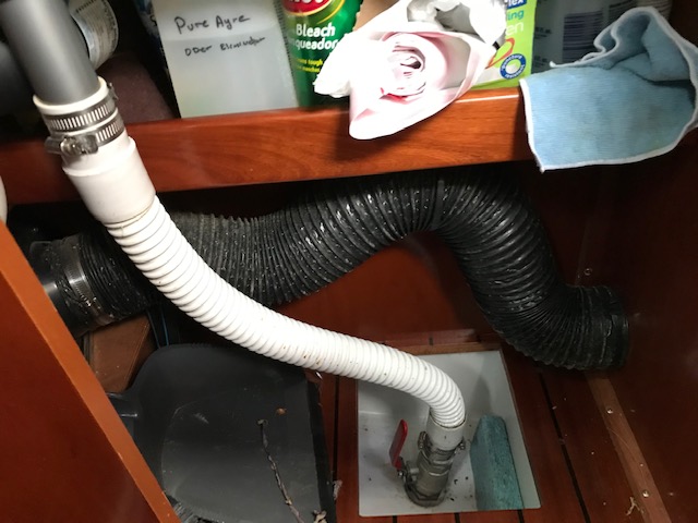

The discharge to the head sink drain is above the waterline where those hoses and plastic through hull ports are OK to use. Your fresh water tank does not hold enough water to sink the boat. The Galley sink drain is a different animal discharging below the water line and hoses, clamps and thru hulls shoul be periodicall inspected. The only thru hull valve I shutoff when I leave the boat unattended is the head intake valve as inspecting the valves and seals in the head is not practical.

Well, I was pretty sure I wasn't the first one to notice this, but it probably can't hurt to mention it again. I actually think I had seen Rich's posting a while back. But there are a thousand things to do, fix, and upgrade on a boat, so you pick and choose and prioritize. After I replaced the 3 thru hulls this spring with flanged 3-bolt sea cocks, I had my eye on the 2 sink drains and thru hulls: just hadn't gotten to them yet. But finding a hose leaking below waterline will get your attention.
BTW: both sinks drain below waterline on the 306, and the fresh water tank isn't involved.
Also BTW: the head pickup hose was originally the thin white vinyl hose used for most other toilet hoses. This stuff isn't as bad as the corrugated hose, but it still tears pretty readily when it's 15 years old: it got replaced by the heavy duty black reinforced hose.
