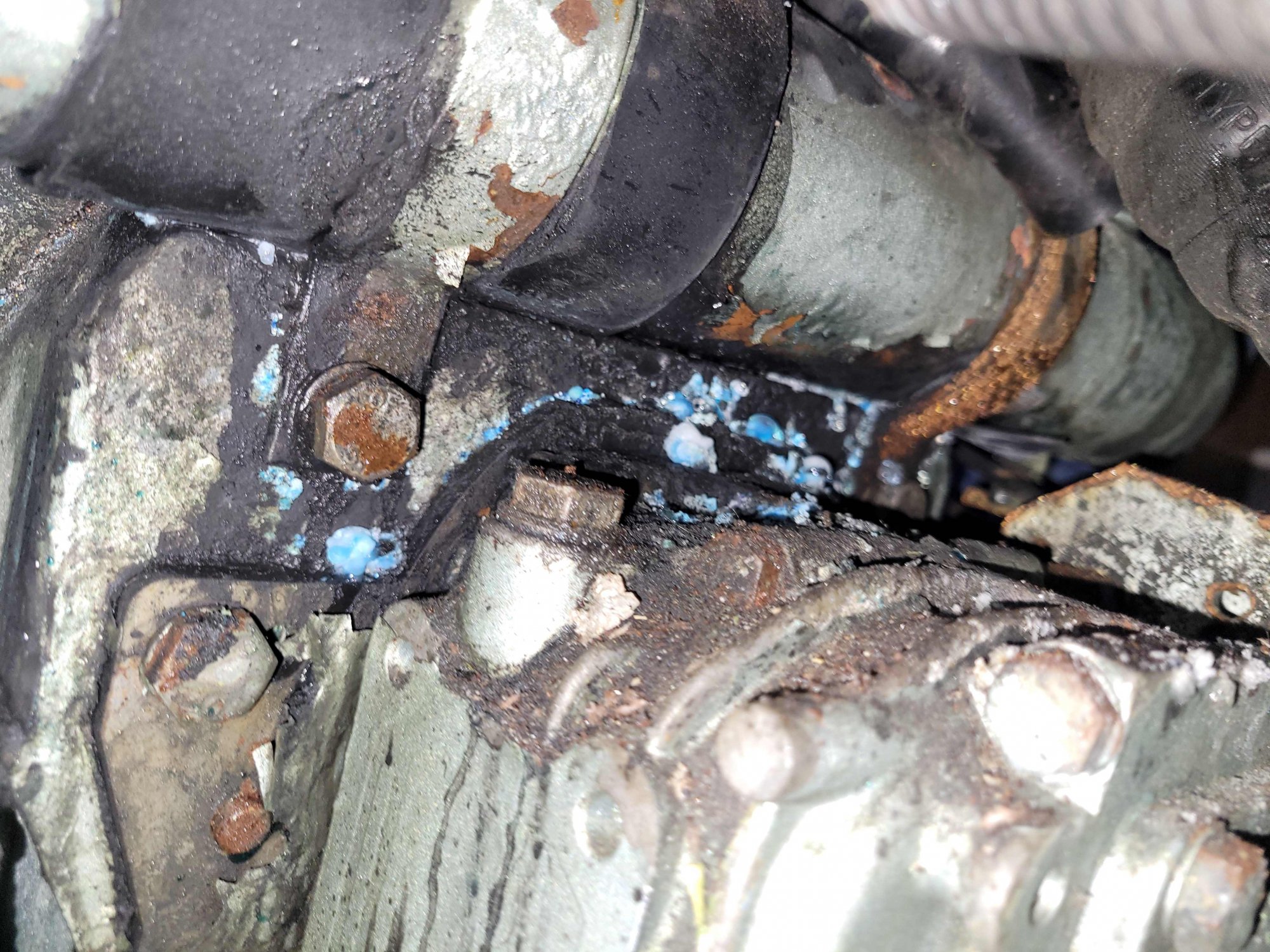

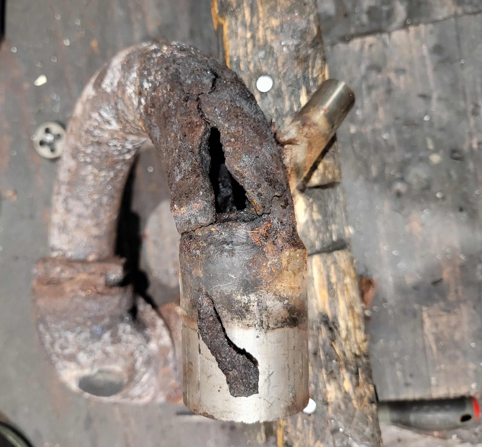

This summer i noticed some black dots next to the engine, a small leak in the exhaust elbow.
all our boats are getting some age, i'm sure there are more like this...
first photo is after removing the elbow and heat wrap.

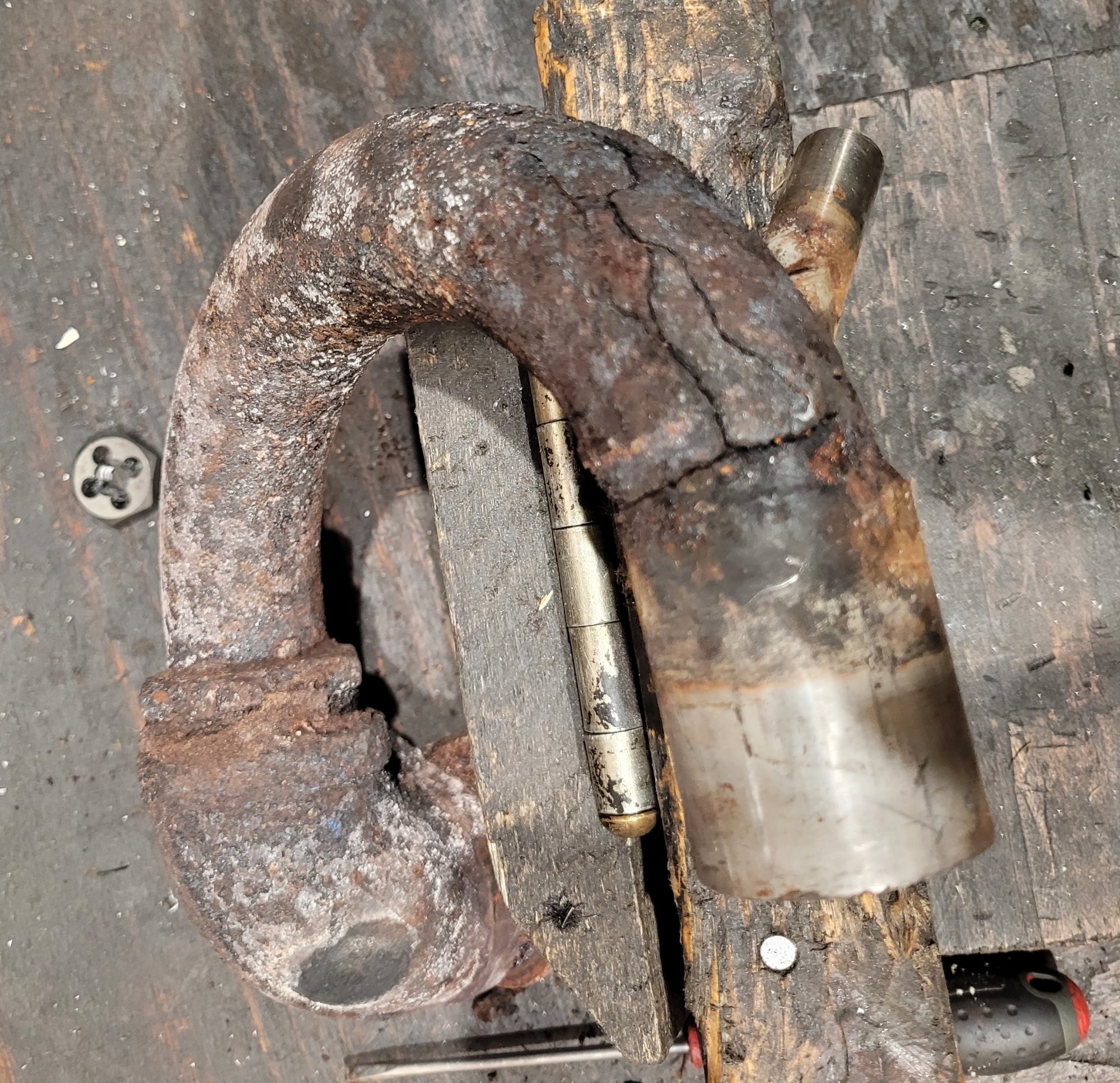

no 2: this piece fell out

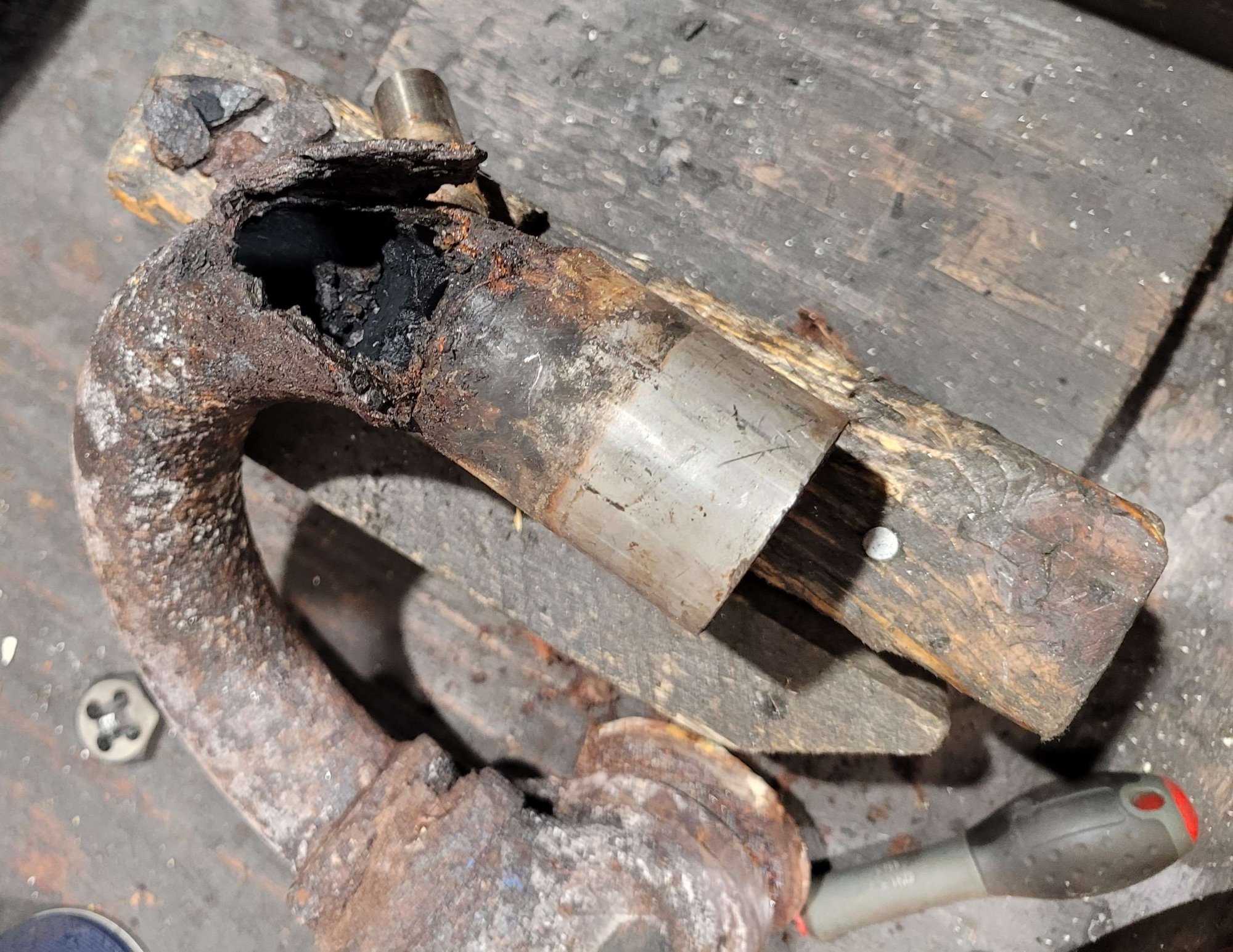

no 3 after some poking....

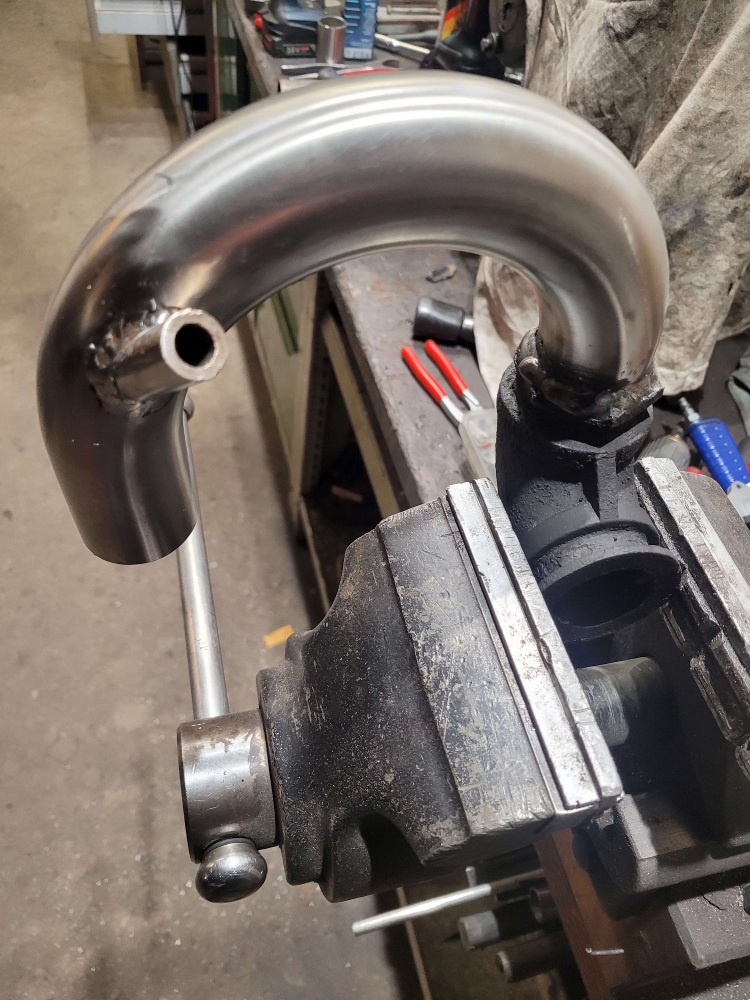

no 4 new stainles elbow .

around 1700 hours, i fabricated it from 316 stainless

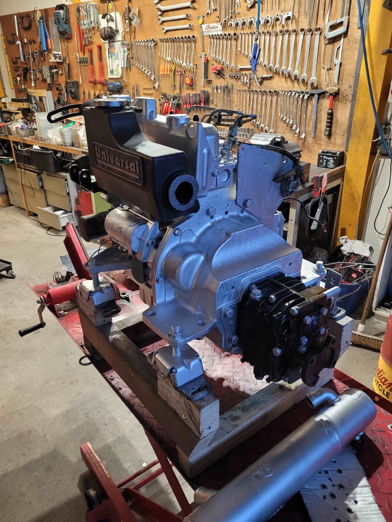

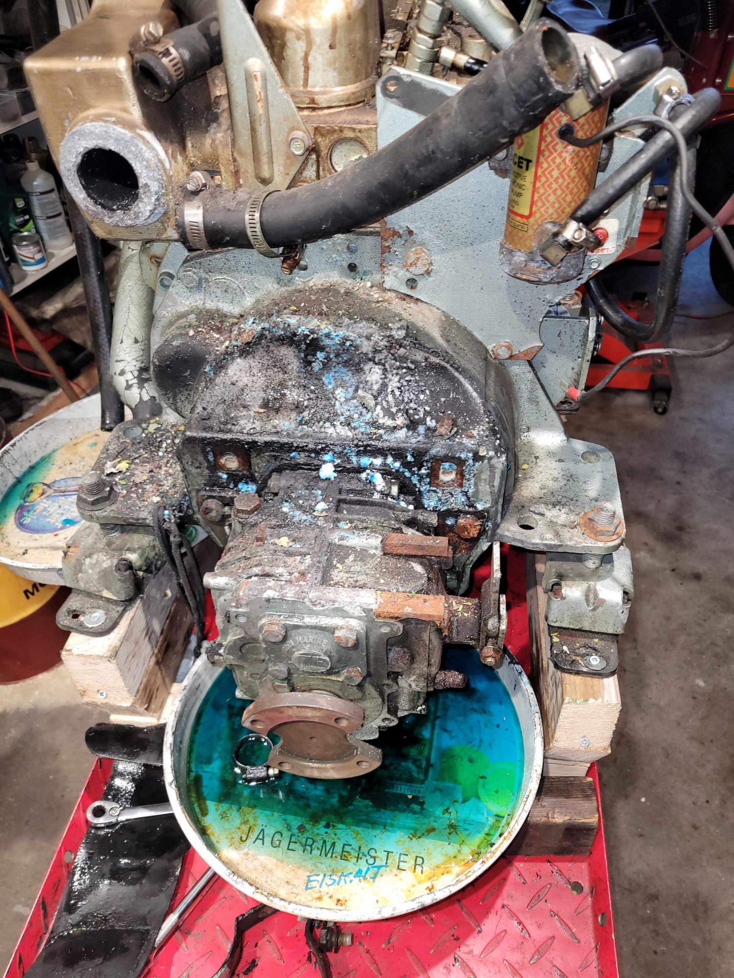

Yes it did ! and just in time for the rest of the engine to fail. I knew the engine was a bit messy. leaked a little of everything.
So out of the boat and a full rebuild!
Damage so far: a crack in the heat exchanger under one of the brackets. 2 hoses almost sheaved through. (coolant)
blocked vent coolant cap, worn damper plate, and lots of oxidation.
