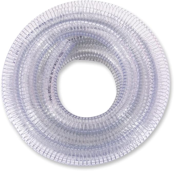

we have reinforced transparent hoses
I will check them again when we get to the boat to see if the level is good in it

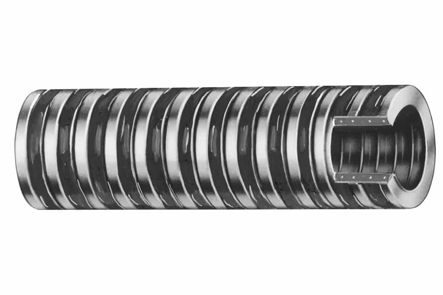

Transparent hose, even with fiber reinforcement, is not recommended for below waterline use and engine intakes. Rather than adding a check valve a much better use of your time and money would be to replace that with reinforced black rubber hose rather than the transparent hose usually made of PVC.

Not rated for below waterline use. If it fails, the insurance company can easily say that is on you.

It can be clear. Engine intake hose should be wire reinforced to withstand a vacuum without collapse. I see nothing wrong with using something like this for below waterline use. I use it on my boat Amazon.com
