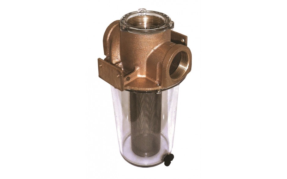

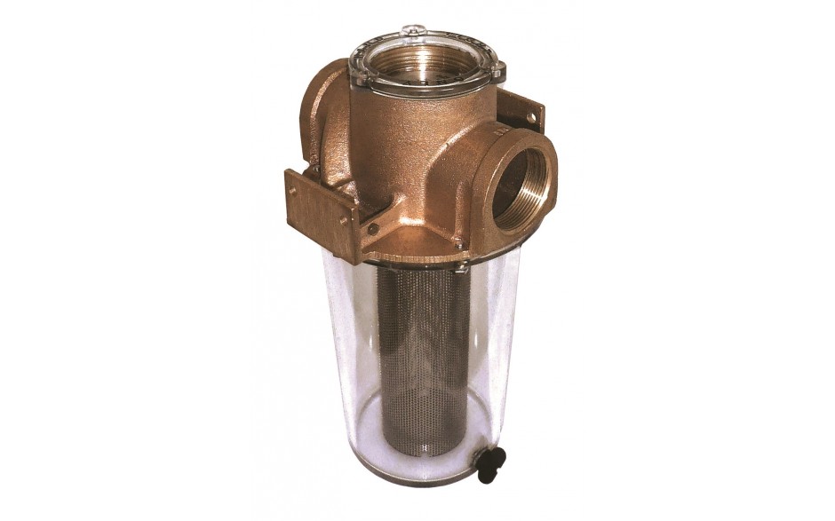

I solved the run dry fear be installing a strainer that has water in it, and shutting the valve on the thru hull when leaving the boat.
Behold the Groco ARG750 series .
Easy clean, easy to tell you have water in the system.
This is exactly what I had in mind but then again, I own one
