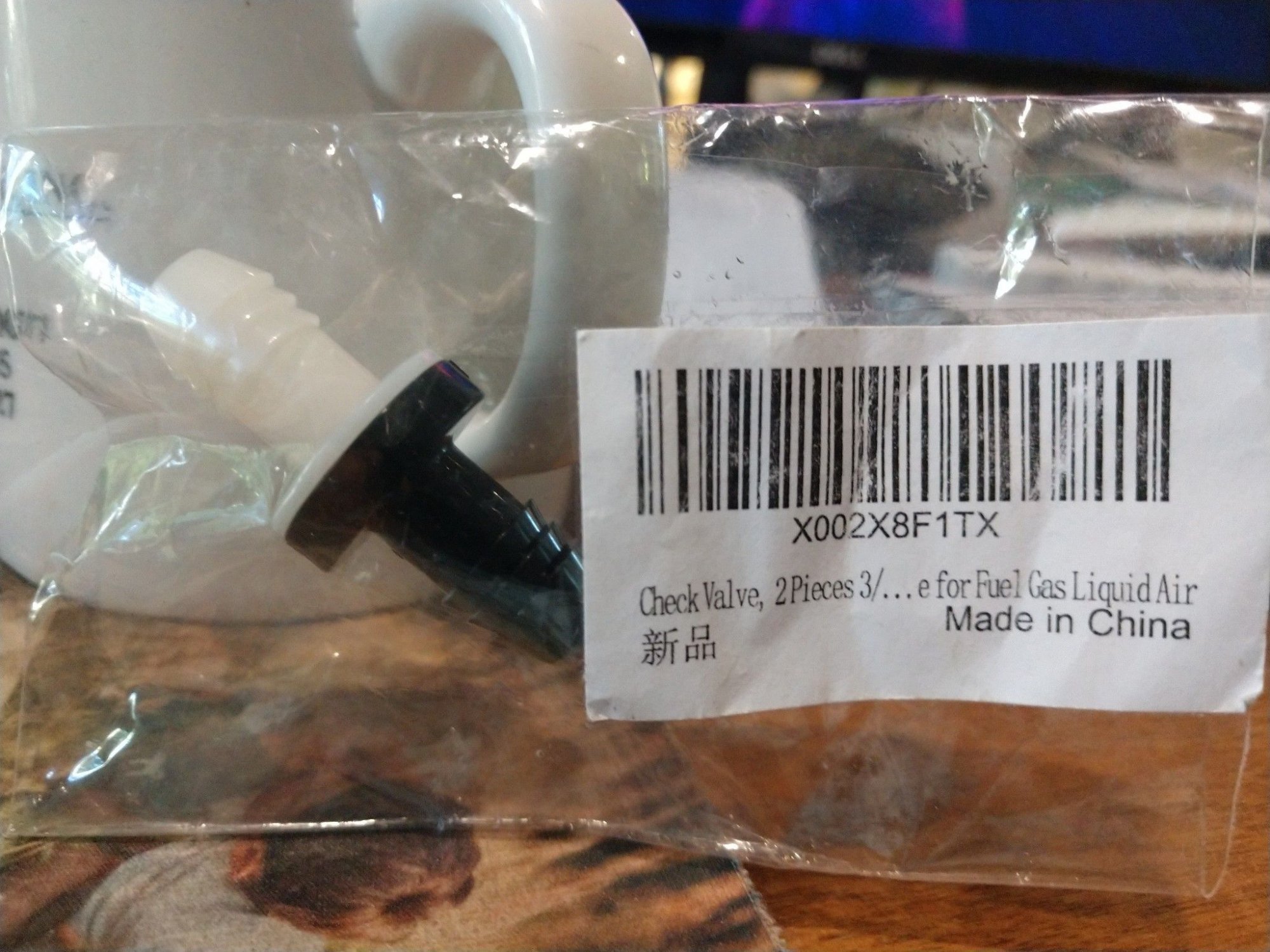

Yesterday I got around to installing the check valve I had purchased from Amazon the the water line to the galley faucet. I spliced it in the line just below the fitting on the bottom of the pump valve. It works perfectly. One stroke to prime the pump and the next stroke discharges water. They are five dollars a pair.
