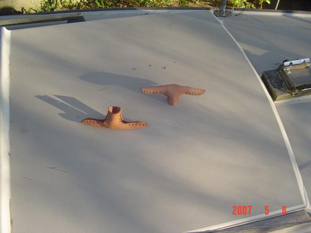

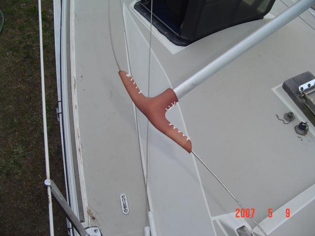

As for the spreader boots; I like them but I won't buy the ones made of rubber. They just aren't worth the money that they're getting for them today. What I did was make my own spreader boots out of leather. It's easy really. You just take a piece of thin cardboard or heavy paper and fold it in half. Then place it over the the end of the spreader and draw out the design on one side. Cut it out and transfer it to the leather. Punch out the holes and lace or sew them on to the spreader and wires. Wetting the leather will make it conform to the shape of the spreader. There are a lot of tricks to the trade and there are a lot of Youtubes on the web that demonstrate how to work with leather.

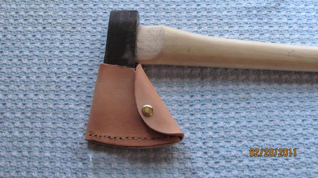

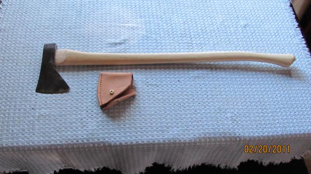

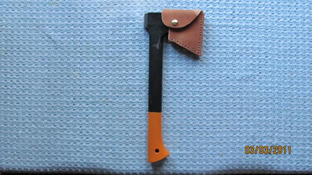

The spreader boot project got me started in leather work and I've been having a blast with it ever since. I'm building a stitching pony right now to hold the leather. Here's some of the stuff that I've made through the years. I made a knife sheath for a Nessmuck knife that I fashioned out of a store bought "Old Hickory" skinning knife and I also rebuilt a knife case that came with a large primitive Bowie knife, by turning the sheath inside out, adding buckskin fringe and resewing it back together. There's no limit to what you can do with leather on a boat. I made a chafe pad for my tiller to keep the ropes from digging into the wood when I tie the tiller off and leave the boat at the mooring or at anchor.
For me, leather work has become a new hobby and I intend on doing some work with fabrics like canvas and Sunbrella.
