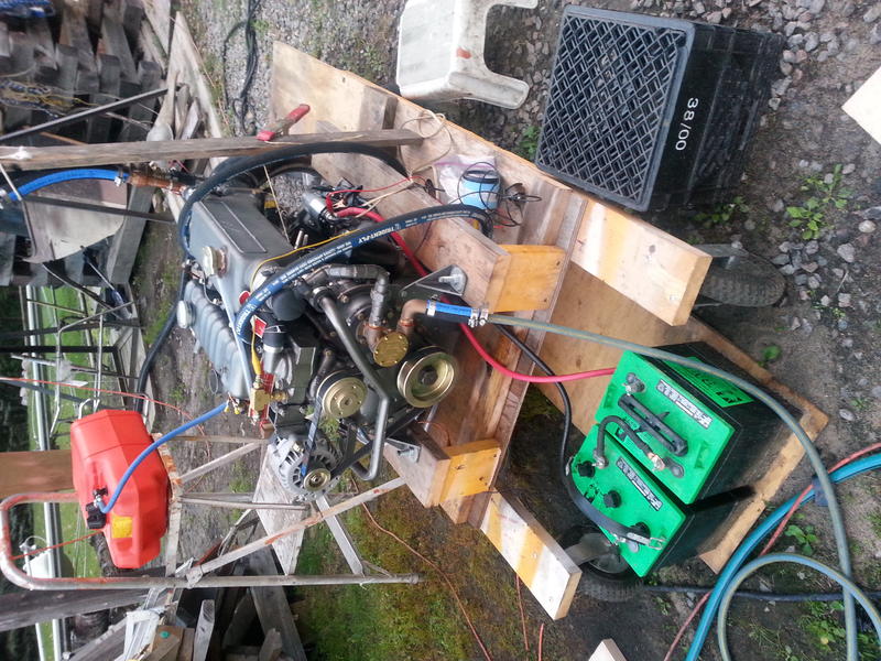

Finally after a long process restoring this engine from an compartment fire she has come back to life in a better and stronger form
YEEHAWWWWW break out the painkiller mix and pussers
so after about 3 hours of running on the test stand engine runs so smooth all fuel leaks fixed, oil pressure sending unit failed and replaced all is good
Thanks to all on this site who have answered my posts lots of wonderful talent here
Question. ..after finishing the runup need to pack up and preserve my baby till I canarrange a boom truck to hoist into boat
Since this will be my first sort of end of season shut down what do do with fuel in the fuel lines etc.?
Will place ant freeze in the heat exchanger when exhaust lines are disconnected should
Any tips as always will help
thanks again
