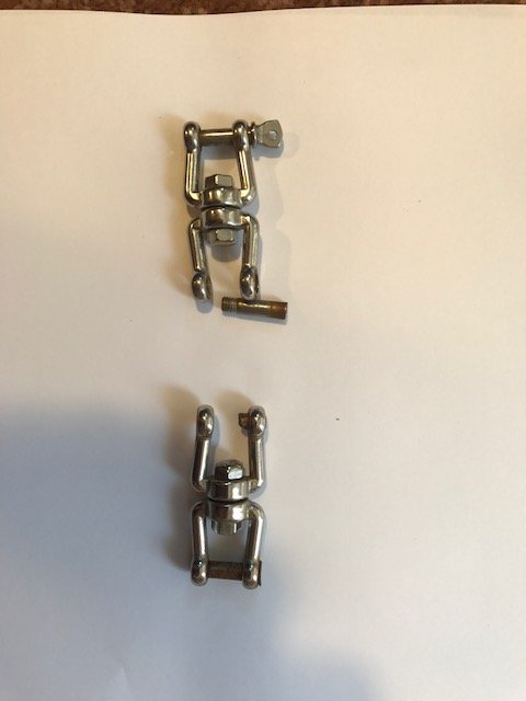

As I am sure many of you have I like to go to big Boat Shows. On a number of occasions there has been a booth there with very "reasonably priced" stainless steel fittings. I have purchased a number of those items and come away from the purchase very pleased at the cost. However I want to relate a very interesting experience we had on our Bahama's Trip last month. I had purchased four stainless swivels for use with our Dinghy Davit system. While in the Bahamas I was inspecting my dinghy suspension system and noted some discoloration on the swivel. I decided to remove it to check it out and when I started to unscrew the pin it fell apart in my hand. Fortunately it did not fail while we were transiting or it could have been a disaster. This happened twice! Needless to say I removed all of them and replaced them with high quality (and expensive) swivels. I have attached a picture. Just wanted to warn you away from those cheap stainless fittings......

Even more to the point, why would you need a swivel. Ditch them, they cause more twists than they solve.
But yeah, cheap parts are trouble waiting to happen. I dropped a dinghy with the chute up once (sling chafed through), and it was "stimulating" for a few minutes, as I attached a jack line to the dinghy while standing in the sugar scoop at speed and winched it back up. There are cheaper brands (Garhauer), but no-name is pointless.

Cheap stainless steel is never a good value in the long run. For anything going on a boat, if it's not type 316 stainless (higher nickel content than 304), don't buy it. If it's type 316, the label will say so. If it doesn't say, then it's suspect. If the price is to good to be true.... you get the idea.

Take a magnet with you...if the magnet sticks to any part of it... dont buy it. I learned this the hard way when I bought a stainless steel barbeque grill.. after a couple of years, it rusted out.. go figure.. I was trying to reconnect some parts and was using a magnetic flashlight.. the damned thing stuck to the grill.. theres alot of ferrous metal and alot less chromium in some cheap stainless... a magnet will not stick to a good quality piece of stainless.
This is not necessarily true. Austenitic stainless steel (304, 316, etc) is often cold worked to increase mechanical properties. In many cases, the piece of stainless steel hardware you are looking at may have an amount of cold work performed on it which will make the part magnetic. It may be quite advantageous to have hardware produced with cold worked material as that can substantially increase the mechanical properties of the base austenitic stainless steel.

Got news for you, Marine Part Depot is Chinesium. I buy from them too, but only stuff that is not critical if it fails. If you will get hurt if it fails, get real 316.
The real advantage of 316 type austenitic stainless steel is pitting corrosion resistance. If you are sailing in a salt water environment, then the added corrosion resistance of 316 is desireable. However, if you are sailing, say on the Great Lakes or other fresh water location, then 304 is fine. The mechanical properties of these common austenitic stainless steels are the same.
If you are looking at a fitting and it appears that it may have been welded as part of it's construction, or if you are making your own parts from stainless steel and welding, then you really want the part made from the low carbon forms of these alloys.That would be 304L or 316L. It is not usually easy to see if a part has been welded as they usually buff the welds. But look carefully, there can be tell-tale signs.
I personally would be more concerned with the construction and design of the fittings rather than the source of the raw material as these austenitic alloys are commodity alloys and are produced all over the world with excellent quality. The design and construction of them however is much more varied...
