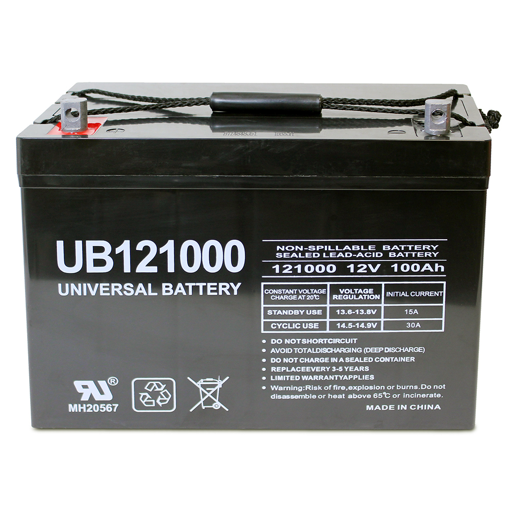

I would like to install a trolling motor on my Hunter 23.5 for the purpose of navigating in/out of dock. I'm considering powering with a pair of cheep ebay SLA batteries like the one pictured. This particular battery seems to be the most common on ebay. Does anyone have any specific experience with this battery or low end SLA batteries in general?

Why buy a not cheap battery from China from an unknown dealer on ebay when you can buy a comparable one at any auto parts store for less money and it was made in the US?
This looks like a pretty standard Group 27 battery. For $10 more you can go to West Marine and buy a US made group 27 and still pay too much.
Or you can go to NAPA and buy this Group 27 for $112 and it is made by East Penn, same people who make Deka Batteries. https://www.napaonline.com/napa/en/p/NBE8301/NBE8301
12,389
This is not a deep cycle battery... it even says right on the battery "Avoid Total Discharging (Deep Cycle)"
It won't last very long if you run it down. Deep cycle batteries are constructed differently than normal automobile batteries and can handle a deep discharge and be recharged many times.

These SLA UB12100 batteries come in different capacity sizes. While a 10Ah model might sell for $20 a 100Ah Deep Cycle one will cost around $200. Here is a review from an customer of an online vendor;
By Amazon Customer on April 27, 2016
I have purchased four of these in the past six months. Three of the four were DOA. One arrived with 9.7 volts and if you know anything about lead acid batteries, 9.7 volts means that irreversible damage of some sort has occurred. Another had 10.5 volts and another had 11.0 volts. Same story for all three of them, garbage from the moment I took them out of the box.
I went through a ton of effort charging and discharging them because the first seller told me that the manufacturer said that deep cycle batteries sometimes have to get a few cycles on them before they reach their peak performance. BS! Any battery that arrives with less than 12 volts charge has either sustained internal mechanical damage or has not been maintained with a proper charge while in storage. Either way, I went through the hoops for the manufacturer to satisfy their sadistic needs. While I was at it, I discharged the batteries with a measured one amp load so I could calculate the depth of discharge in relation to the rated capacity. As it turns out, the batteries were showing a total capacity of around 40 amp hours, about one third of what I paid for!

They might be good batteries in the 100Ah size, Deep Cycle units but apparently some of the online vendors might not keep a fresh inventory. I do not think a battery in the cheap $20 10Ah size which is not a deep cycle will provide adequate service. Why don't you go with a regular 100Ah deep discharge battery from Walmarts under $80 with a 6 month warranty.

@dlchoner I wanted to stay away from flooded lead acid. I like the idea of not having to worry about hydrogen gas or the possibility of acid coming in contact with salt water.
@rgranger I noticed the comment on battery but it's using "total discharge" in the same sentence which isn't the same as deep discharge so I chalked it up to engrish. I thought all AGM batteries were deep discharge...

While the battery is"sealed" it is still a lead acid battery and there is a valve on it to all any excessive pressure developed to escape.
Hydrogen is not an issue so long as the battery box is vented. Hydrogen is much lighter than air (about ⅛ of the weight) so it wants to get up and go. Sulphuric acid and seawater is also not an issue, the sea water will just dilute the acid.
It will be necessary to check the water level of a standard battery, but that's not all that difficult and distilled water is cheap.
