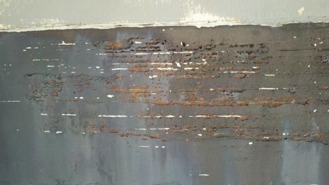

This morning I am going to check out my recently soda blasted bottom and lead keel. I have read a few articles with way too much time and money expended to cover the lead. In summary they suggest a primer, then epoxy, then more expoxy fairing, then a barrier-coat. All before the anti-fouling.
Is it possible to get a lasting finish with a simple primer? If I do find some voids needing fairing can I put West System over that primer?
I guess when I barrier-coated the bottom in 1999 I should have done the keel. :doh:

It is going to be a challenge given my four hour work time. The soda blasting did a nice job and the keel is much better than I expected. The paint was so bad that I thought I had big voids. Instead just a few scars. Some look like they might have been filled previously. It would have been before 1998 when I bought the boat.
If I understand the Interlux literature I should fair AFTER the first coat of IP2KE. Hopefully I can do one coat and fair the same day. But it will take two more days to finish. And I do know that I have to treat the last dry coat before adding a new coat.
