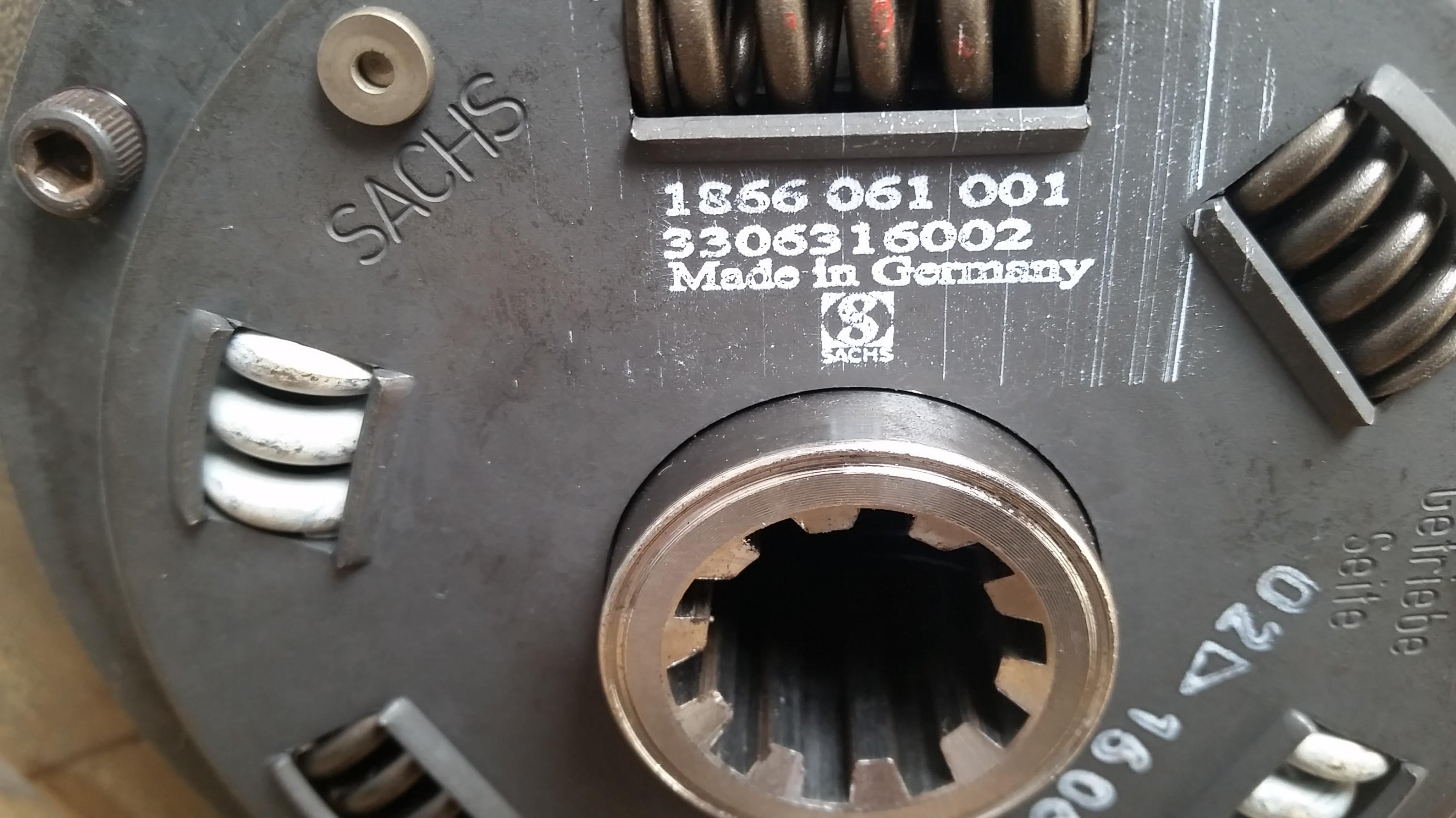

You can loosen the coupling bolts and check with a feeler gauge at each of the four quadrants to see how close the alignment is. Last year I pulled my engine to replace the damper plate and found the aft two engine mounts were shot. Mine is 2003 #218 with less than 1000 hours. Lots of other good ideas here, but the damper plate is a known issue with the C310 engine installation, and the OEM mounts are at/beyond their service life. How long have you been experiencing the chatter? Mine had been getting progressively worse and the spline was practically worn through.
