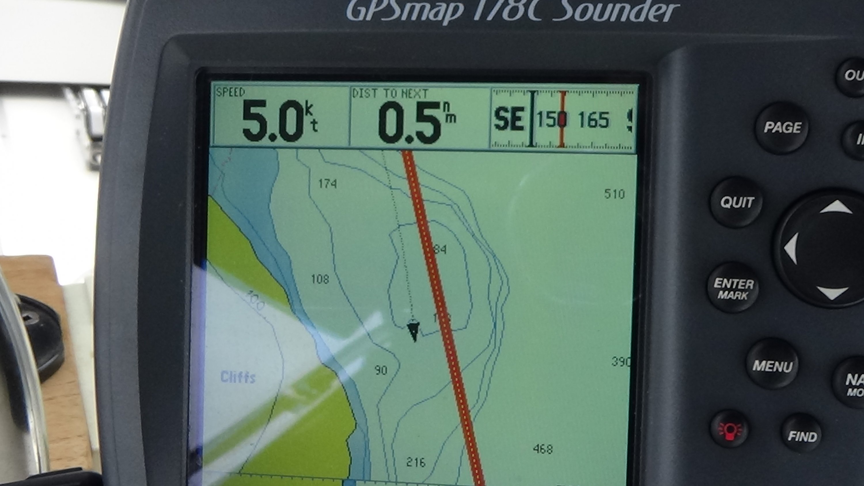

Published this article a few years ago about the Garmin 178C Sounder the fam got me for my birthday in 2005. https://hunter.sailboatowners.com/mods.php?task=article&mid=45&aid=6023&mn=42
This model has been manufacturer discontinued for several years, but it still works like a dream. I connected the device to our 1991 vintage Autohelm 7000 (6000 head). The older NMEA version (1.X) of the Autohelm differs from the newer version of the Garmin (3.X), but except for a small course change issue, it works slick.
Here is a photo of the unit.

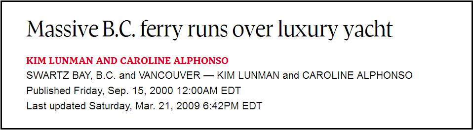

Pretty much a recipe for disaster when it comes to powerboats around here:
http://www.theglobeandmail.com/news/national/massive-bc-ferry-runs-over-luxury-yacht/article4167437/
One of the final "theories" for this crash was having the boat directed by a GPS, according to the media. Another large powerboat ploughed into a bridge piling under full power a few summer ago with no explanation. Again, a GPS problem was mentioned. Pretty well guess what's happened there.
