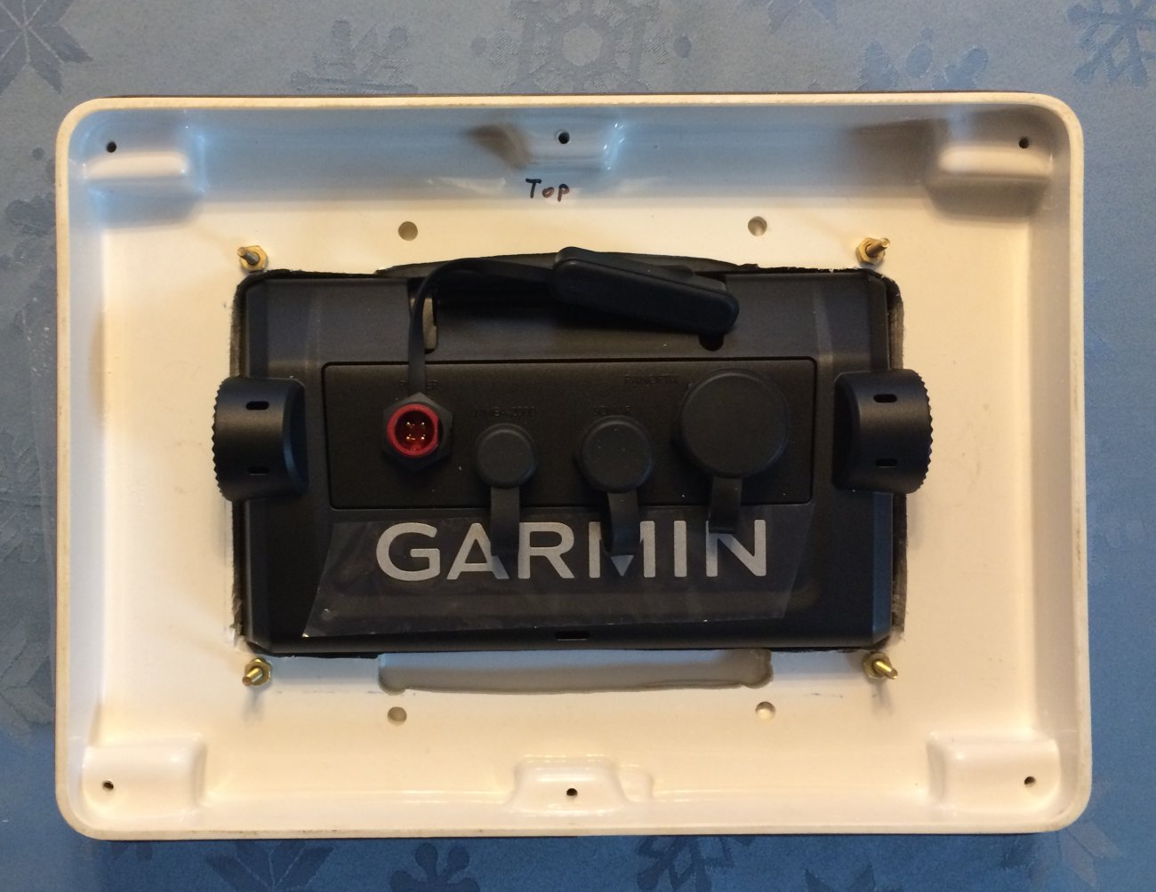

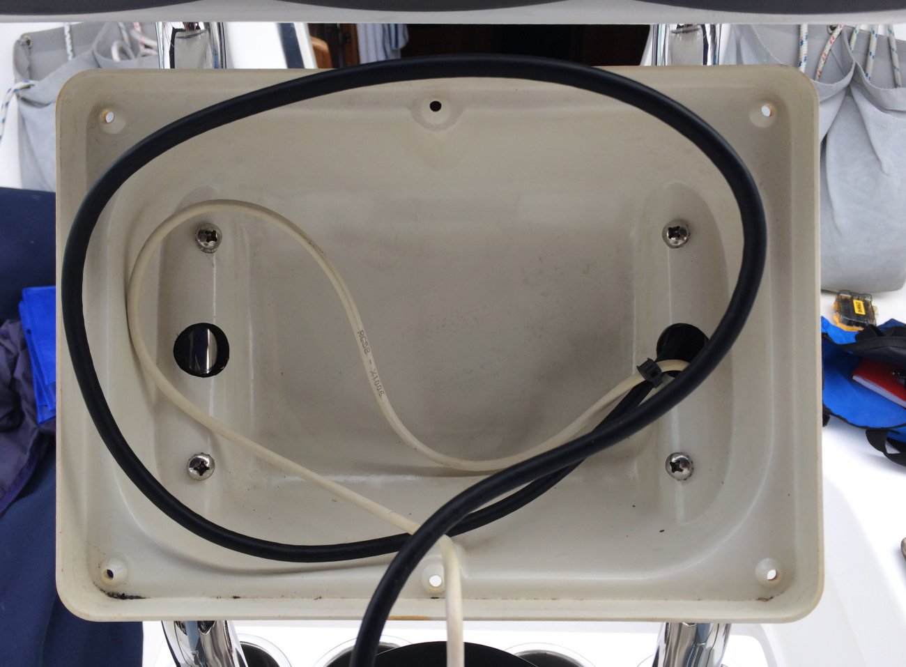

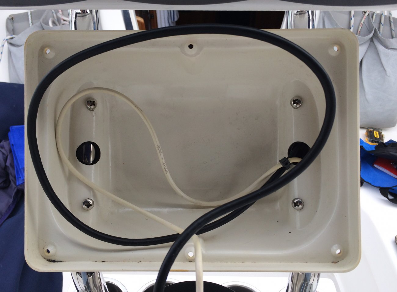

There are two reasons I wanted to keep the existing pod
- NavPods are rather pricey
- I didn't want to drill new mounting holes in the stainless steel and then figure out how to plug the old holes.
Picture of the bottom half of the existing pod attached

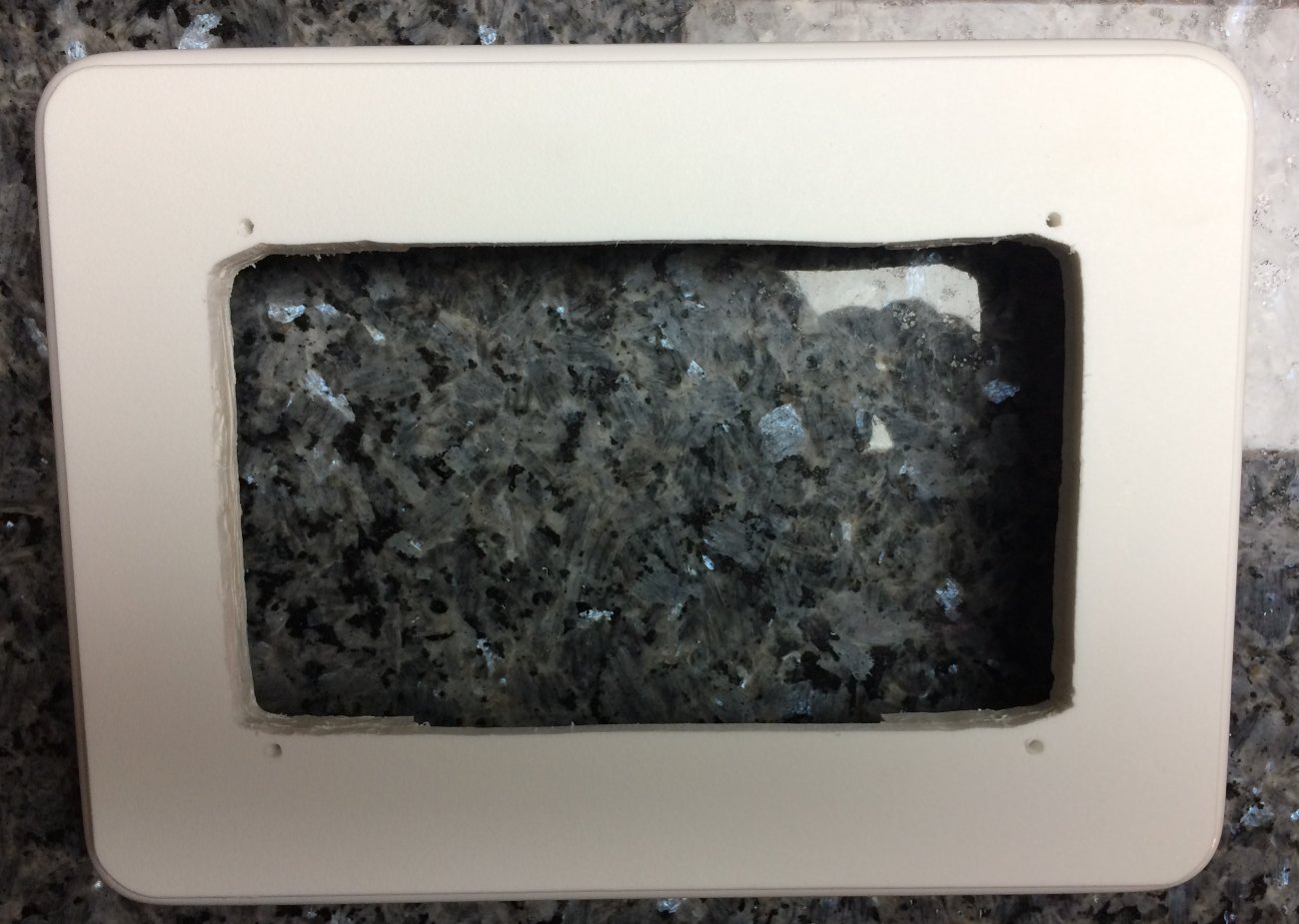

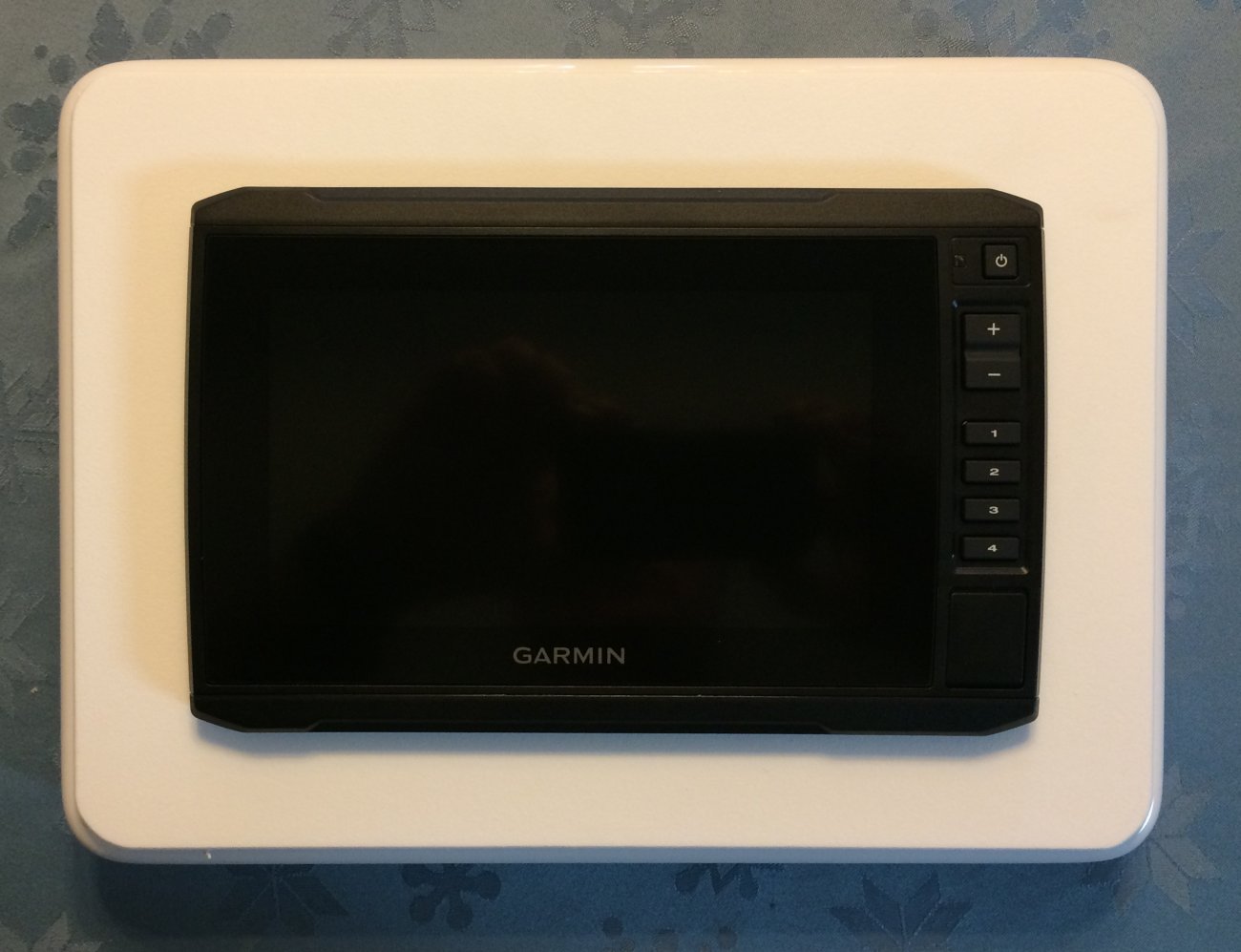

Wired up the pod. Used a terminal block, then covered the block with liquid electrical tape for insulation. Did a smoke check and all the existing instrumentation still works. Mounted the starboard on the NavPod using 3M 5200 and let it dry a week. Cut out for the Garmin and bolted it in. Will mount it on the boat and connect it up when the weather permits. I still need to drill the hole for the USB plug.

Well, I got it all installed (actually twice - turns out the Garmin won't work unless you connect the plug on the back). Took it apart, connected the plug and hit the Nav power switch. No smoke. USB power port works fine. Garmin fired right up, and linked up with my phone via WiFi. Issue: no NMEA 0183 data is getting to the Garmin. Now, I don't need that as I have stand alone Raymarine 4000 series instruments. However, it would be nice to get wind speed, water depth, and water temperature from the Raymarine SeaTalk to the Garmin. I gather Raymarine's implementation of NMEA 0183 via SeaTalk on their 4000 series instruments is different than others. I need an interpreter to go from Raymarine SeaTalk 1 to NMEA 0183. Possibly this, but I'm not sure:
