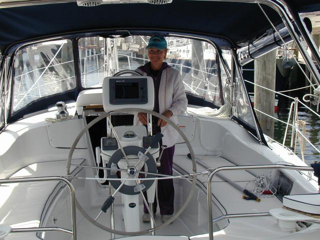

You have a choice
You can keep all the information at the helm in a BIG Navpod OR you can choose to "distribute" your data. The answer to this lies in how you intend to use your boat. A friend of mine just finished his first 2,000 nm of offshore/coastal cruising from Vancouver BC to Mexico. He reports as follows about chartplotter locations:
- new chartplotter with radar and AIS - large 8 inch screen on a bracket at the companionway. This is the perfect position for the instrument. Weekend sailing, you stand behind the wheel. Doing serious miles, you relax more comfortably in the cockpit and you can't see instruments behind the wheel. AIS is amazing. I thought it was poor mans radar, but it is much better than radar if you are trying to figure out what a vessel is up to (speed, direction, position, closest approach, vessel name and MMSI number right there for you). And best of all, the whole thing folds into the companionway so we don't worry about expensive electronics being left outside.
I have the same boat as my friend, do a bit of offshore coasting, agree with never staying behind the wheel much and am quite comfortable with my handheld Garmin GPSMap 76Cx. Others like the BIG nav station behind the wheel. I don't particularly like all that plastic between me and the bow. seadaddler's layout is one of the better ones I have seen: big chartplotter but low enough to see over it. On our boat, I can sit behind the wheel and still see forward.
Your boat, your choice, for both location AND the information you intend to include: charts only, level & quality of charts, radar, AIS, etc.I agree with the others in requesting you to provide some more information, including how you plan to use the boat. "Take it to the next level" can mean a lot of different things, racing ?, cruising ?,especially based on those of us who have "followed" your earlier posts.
