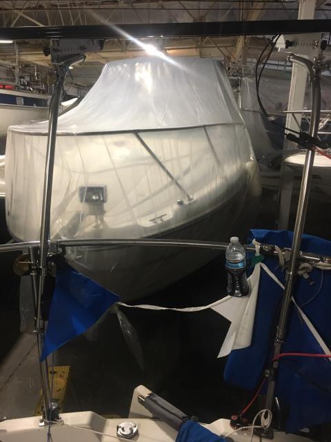

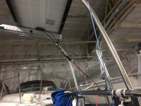

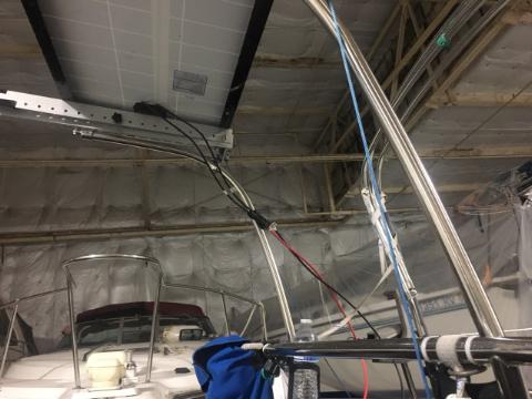

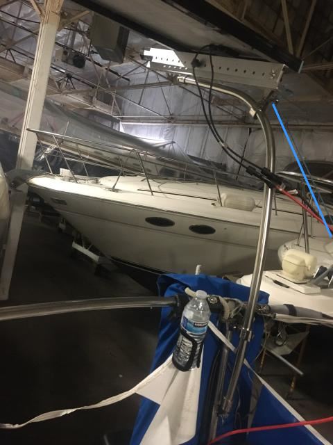

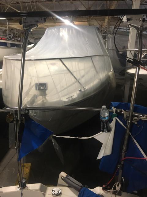

As requested here are the pics. It needs a bit of adjustment as it was put back up to simply get it out of the way (the yard typically requires me to take it off for haulout). This was made by cutting a bimini bow in half. I added some dyneema (highlighted in blue) because I found that the stern rail assembly was racking quite a bit. the other end is attached to a car on the spinnaker T track. I waited a few weeks to replace the dyneema at the beginning of the season and the stern rail mounting bases ended up a bit bent. My outboard and inboard are connected to the inboard's fuel tank. The solar wiring enters the hull at the same spot. With different hardware it would be possible to route the wiring through the half bimini supports. Zip ties work for now. The angle of the panel is adjustable and I do plan on cutting off the excess aluminum angle. This setup can also be turned around so the panel is above the cockpit
I'd also suggest looking into the Great Loop Cruisers' Association. It looks like an incredible resource and a great group of people
