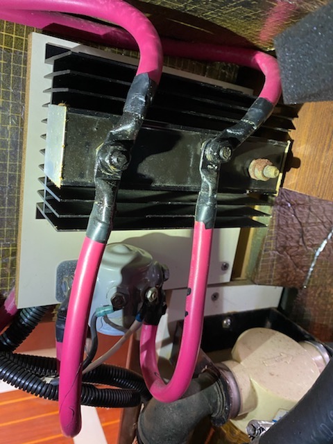

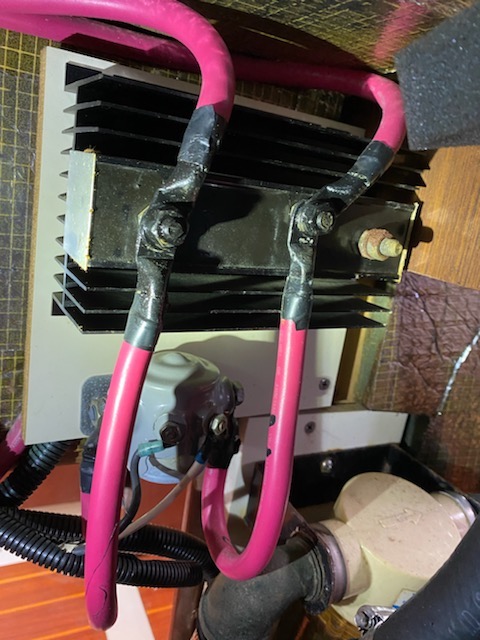

Look for this device on your boat. Mine is 1997 inside the Engine compartment.
This is what charges the House Batteries, when the switch on you engine activates the Grey Solenoid.
You can check to see if all the Red Wired connection are good ≈ 14.1 VDC, and if you have a clamp on DC amp meter verify the charge.
Once your Engine Alternator tops the Start battery, you should have 70 amp available to charge the House batteries.
All Checks must be done with your Engine Running, even at idle speeds. It should take some time to top off the Start Battery.
This device is sometimes called an ACR.
Jim...
PS: There are many things depending on all in working order. Include your ignition switch.

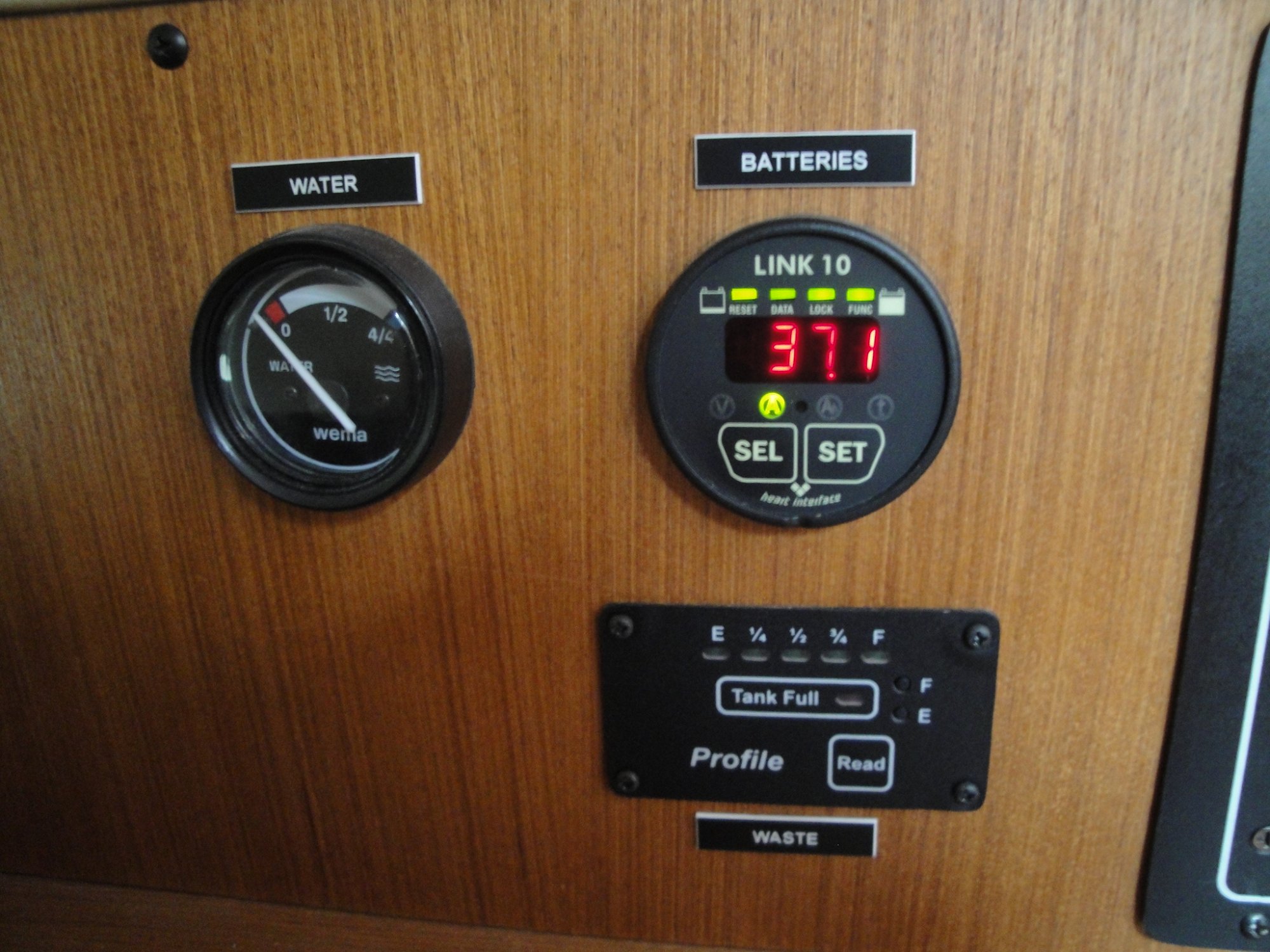

If you're willing to invest in a battery monitor, it would do all the figuring for you and tell you where your problem is (roughly speaking). Makes troubleshooting far easier.
Above shows a Xantrex Link 10 battery monitor watching over the little Hitachi 55A alternator putting out 37.1A. This particular alternator will only put out that many amps because it has a Balmar ARS-5 external alternator regulator kicking its little ass. Prior to the Balmar, it would only put out 10A max.

Jim,
That looks more like an isolator rather than an ACR. They are two very different things. An isolator is a diode based electrical check valve. An ACR is a relay.
And the Grey thing is the Solenoid/Relay.
Hunter used solenoids that were not desgned for the duty
