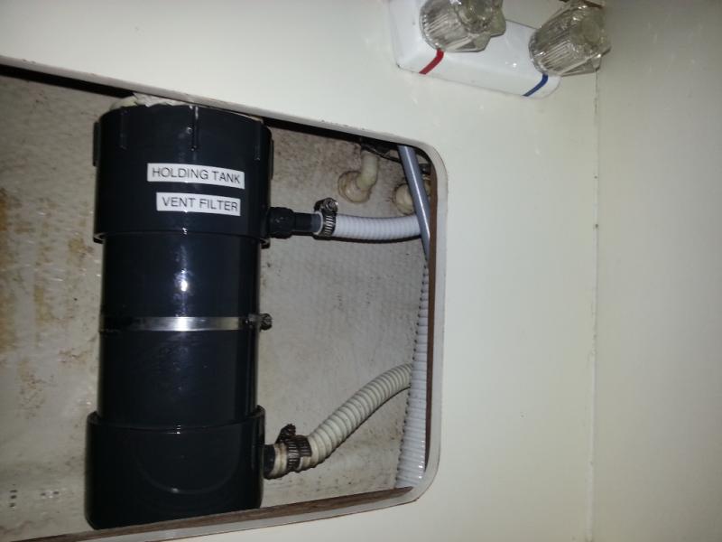

Made my own back in 2010.PVC from Lowes and charcoal from pet store. That was the end of downwind odor. So far still using original charcoal. Its 4 inch PVC so a lot of space in there
